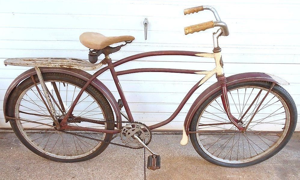

I wanted to do a project that was base on a Vintage Schwinn frame. I picked up this late 70s frame and fork. I had Clyde James Cycles in Haltom City, Texas fabricate and weld disc tabs front and rear. I added a Black Ops Stem, 7/8 motorcycle z bars, Origin 8 cranks with Mojo chainring, single speed WTB mountain wheelset with ACS freewheel, Shimano M395 hydraulic disc brakes, ODI Stromberg Signature grips, Brooks B67 saddle and Vee Rubber Twinz 2.1 tires. The powder coating is Prismatic Gold done by Ideal-Coatings in Garland, Texas. I am very pleased with how it turned out!

Cool project. A lot of people avoid disc conversions on older frames because the tubing isn't thick enough to support disc brake forces, but I'm sure those tubes are pleeenty thick 😂
Any plans on changing to some chunkier rubber? Those Vee slicks look like pavement only tires.

thanks... so far the disc setup has worked flawlessly... I had some Kenda K-Rads on at first but I really like the look of the Vee Rubber. I dont pound too much anymore except for pavement! Lol

Not to my tastes but that's a cool bike. Nicely done. I have noticed that the current disc brake bikes have very pronounced "lawyer lips" on the forks and dropouts. I've read that the high forces exerted from disc brakes can drive the axles down out of the frame so the QR skewers are held in place by ridges on the frame/fork or by thru axles.
May not be a worry with your horizontal DOs on the rear but you need to watch the set up on your fork. Keep the QR real tight and see if anything moves with use. Watch the rear too until you're sure.

That looks like a 1986 Heavy Duti, judging by the TIG welds and straight blade unicrown fork. Schwinn cruiser frames were electroforged and came with Ashtabula forged forks in the 1970s.
Still, you've made a very cool and unique bike. Enjoy.

thanks, the original head badge was like 2476 and starts with a T if I remember correctly, I never did get a confirmed year... the general consensus seemed to be 1976

Freaking cool build here; it's clear you put a lot of thought into it, from concept to parts selection. And the contrast between bars and frame works far better than I'd have expected. Street rod sensibility meets cycling enthusiast and the result is EPIC.
Very curious though: What's the story on the rear axle?
