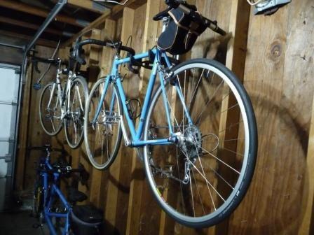

There it is hanging in honor on the garage wall with even some dirt from the day’s ride to wipe off with a cup of coffee tomorrow morning.

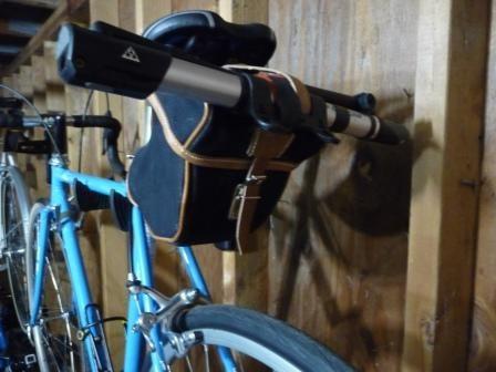

The final additions a Berthoud banana bag, and I was even able to fit a Topeak Road Morph G Mini Pump under its strap. It rides just fine and gives me a real pump to inflate a tube to 120 psi without causing cardiac arrest. Gotta love that.
Again, thanks to all for your encouragement and support, it has been a great journey, or, to paraphrase Rick from Casablanca, “erba, I think this is the beginning of a beautiful friendship.”

That's a really special bike.
I'd want to turn it around so I could see that Superbe Pro stuff on there.

Ah, but Golden Boy then it's not ready to head out the garage door. But I do agree, it does have a better side, but it always makes me smile.
Just behind the Stevenson Custom the bike that fits just me.
