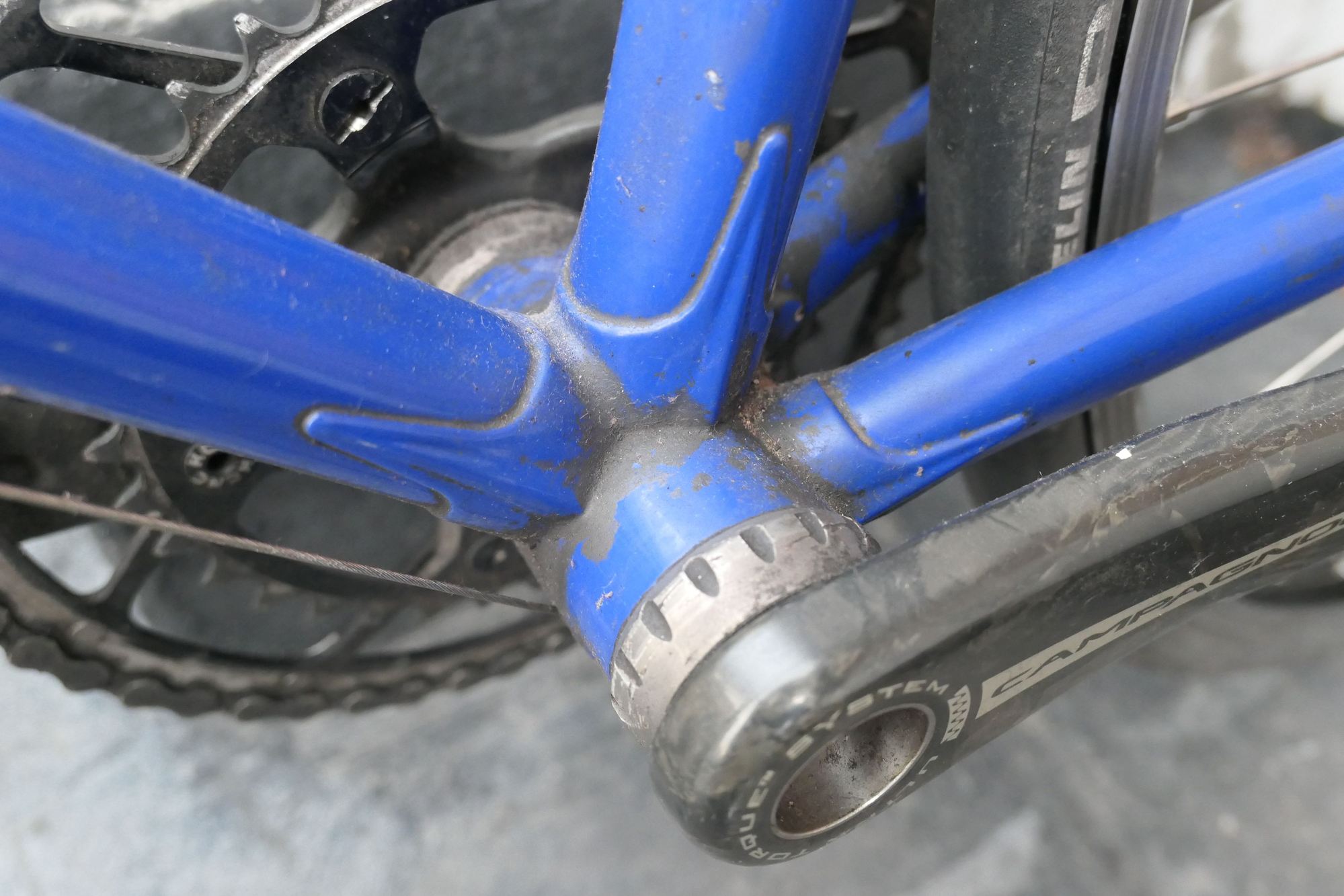

Next up my Simoncini. Got the frame and fork together off ebay, though the fork is not original. Columbus SLX frame, I decided to build this up with a mix or carbon/black and silver. Again 20 speed Campagnolo Ultra-shift, 53/39 and with the yellow Shamals this thing really flies. Love the colours on this too.
Its got 'sprint' etched into the bottom bracket so maybe has extra stiffness added there for sprinting maybe?
