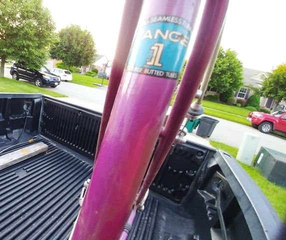

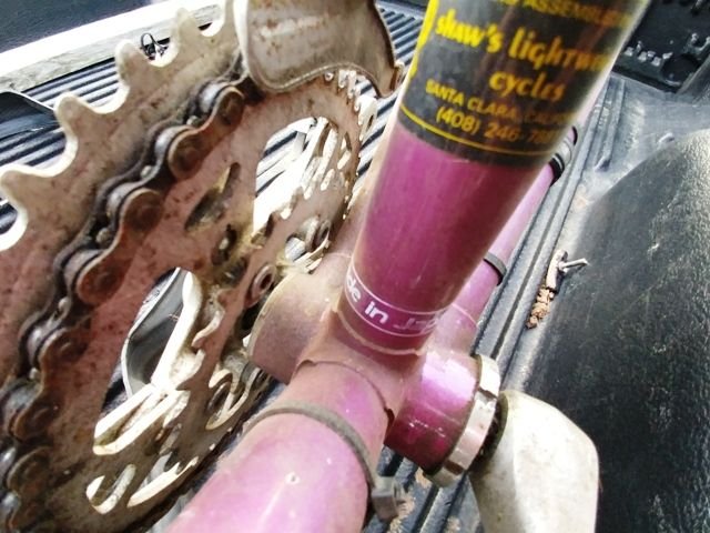

Anyway. I once thought all Terry bikes were 700c/24in but recently saw a 700/700 bike. That bike owner said it was a hand made frame (custom frame?) and since that was the extent of my Terry knowledge I assumed all Terry bikes were made in the USA by Terry, in her shop. Owner presented this one as a Classic 14 speed bike and while I believed that the Classic was a 14 speed I questioned if it was a real Terry. Having recently encountered an MKM faked to appear to be a Pogliaghi I was a little puck shy. This bike had Terry and Classic painted on it and yet the stickers said "Made in Japan", it had drop bars and the only online photos I had seen of the Classic model showed a flat bar bike (I know bars can be switched) but, when presented with the bike, I said, it's a nice bike but it's not a Terry - and got it for a reduced price. Since then I found reference to Terry having frames made in Japan at one point and even if it isn't a Terry it's still a nice bike.
Serial is S8B5689
Made in Japan sticker that confused me

Frame is tagged Tange 1 double butted tubes but forks are simply marked Tange.

Terry did have bicycles contract manufactured in Japan, reportedly by Tano, who also manufactured Centurion. The format is the same as used on the Tano manufactured Centurion, except that the prefix is an 'S', as opposed to an 'N'. I'm not aware that Tano had unique prefixes for each customer but it is possible. Regardless, it appears to be a 1988 model and I have no reason to believe it's not a legitimate Terry.
The fork has a generic Tange CrMo decal because their #1 though #5 tubesets all used the same fork blades.

S8B5689
So 8 for 88, B for 2nd fortnight of 1988 (3/4 week of January) 5689th bike made in those weeks?
W = a letter, purpose uncertain, possibly indicates a manufacturer or Centurion; X = a number, indicating the calendar year of manufacture; Y = a letter, indicating the fortnight of manufacture (A = wk 1 & 2, B = wk 3 & 4, etc.) ZZZZ = four digit number, probably indicating frame number during fortnight of manufacture.
