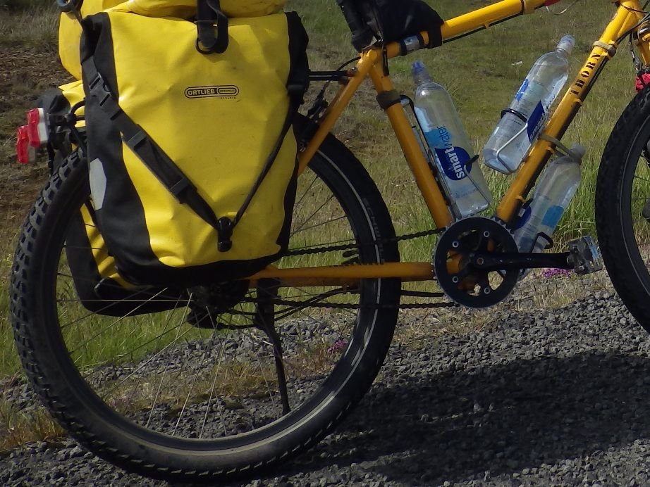

My Nomad is a 26 inch wheel bike. It has a Rohloff which has a range of 526 percent from low to high gear. It is easy to change entire gear ranges by swapping chainrings. I use two different chainrings on it.
For around home with the bike unladen, I put the bigger ring on it (44T), that gives me a range of 19.8 to 104.0 gear inches. This is great for pedaling on shallow downhills at a low effort and lower cadence, and the low gear is low enough to climb the hills near my home with nothing heavier than a pannier of groceries. Thus, this is a pretty good range for riding around home without a load.
But when I load it up with a big pile of camping gear, food for several days, etc., I use the 36T chainring which gives me a range of 16.2 to 85.1 gear inches. That is what I need for serious hill climbing with a heavy load. The lowest gear gives me a cadence of 72 at 3.5 mph which is the lowest speed that I can easily maintain vertical and directional stability. There have been some shallow downhills where I spun out and wished I had a higher gear. But, I would never want to give up the lowest gear for touring with a load. Thus, I am keeping this gearing for touring.
Bottom line, for me, your gearing would be great for touring but I would want something different for around town riding unladen.
In the photo I am using the 36T chainring, but have the 44T on the crankset in the outer position to serve the purpose of a bashguard.

I currently have a gearing that has a range of 711%...take that ya IGH yahoos! Here's a comparison of your gearing to my road gearing. You can see that your gears run out just over 20 mph at 90 rpm. Mine run out at a bit over 30 mph. Having a higher high gear has some benefits. On short downhills, I can get more speed up which carries me further up the inevitable uphill.
Here's a comparison to my off-road touring gearing. I still find the higher (but lower then the road bike) gearing to be useful. Riding on trails is different from off-road touring. While you might never run across pavement on single track, off-road touring can involve a fair amount of pavement. Having the higher gear comes in handy for the same reasons as it does for road touring.
On long downhills, I can pedal and keep my legs moving without feeling like I'm going to bounce off my saddle for longer. Colorado can have some epic downhills that last for 7 or 8 miles or more. Being able to spin your legs helps keep them a least a little fresh. Coasting for long periods can leave your legs feeling leaden when you have to start climbing again.
