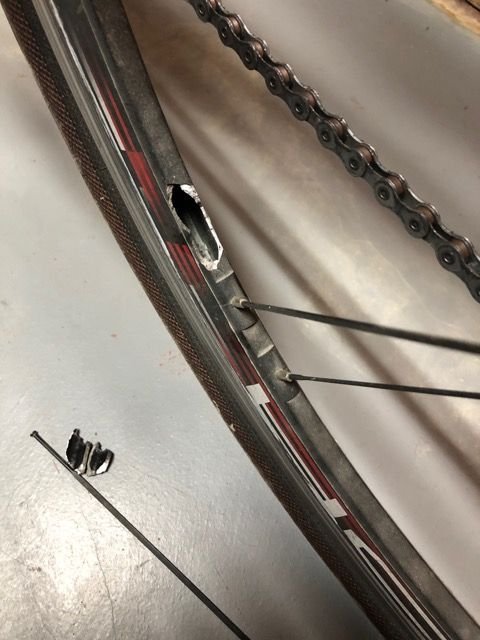

No. I've always ridden my bikes until I broke the frames. My current frame, an Alú bought from Nashbar 20+ years ago for $200, has >100K miles on it. I've replaced everything else but the handlebar, its stem, and the seat post - and the Blackburn, all inherited from the previous frame. (bent by an angry would-be thief)
So the result of today's ride (mostly paved road with a couple gravel stretches, one which was a seasonal use forest road):
That makes five rear wheels I've gone through on this bike in 24,000 miles. I should have put some wider tires on for today, but didn't realize just how rough the one road was until I was on it. I had 700x38 GP 4 Seasons at about 90 psi - that couldn't have helped. These wheels (Campy Zonda) have about 8-9 k miles on them I think.
