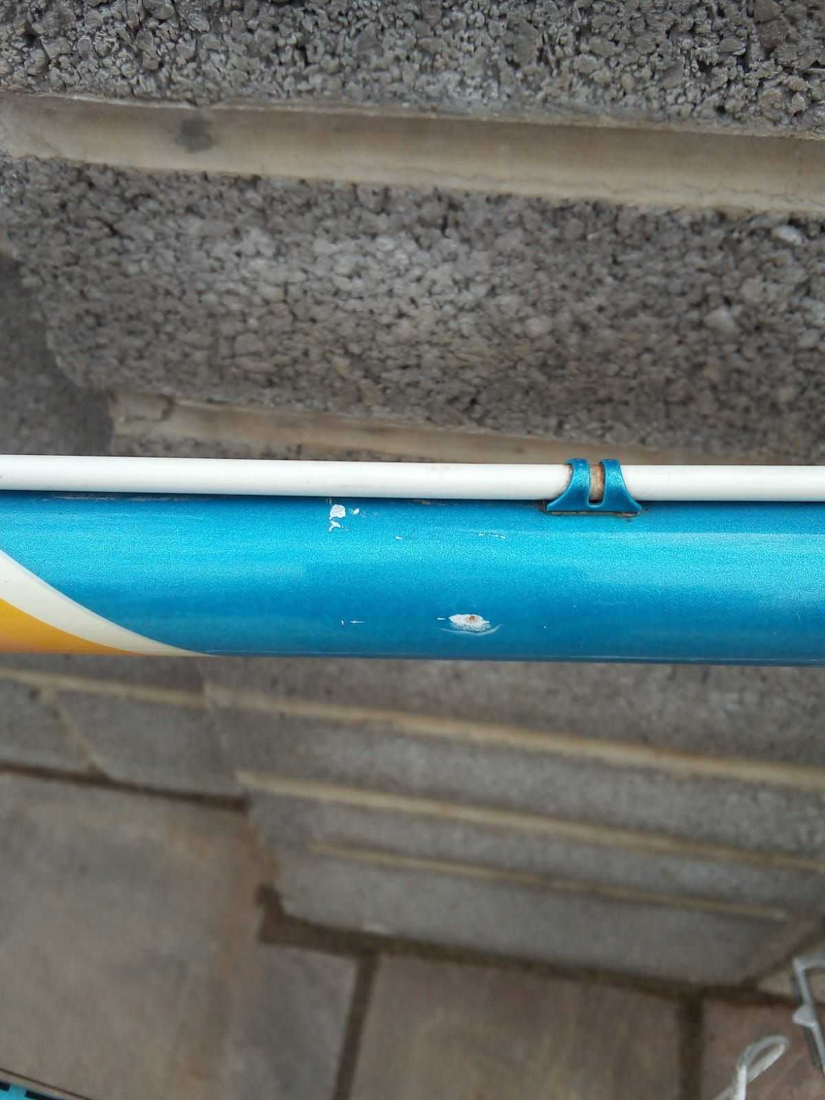

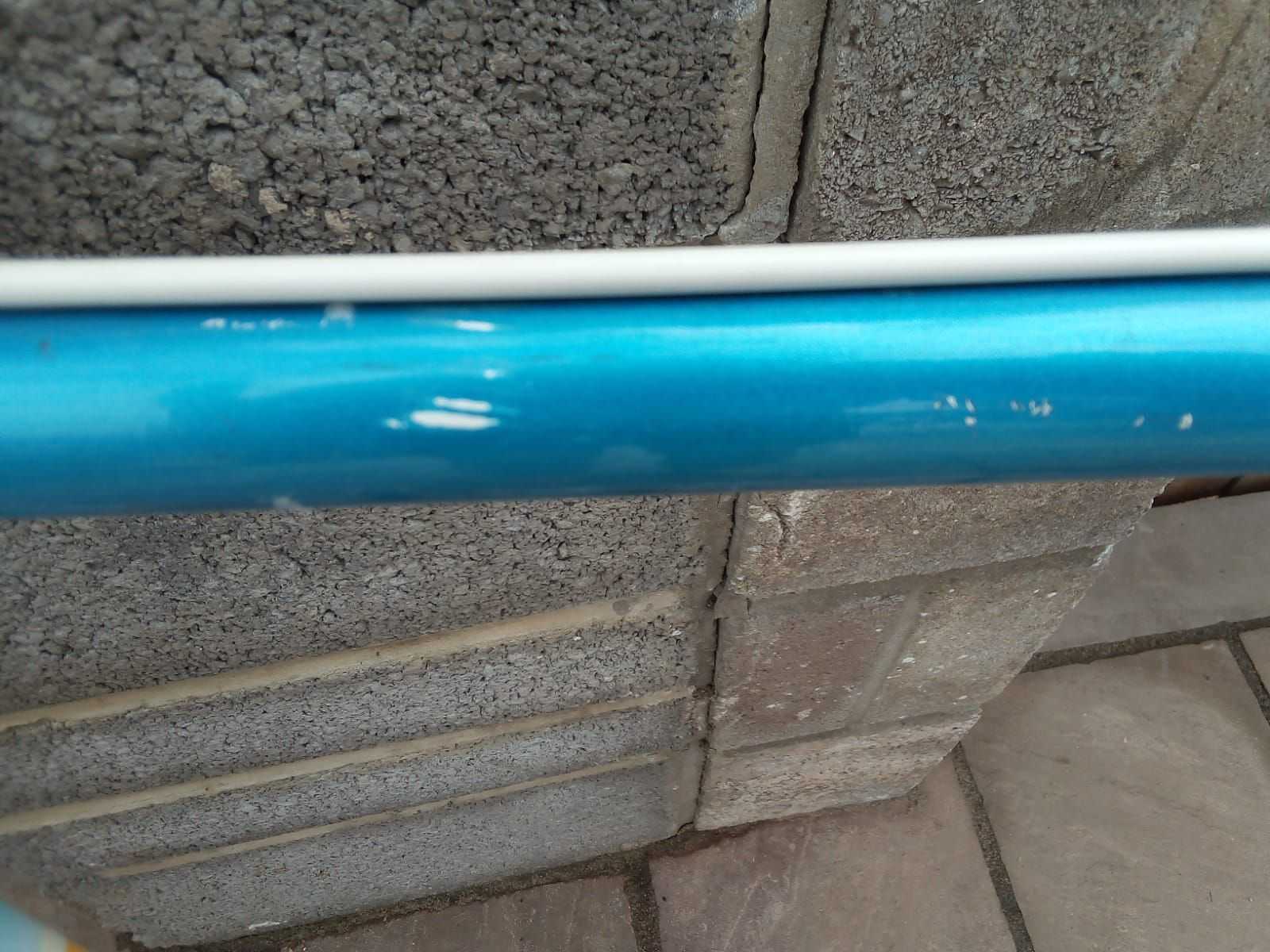

Howdy, I'd like to touch up these scratches but I can't afford to have the frame resprayed. Is there a way of finding the right colour paint to touch them up considering the age of the bike? Would it be better to try to find some paint which is similar or could I try to mix colours to get a match. Any advice welcome.

Nail polish comes in a bewildering assortment of colors and might be a good choice. Use a light touch and a fine-tipped brush so that you do not make the touched-up areas more obvious. Like in grade school, stay inside the lines!

I’ve used Testors model paint. Mixed colors to get a pretty close match.

That's an attractive paint job and has a long way to go before it needs a repaint. Touch up the scrapes that are through the paint, polish it and you'll be looking fine!
Word of advice from sad experience: once you mix TEST on an obscure part of the frame and let it dry. Particularly enamel paint dries a different color. I take an old paint bottle and both mix and cover so I can save my test mixes. And the worst thing you can do is mix just a smidgen to test and then, when you get the color right, have to guess at what the mix was. You're guaranteed to get the mix wrong, because that's the way the Universe works.

I've used nail polish before. It's not durable though,
However, I have a touch up kit for my car which consists of two bottles: one with the paint, and another with a clear coat. If I apply the clear coat over the nail polish, it holds up forever.

Testor's enamels in the small 7ml bottles are pretty good. However, I REALLY like Humbrol brand enamel paint in the tinlets.
I do not use acrylic paints for bicycle touchups.

I used some Testor's to touch up one of my bikes, and the mixing was really quite a challenge. I was trying to match a shade of yellow, and getting the right amount of green and red was so difficult that I settled for "close enough." Should have consulted an artist, but it was still a fun experience.
