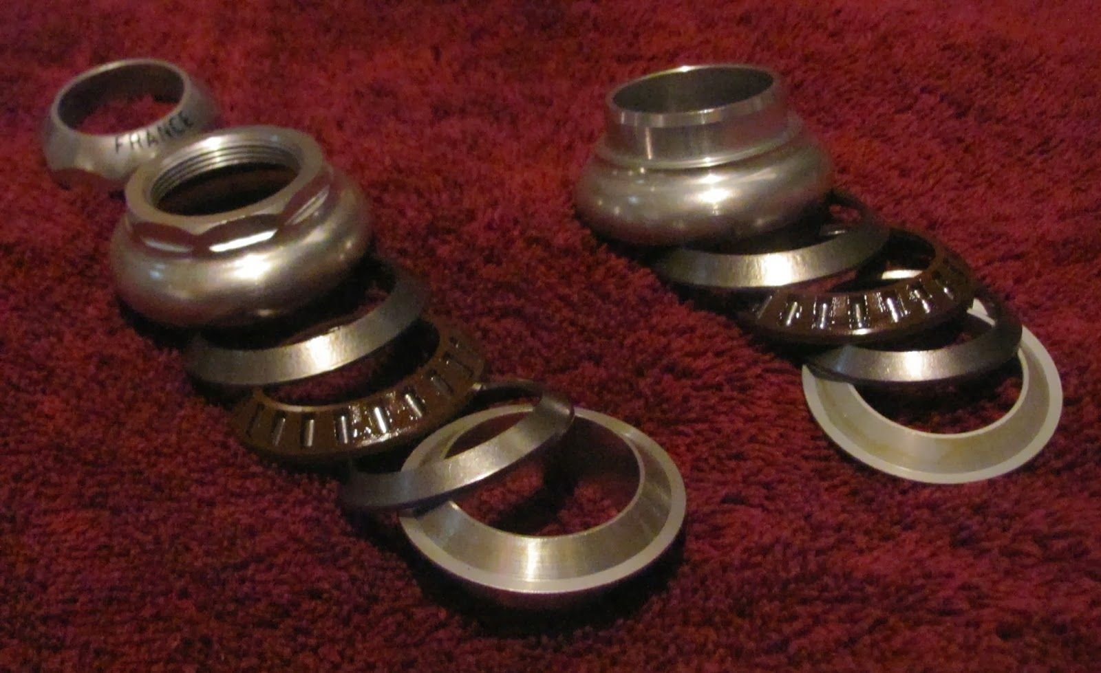

I've stripped down a 1985 Trek 720 that has what I believe to be its original Stronglight A9 roller bearing headset. The components look pretty good now that I've gotten rid of all the old hardened grease, so I'm inclined to just put it back together again. My question is about the four convex/concave rings and where the lubrication should go relative to them and also the bearing races. I'm assuming the rings are supposed to stay put in their cups and cones while moving over the bearings but I'm not sure. Two of the surfaces are black plastic and in good shape where the ring contacts them.
Would anyone recommend replacing this headset while I've got it disassembled? I'd need to have the pressed pieces removed and replaced by a mechanic if I got a new headset.

If the rollers and the races are in good condition why replace headset? Clean off all the old grease, lubricate with new fresh grease and put it back together. I expect a Google search will give you a parts diagram and assembly instructions.

I'm wondering now if I have a mixture of parts since the plastic parts are just the two cones - the one on top of the fork crown and one on top of the headtube. These look OK where they contact the rings but the one on the fork crown is superficially chipped outside that contact area.
Does lubrication go on both sides of the metal rings?

these are phenomenally durable headsets. the two metal "plates" function as cones. I do put some grease on both sides of them. then just clean the rollers and re-install.
parts are available but post a pic if you have questions.

Agree with Mark: grease the side touching the rollers like you would ball bearings. Enough to cover and lube. Cover the other side, and mating surfaces thinly to prevent water getting in and rust/corrosion forming. Quick question: are the "rollers" really cylindrical or are they slightly tapered?
Here's a pic from the retro-grouch site.

Trek sourced those headsets with the plastic and metal parts in those days - one came to me new on my 1984 610. Yours is probably original. If you keep it lubed it should last numerous more decades. I think it's called A10. Originally the locknut was (at least mine was) marked "Bernard Hinault."
I lube the rollers and the bearing ring faces that will face the bearing. I don't lube the other faces, but oil will seep into those interfaces, over the years. If you're going to toss it, PM me first, please!

Originally Posted by mpetry912 View Post
yes, that is probably the same stuff. Any molybdenum disulfide grease with an "EP" rating will be an excellent grease for headsets.
Now, don't bust my chops 'cuz I mis-spelled it. I got my tube of "Wurth" grease from Pelican Parts (german car parts) but yes, the Sta Lube product is probably the same stuff.
Tube is nice, it's super messy.
Mark Petry
Bainbridge Island, WA USA
Thanks for the info. Yes, moly is messy stuff, I have a bottle of the powder and it is more tenacious and messy than graphite, tough to get out of clothes.
