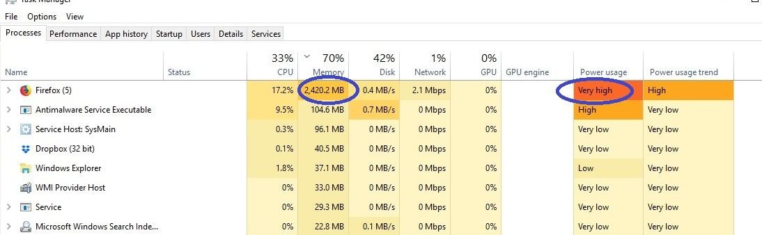

I did a Firefox experiment (Javascript is enabled). First I opened a single thread on here Bikeforums and just let it sit for about 5 minutes. Nothing else running on Firefox. Here is the Taskmanager Processes view. Note the REALLY high memory utilization (which would grow if I waited longer). CPU is high as well, but this is quite variable.
Then I closed and reopened Firefox and opened a different forum (golf related) in this case, letting Firefox just sit on a single thread like before for about 5 minutes.
There is the issue. I am not the only one with that issue, but MANY others do not experience it. Right now I normally run Chrome with Javascript DISABLED, and no longer have the problem.

And just for grins I repeated this while looking ONLY at this thread using Chrome. The first image is with Javascript DISABLED and the 2nd with Javascript ENABLED. dave

You do realize that in that listing Firefox is running FIVE instances, as Quantum is wont to do, at least in older versions. make sure that you are using the latest version you can and see if you can tweak the E10 settings. It may crash more often, the multiple instances are there for speed. You may find more than 5 instances running at one, even with one page open.
Firefox has always been a memory hog, long before Quantum. The low figure of 424 MB is actually quite good.
By the way, if you haven't already please update. FF is up to 66.0.2 and perhaps still a modified 66.0.1 in Linux Mint. I didn't check for sure, and there were several upgrades/updates when I upgraded to 19.2 "Tina". And if you are using Mint, please don't forget to run Timeshift regularly and save a snapshot for recovery should something go terribly wrong, so now you can recover without reinstalling. A few updates into the new Mint is one that will probably require rebooting as it replaces the kernal. Get through that and it's dandy!

I don't run Firefox with any regularity, but it seems to think that it is up to date and WELL past 66.x.x.
