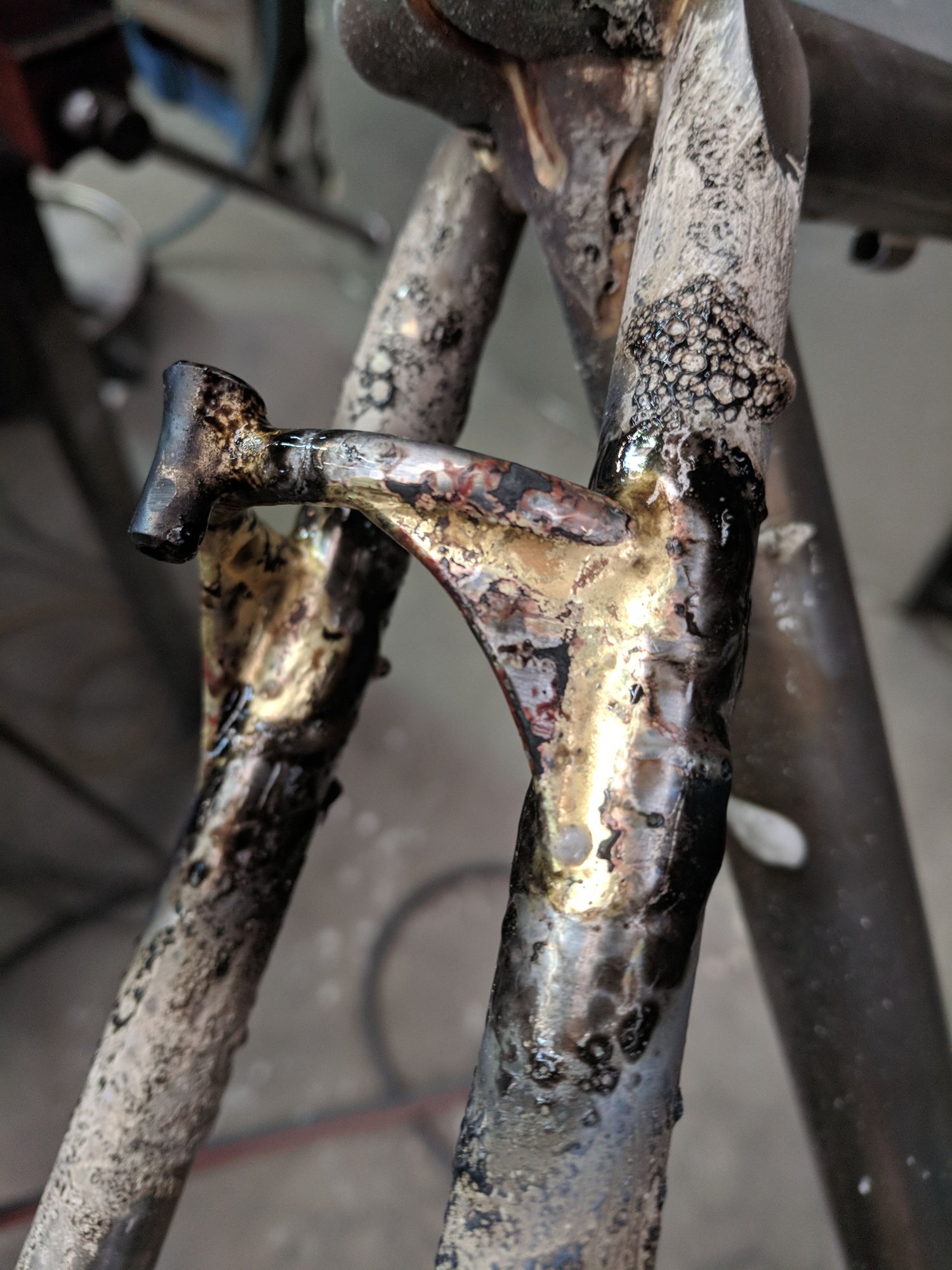

Bent up a seat stay bridge, and added a boss for fenders.
Nice beefy chainstay bridge brazed in. Also added a Fender boss here.
Here's the jig I made for holding the cantilever bosses in place while brazing.
Fork cantilever bosses all brazed up.
Decided to add some support fins on the rear cantilever cable stop.
All cleaned up.

That looks really great, thanks for posting pictures. Your headbadge is nice, understated but attractive. You might have gone a little overboard on the rear brake cable stop though.

Very nice! I like most all of the style and sizzle (although I still dislike straight blades) To Eric's comment about the rear brake cable stop- placing a small hole roughly in the gusset's center would reduce the visual mass. Andy

Yeah I can see what you mean about the gussets, but I like them as is. I thought about doing holes in them, but didn't want the added visual complication. The bike was actually finished almost a year ago, I've just been slack with updating this thread. Anyway point being, the gussets look a little less visually dominant with the frame built up with all the components.
