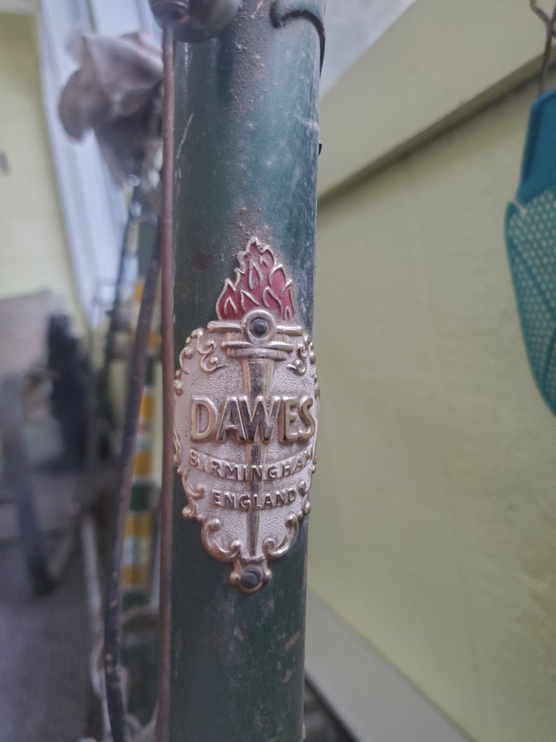

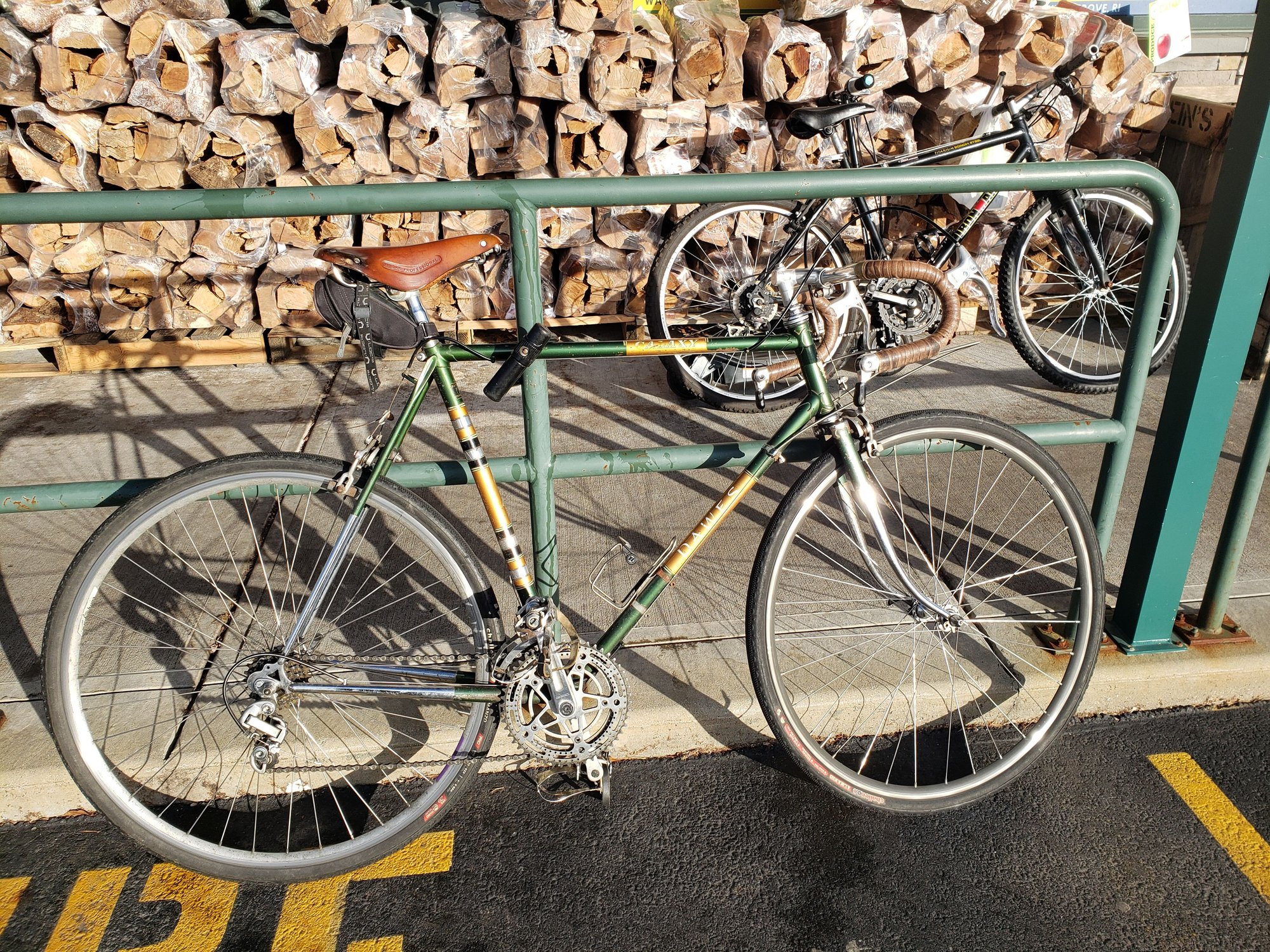

Needing a project, I picked up a Dawes from a man with a barn full of bikes. I chose it because of the badge, the chrome, & the seat. I've only refurbished 2 bikes before so I go slow & often am not sure of what I'm doing.
I cannot believe it but I took no full pics of it before I started taking it apart, though I've taken plenty since. I think the badge means a 70s bike, but there's nothing on it to identify the model. There's a serial # on the bottom bracket, but it sounds like that will not help.
So, any help identifying the model & boy do I have questions about the history of it.
Do all Dawes have these stuckers?
Love the badge.

There's not much information out there about Dawes. I have heard (with what reliability I know not) that the Dawes factory burned at one point, after which the company retired the "flaming torch" head badge seen on your bike. I have a Dawes Double Blue with that identical badge--and I agree, it is a classy touch. The saddle on my bike (which appears to be original) has a 1967 date stamp. Not sure how much longer that head badge remained in use.

Here's a picture of my Dawes Galaxy when I brought it home a few months ago. Same headbadge. Derailleurs are Simplex, headset and bottom bracket are TDC (TD Cross). There is a Dawes group on facebook (Dawes Heritage). They are mostly from the UK I think.
Maybe you can post a few more pics.
Are the handlebars engraved?

All models were declared differently. Somewhere in the early- mid 70’s would be a good guess for your bike. The badge is cool! I have one of the yellow Dawes Galaxy models but came only as a frame. Plain 531 but light, lively.

Here's the 1969 review of the Dawes Galaxy, which is what this one is - plain gauge 531 main frame with probably Tru-wel or comparable hi-tensile steel stays and forks. It's comparable to the Raleigh Super Course of the time and was similarly equipped. That badge was in use starting in the mid to late '50s, and I had one on my c.1962 Realmrider 4-speed, and it lasted into the 70s, when Dawes switched to a smaller badge that looks a lot like the escutcheon on the seat tube.
It is very much a British touring bike from the era before everyone felt they needed a bike suitable for riding from the Arctic Circle to Cape Horn, with a zillion braze-ons and massive cargo capacity. It's great with a saddlebag/handlebar bag combo, you could fit a rack and panniers and go cycle-camping, but it's not the rough tough enduro macho thing modern touring and cycle camping bikes have become. If you want to do day trips it will be lovely, you could go camping for a while with it, to be honest lots of people crossed the country on similar bikes in the '70s.

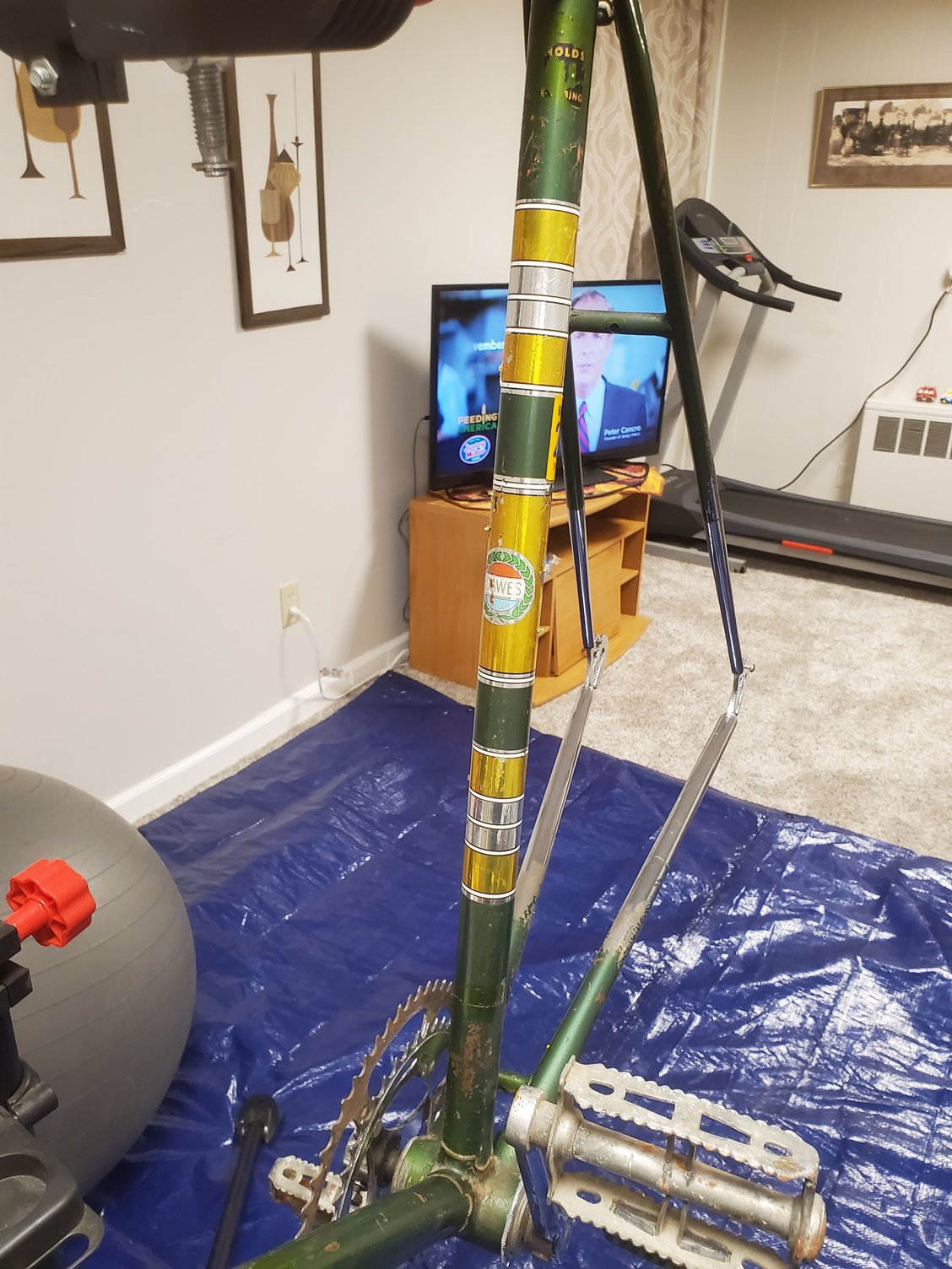

If the RD is original Simplex Prestige unit, it's date stamp will be helpful. The panel graphics vary from year to year so would be nice to have a shot including 3 main tubes. Is there anything stamped on dropout?

Answering Indidious: RD is Simplex Prestige but no date that i can see. Left dropout has a 5 stamped in it. The only graphics are on the seat tube. No Dawes logo or model on the others.
Seat tube
Think this partial was the 501 graphic.

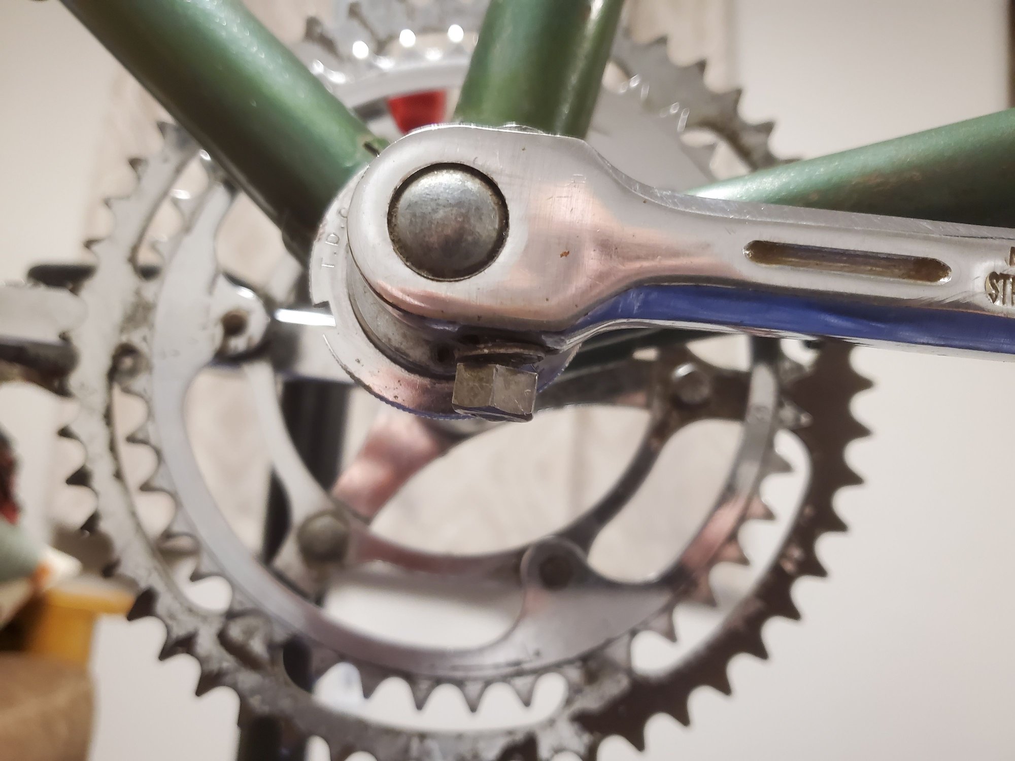

First ques
If I take off this nut, does the bolt come out, & then the crank arm will come off?
Bolt thru crank arm
Stronglight - anothr of the bolt.

That's a cotter pin, and they should be pressed out. Some use a hammer to knock them out, but the risk of damaging the pin and making removal a lot harder is significant. Best thing to do is spray it with some PB Blaster or similar penetrant and let it sit for a day or so. Once the pin is removed the crank arm should slide right off. Here is a press in action:
If you get the cotters out without damaging, and if they are in good shape, then reuse them. A press is best for reinstallation. That Dawes looks like a great winter project. Best of luck with it.

You tap on the end with the threads and the cotter pin pops out the other end. Then the crank comes off. You probably don't want to deform the cotter pin though, if you want to use it again. They could be very tight on there. Maybe search for cottered crank removal for tips.

It is best to use a press to remove and replace the cotters. I broke down and bought a park tool cotter press on eBay about a year ago. English bikes are my hobby.
