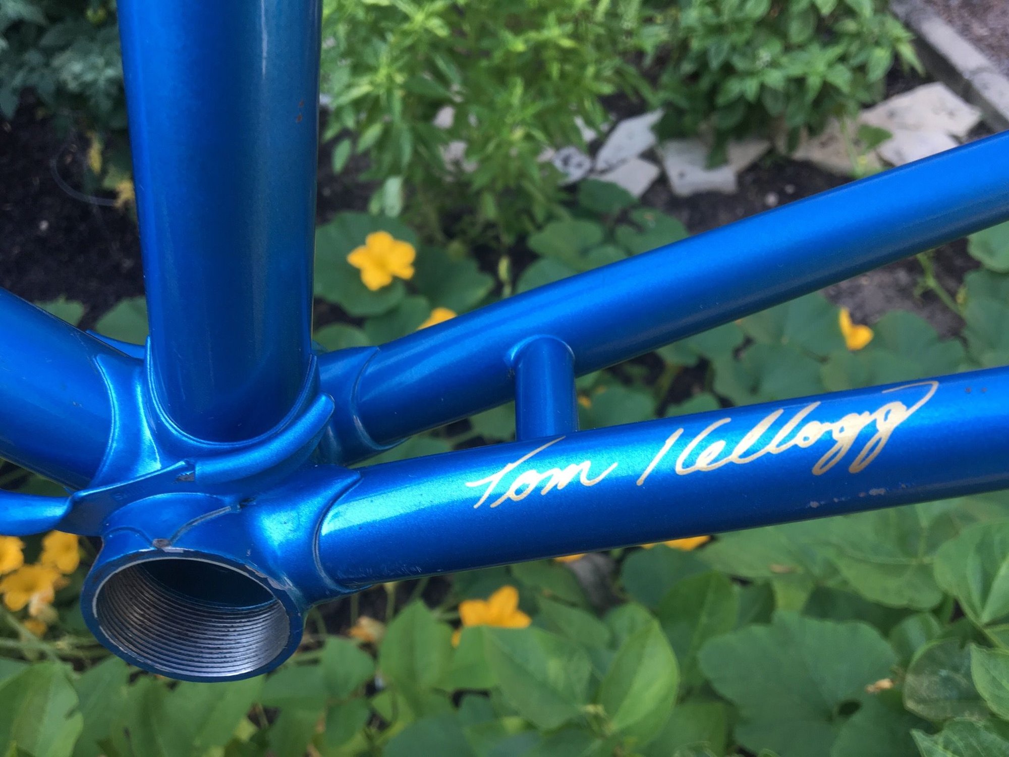

I may have stumbled across something special. This Ross f/f has a 45cm long chain stay so I’m guessing it’s a sport/touring model. Bottom of BB is stamped 200 2312 so this must be model 200 in size 23”. Like seen on the other Ross signature model 294s..... as in 294-1925, 294-2125, 294-2325, 294-2525
It’s not mint but I’d rate it 9/10 condition. No dings or dents but it does has some scratches. It only has one Reynolds 531 decal on ST that reads butted tubes forks & stays. Has a 27.2 seat tube.

FYI, the '12' in the model designation is the colour code - Peacock Blue.The Road Criterium and Track models were red and white respectively with Columbus tubing, while the Touring mode was blue with Reynolds 531, so everything points towards the Touring model. It's hard to provide an assessment based on a single detail picture.
Serial number
sorry for the slow upload. Some of these pictures were taking a while to upload.
Here is the serial with braze on date.
T-mar, thanks for explaining that color code. This color Blue is a nice color. I read somewhere he used DuPont Imron paint.
Very nice frame but I disagree with your 9/10 assessment based upon the issues shown in the photos. I have seen these bikes complete listed on Craigslist with asking prices around $500.00. That is with Campagnolo components. They seem to take awhile to sell and probably don't get full price but that is simply a guess based upon the length of time listed.

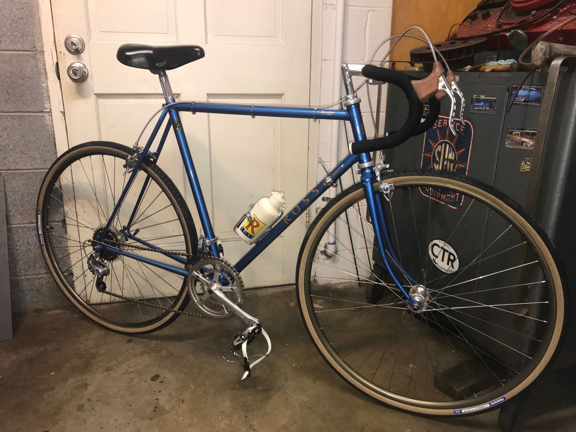

I wanted to give an update about this Kellogg Ross.
It was posted for sale in the classifieds here about 5 months after this thread was posted. I wound up buying it. I spent a lot of time researching it, buying oe spec parts for it (where possible), and decided to go a slightly different route on a few of the components. While it is not how I initially envisioned the end result, I figured it was time to get it back together and ridable again with what I had, knowing I can make changes in the future. I'm going to start a separate thread about it another time.
Today I finished the initial assembly, and it's ready for some minor tweaks and a test ride.

Very nice. When I was a kid, I think someone who lived near me had one of these, and I could tell his bike was way nicer than mine. Now I know why!

That's an absolute top tier American frame. What is that build? Double points for the water bottle. Those must be insanely hard to get.

I'm going to start a thread about this bike, and some other Ross Signature stuff, in the 'regular' C&V forum soon.
The Ross water bottle came from a forum member, and I am very thankful they were willing to sell it.
Likes For hazetguy:
This is one that I was happy to be wrong about. It is a much nicer frame than I first imagined. Good luck with your rebuild. I'm sure it will be an excellent ride.
