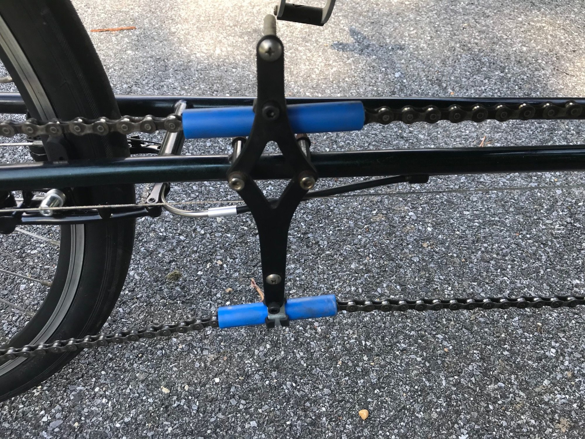

Two yucky occurrences today: 1. Someone didn't clean up after their pet No further explanation necessary. 2. The front idler broke. So, the first upgrade will be T-cycle idlers, front and rear.

Here's a $5 hack that will let you ride until you receive your new idlers from Terracycle:
It's worked well for me so far and it's not too noisy.
My wife's VRex and my Stratus have voracious appetites for the stock idler wheel from Rans. I'm going to eventually upgrade to the Terracycle kits but to do both bikes, it will set me back a little north of $300.
I'm still waiting on the idlers. Probably I should tell them to go ahead and send the one I think they have and send the other when the parts that are out of stock arrive. This idea with the tubing....will it work on the front idler, that's the one that broke. Thanks!
It should work just fine. I used PEX tubing because it feels a little softer than PVC. I think that is also why it isn't too noisy.
Are you trying to order the idlers from TerraCycle? Reason I ask is I decided to bite the bullet and order the Terracycle idlers for my Stratus and my wife's VRex (front and rear). I ordered them from Rans and they had everything in stock. Your Rocket uses the same idlers as our VRex. Rans pricing for the idlers is identical to Terracycle but shipping costs may differ.
