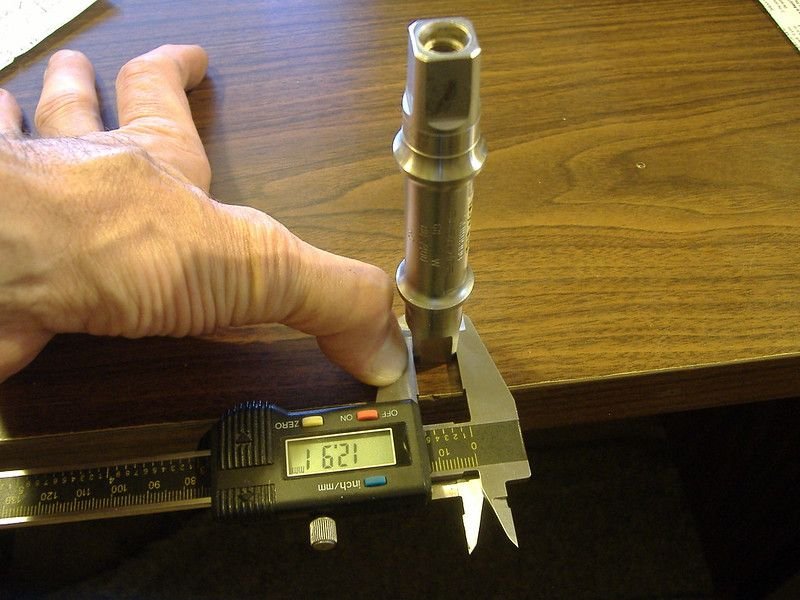

For those with a caliper, comparisons between different tapers can be made as shown (JIS Dura Ace 7400 spindle shown).
Also, by locking the caliper jaws at say 13mm, one can measure how far up the taper that two different spindle tapers allow the caliper jaws to slide up the taper.
For numerically accurate (versus comparative) measurements, be sure to check/calibrate the caliper's measurement using a new ball bearing. Simply zeroing a cheap or worn caliper may result in undersized measurements.

Here are some data points taken with a Mitutoyo dial caliper (analog) with no particular calibration history (good enough for cycling):
I found these on an old paper, can't remember when I started down this rabbit hole; within the last couple years I think. I didn't bother to go to two decimal digits, obviously. Maybe I'll continue and finish this one day.
