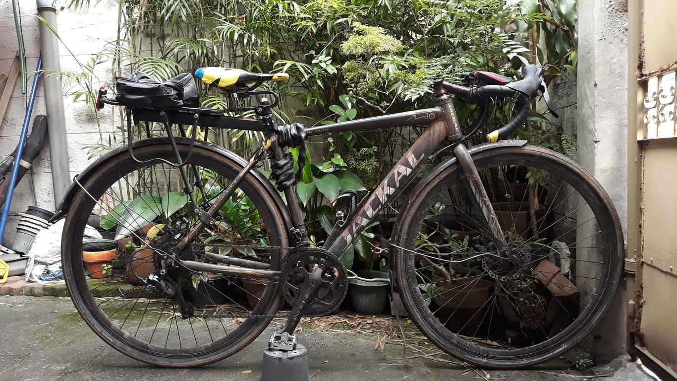

I have 35mm wide road tires. Wheels are alloy with 36 spokes front and rear. Inflated to little bit higher pressure than is recommended for my weight (124 lbs) 50 psi rear / 45 psi front (Recommended is 45 / 39 psi)
As my sprinting cadence reaches 110 to 120 rpm, pedal strokes start feeling springy. My tires don't bounce, bike is stable but I literally feel like I'm jogging over springy mattress like a 5 year old. I feel it most strongly at the bottom of the stroke.
Tires? Pressure? Frame flex? Crank flex? Crank and frame is alloy. Bike is locked down tight every nut and bolt and smooth, no unsual noise during sprinting, just the soft hum and buzzing of the drivetrain.
I don't experience nor perceive this springy feeling when climbing out of the saddle at lower cadences.

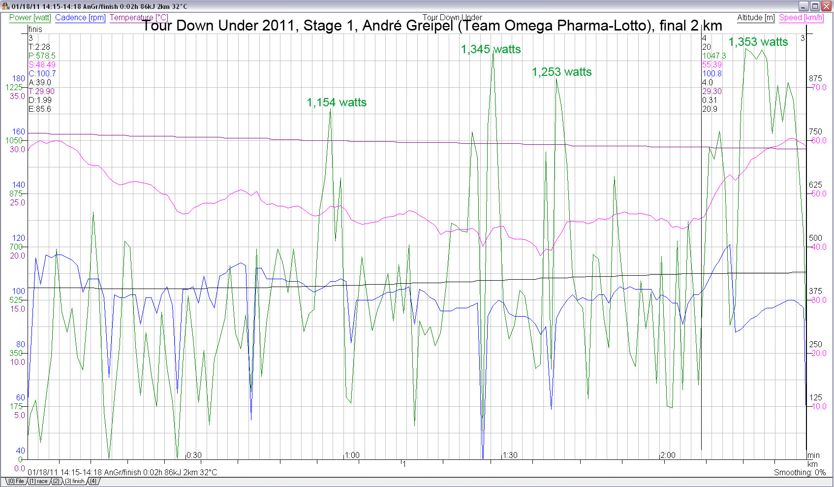

Originally Posted by waters60 View Post
Watching countless road race sprint finishes I can’t recall ever seeing someone standing and spinning maniacally at 120 rpm. BMX riders don’t have the option of changing gears!
Here you go. Sprinters don't very often share their power data but this is Andre Greipel from 10 yrs ago. Might be a little hard to read but the blue line is cadence and you can see he starts his sprint at a cadence of 100.8 and shifts at 120RPM

Tires could have something to do with it. Pressure gauges are unreliable. Most will give the same reading today as yesterday, but being 5 or 10 psi off is ordinary. So experiment with both higher and lower pressure. Recommended pressures are just a guess at a starting point. Speed and sprinting load the tires differently than ordinary riding. If the whole bike is $250 the tires are probably basic. Basic tires won’t sprint that well.
Doing the speeds you are reporting with no pedal retention and a basic bike sounds difficult. Also sounds like really good training.
Yeah, it maybe the tires. I have since upgraded the stock tires to Panaracer Ribmos which costed me less than $60 including new butyl tubes.
The tires I bought are "tall profile tires" 35mm wide which I think is meant to better absorb road bumps. It's a long-wearing, low 27 TPI, urban / tour tires with anti-puncture protection. It actually is "springy" by itself at the recommended pressures for my weight + bike with significant lateral flexing if I try to push the bike sideways.
Unfortunately perhaps, I'm probably restricted to these tires as these tires proved to be quite durable and long lasting in our poor quality roads. Quite affordable for me too.

Yes, the tire is much more flexible and even worse since I have a tall profile 35mm wide tires installed (it's taller than wider).
I've been testing how flexible the entire bike setup by holding the bike upright with my hands and pushing the BB away from me with my feet. It didn't took much effort to visibly flex the frame and the tires flexed laterally even more. I can definitely feel it even when simply attacking out of the saddle. It's disconcerting to say the least.
I suppose it's simply the fact, a Walmart quality cheap bike isn't going to cut it. Or I'm just too sensitive to these things.

I'm fully prepared to be mercilessly roasted over this. But the point is that 150ish RPM out of the saddle (for a VERY short burst) is possible. I never sustain anything close to this, obviously.
There was one sprint finish I saw the top sprinters in TdF sprinting at the same cadence!
It's fairly achievable to anyone training for it unless you have physical issues preventing you from doing so. It's very rare that any cyclist would just train for it and because it's actually difficult to be even decent at it!
cubewheels is offline

Originally Posted by Moisture View Post
For reference here is a picture of the monstrosity in question:
Trivial question- can anyone point out why this rider spends "long times out of the saddle" on this bike? I think I can?
I feel like I have to follow up so that people can see what they are dealing with, before wasting time commenting on this thread. Now, all that's left is to see this dude riding this contraption.
My seat is actually too high in that older picture. I'm a "heel dropper" which requires a lower seat to have correct knee angle at max leg extension.
Below is my present setup with the corrected seat height. I also needed a large seat setback to further unload my arms to help improve comfort in our poorly maintained, very bumpy roads.

Not sure if you're giving advice to sprint out of the saddle without swaying the bike or just sprint in the saddle. And those few who can actually do a good sprint in the saddle does it at even much higher cadences (~200 rpm!!), not less than 120 rpm!!
Very strange, all advice I read in the internet from the pros, scientific studies is telling the opposite of what you're saying here.
most track sprinters are shooting for about 140rpm. What has been found is that higher cadence, which usually requires a smaller gear, doesn’t actually produce more watts. 140 rpm is kind of the sweet spot.
