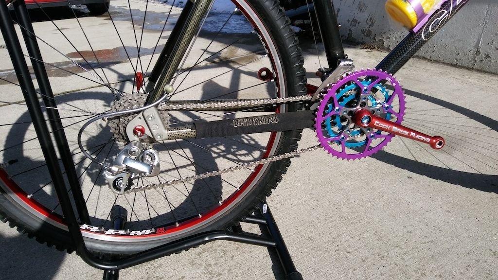

'02 nrs
royaloaker
'02 nrs's Avatar
Location: se MIch.
Posts: 409
Bikes: 1938 claud butler,1983 Basso,teledyne titan,teocali super,nrs,1993 stumpjumper fsr,Paramountain,Paramount Buell,4 banger,Zaskar LE,Colnago Master Ibex MTB,1987ish,.etc....
Quoted: 141 Post(s)
Liked 165 Times in 96 Posts
trust your insticts/
CFM2
'02 nrs is offline
Old 01-18-21, 11:56 PM
Russ Roth
Posts: 1,402
Quoted: 511 Post(s)
Liked 359 Times in 279 Posts
Originally Posted by '02 nrs View Post
CFM2
Almost over done but still retro cool looking, especially the cook brothers. Sweet ride.
