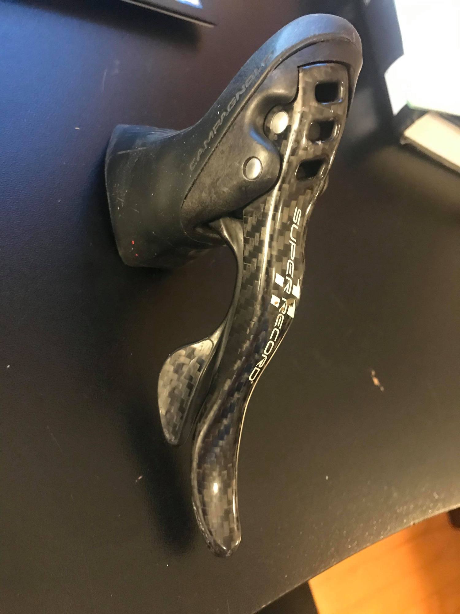

Hi guys, I usually post more in the CV section since out of the five bikes I own the most recent one is a 2006. I got into cycling by fixing old bikes and actually never really had the chance to work with the more modern stuff. Actually I've worked on the never Shimano groupsets, but never on the recent campy stuff.
Now I just bought 11sp Super Record shifters and derailleurs because the price seemed good and I felt like learning some more stuff. From what I can tell it's the 2010 version of the groupset but maybe someone can clarify this.
I have a few questions on the levers themselves but I think the easiest way to get an answer for me will be to visit my LBS. There's a small side-play the the small lever for instance, and the brake blade seems to get stuck sometimes when I push it down, but since I have no experience with these components it's hard for me to tell if this is actual wear or if this will all fall in place once the shifters are properly installed with cables.
I'd like to know, however, if you guys thought it would be a crime to complete the groupset with less high-end campy components, and what would be your recommendations in this regard. Chorus? Would Veloce be sacrilegious? I know campy stuff is rarely cheap but I'd like to avoid to break the bank. As of now I'm thinking about using the components for a neo-retro build. I have a nice Rossin aero frame that I'd like to turn into a racer. This means I don't necessarily need perfect coherence in the build, but I'd like everything to work well in the end. I'll get to learn in the process and that's the most important part for me.

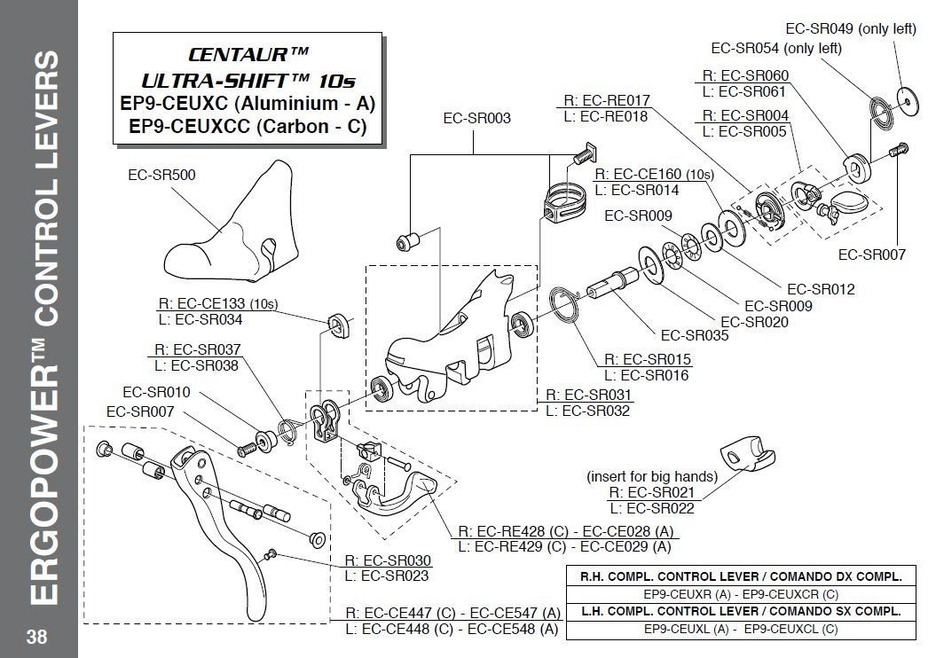

They're not because actuation ratios changed in 2015.
You'll need to find 2009-2014 derailleurs.

Unfortunately Ultrashift small parts were discontinued in 2009 - the same year the shifters were introduced.
You can buy replacement shift units for ~$80 including everything except brake blade, hood, and mounting hardware.

Presuming you’ve done a physical inspection under the hoods and all looks good, I would suggest installing them and checking function before writing them off. Uninstalled, you can hyperarticulate the brake lever, pulling it past where it’d normally stop or past where it would hit the bar, and yeah, there is a notchy or clunky point in there which you never hit when installed. Some play (towards the inside) in the smaller lever before actuating the shift is normal, at least on Chorus and Athena 11spd groups, which I have.

Plenty of sources out there still and even folks who do it for a service.
Please name one where I can buy an EC-SR037. Having spare EC-SR015 springs on hand would also be good.
Unfortunately, Campagnolo stopped selling Ultrashift parts separately in 2009, the first year of production.
Peter Chisholm used to split levers into pieces for separate sale but has since retired.
I've been able to easily get parts for even the old early 90's 8 speed stuff with no issues.
I got rid of my 1997 levers when I couldn't buy a ratchet pawl return spring or complete assembly because those the small parts had been discontinued except for the G-springs and left lever carrier which were used by the 1998-2008 levers.
Those parts are still available.
Of course a proper cleaning and servicing of parts usually takes care of most issues.
It does nothing for the springs which break due to fatigue. I wore out my first Ultrashift lever in just 24,000 miles.
Original 2009 parts catalog:
Second 2009 catalog. The same edit was made for Veloce/Athena/Chorus/Record/Super Record levers. The EC-CE110/EC-RE311 sub assemblies were discontinued later.
