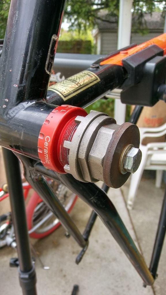

What it seems to me, as someone who has not used a proper press tool but has jimmied a headset cup press from threaded rod and washers, is that the big deal is ease of use. Like rubiksoval mentioned, the act of pressing bearings/cups in is pretty basic and can be accomplished in basic ways, but it can also be a lot easier having the right tool for the job, and a lot quicker if the right tool is also easy to use.
There are those combo press/extractor types with lots of removable bits; those seem fiddly to me. I like the Wheels Mfg press only unit because it has the two stepped adapters on each side which should provide good, secure fitting to the most common cup/bearing sizes. Certainly that the adapters are fixed trades off some versatility, like perhaps it’s not perfectly fitted for the newest, latest standard (e.g. SRAM Dub; dunno), but I’m thinking that if it works for what you’ve got, it’ll work well.
For the same reason to avoid the complicated, fiddly combo units, I’ll probably go with a Park bearing extractor for $35 or whatever, because it seems easy to use and a good match for the BB types I have (Campagnolo Power Torque excepted; what a PITA that pressed-on-the-crank-arm bearing is!).
If you’re looking after a wide variety of BBs, it may make sense to bite the bullet and go for a big, versatile press/puller set which will work on everything, but on the other hand, it rarely seems to pour when it rains when it comes to BB servicing, and across my dozen bikes at my riding mileage, I only need to do 1 of them every couple of years or so (again, that f’in’ PowerTorque seems to come up more often than others!), so I don’t feel there’s any urgency to covering all the bases at once, and rather responding to needs for new tools as they arise.

I’m in pretty much the same boat right now, and looking at the Wheels Mfg press for the same reasons.
Whenever I go cheap I often regret it. And you’re right. The Wheels mfg. looks so simple and easy to use. I’ll very likely go with that and the Park extractor.
Though...just saw this YouTube guy and he likes (mostly) this press extractor combo with no hammering and it’s one of the cheaper Chinese ones. Except he had some issues with some odd size BB.
I think I’ll stick with the Park/Wheels combo —no hammer does sound nice and safe though.
