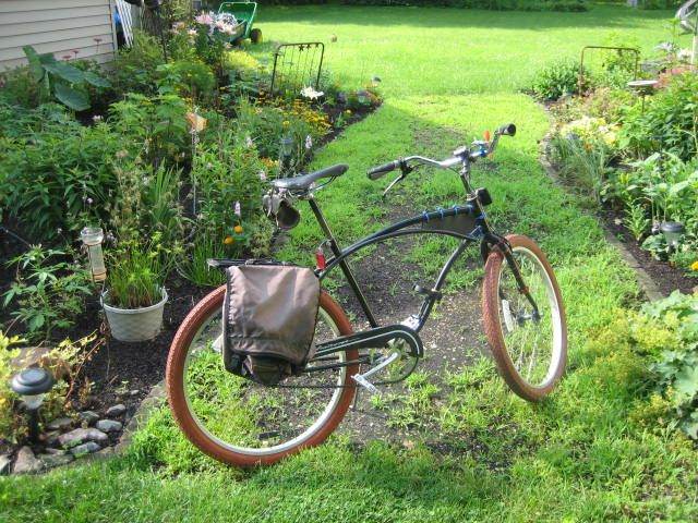

Found a picture of my Huffy. Good Vibrations frame form the 1980s. Rear wheel is a Bendix yellow band 2 speed and front is based on sealed bearing BMX hub. Both use Weiman rims. Nice riding dependable bike. Roger

Nice looking Huffy . Mine is a Good Vibrations too .
