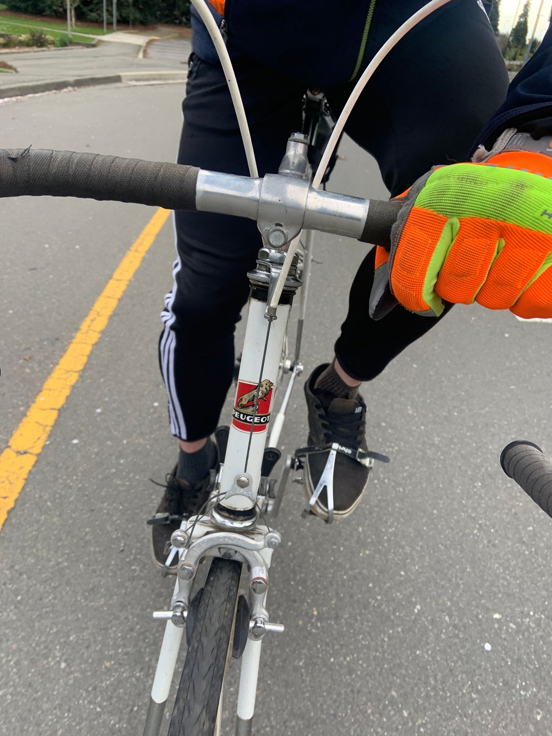

Maybe not quite what you call vintage, somebody suggested from the 90s, but this bike, mentioned in a couple of other posts, has really good rim brakes. If you pull the brake levers hard, you can lock up the wheels.
