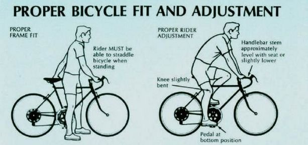

The next thing is fit. Ideally the most important measurement is "Stand Over Height" - how high is the top tube from that ground and how much clearance is there between the top tube and your "personal area".
You should have at least 1" of clearance when you straddling the bike in case you have to quickly dismount.
This was Schwinn's beginner fitting guide:
Once you determine the size frame you need then you can start looking for a bike. You can safely/comfortably ride a bike up to 1" or so smaller than optimal but then other things come into play.

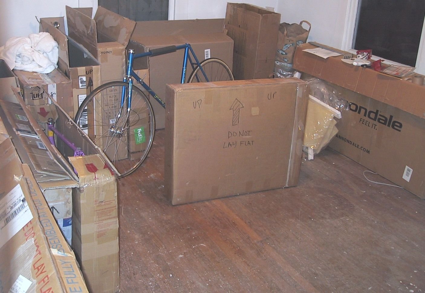

N=70+ ??? All road bikes except 1. I've been good this year, I only got one new bike.
The Bat Cave 1
Bat Cave 2
Gitane Alley
Ladies in waiting

Rather than look for a specific bike, learn to recognize the frame/fork characteristics that make a bike a good quality, or higher end, one. Look through Vintage Bicycle Quality, learn what to look for, then apply what you learned by starting a search. Looking through How to Find Vintage Bicycles and you should be on your way.
By the way, I have found, for very little cash spent, literally hundreds of vintage road bicycles and roadsters. Finding is not the problem, if you do things right. Getting too many too fast is a problem and it seems to strike frequently...
