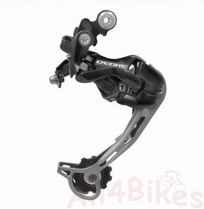

SuperGimp
I put this one on my wife's tiagra triple to get more take-up capacity:
Shimano Deore 9-Speed Mountain Bicycle Rear Derailleur - RD-M591
works great. Make sure you get the one with the shift cable barrel adjuster, the newer ones lack that feature.
Any 9 speed Shimano derailleur should work with any Shimano 9 speed shifter (also any 6-8 speed shifters except Dura Ace) and all 10 speed road shifters (except Tiagra 4700). See here: https://bike.bikegremlin.com/1278/bi...compatibility/

I just want to make clear lest anyone reading this thread comes away with the wrong idea.....
Whether or not a derailleur is “Shadow” is completely irrelevant in terms of compatibility.
If you logic model or decision flow chart for determining compatibility involves “Shadow”, then it is flawed and you need to start over.
Here is a good article from BikeRadar regarding mixing and matching. Nowhere is Shadow mentioned as being relevant:
https://www.bikeradar.com/advice/buy...r-derailleurs/
Cycleway town
Because it is SHIMANO MTB 10 SPEED!
It has NOTHING to do with the fact that it is Shadow. Shimano just happened to go with Shadow on all their MTB stuff when they went to 10 speed.
Your RD will work with ANY Shimano 10 speed MTB shifter.
Likewise, 9 speed shadow and non-shadow RDs are completely interchangeable.
The problem isn't the shifter (of course a 10sp shifter will only work with a 10sp cassette).
The problem is the rear derailleur has s different swing ratio.

I am not sure about 6 sp, but as far as 7 sp and above (in Shimano).... ANY 7-8-9 sp MTB or 7-8-9-10 sp Road shifter will shift ANY 7-8-9 sp MTB or 7-8-9-10 speed Road rear derailleur. At least for anything made by Shimano in the past 25 years. This includes Shadow Derailleurs, which can be found in 9 speed. This is because Shadow has NOTHING to do with cable pull ratio.
But none of this has anything to do with "Shadow". Nothing. Nada. Zip. It is a red herring that is just confusing you. Forget about Shadow, it is utterly irrelevant.

Look here:
The following derailleurs are ALL Shadow design, NONE of them has a clutch, and ALL will work with ALL Shimano 7,8,9 speed MTB and 7,8,9,10 speed road shifters (except Tiagra 4700).
NONE of them will work with 10 sp and higher MTB or 11sp and higher road shifters.
(Although, to make things a bit more complicated, XT, SLX and Deore have 10 speed versions that look identical (the last number in their model code is 3 instead of 2), but will work only with 10 speed MTB shifters.)
RD-M972, introduced in 2007.
RD-M772, introduced in 2007.
RD-M662, introduced in 2008.
RD-M592, introduced in 2010.
RD-M4000, introduced in 2014.
RD-M3000, introduced in 2015.

The bottom line is that a 9sp shadow RD is compatible with the OPs shifters. You are welcome to remain confused by whatever you seem to think is relevant here, but that fact remains.

Some Shadow derailleurs are DynaSys and no, these will not work with the OPs non-DynaSys shifters...
DynaSys is a Shimano marketing term to denote different cable pull ratio from all the previous 9-and-below speed systems. It has nothing to do with Shadow vs. non-Shadow or clutch.
