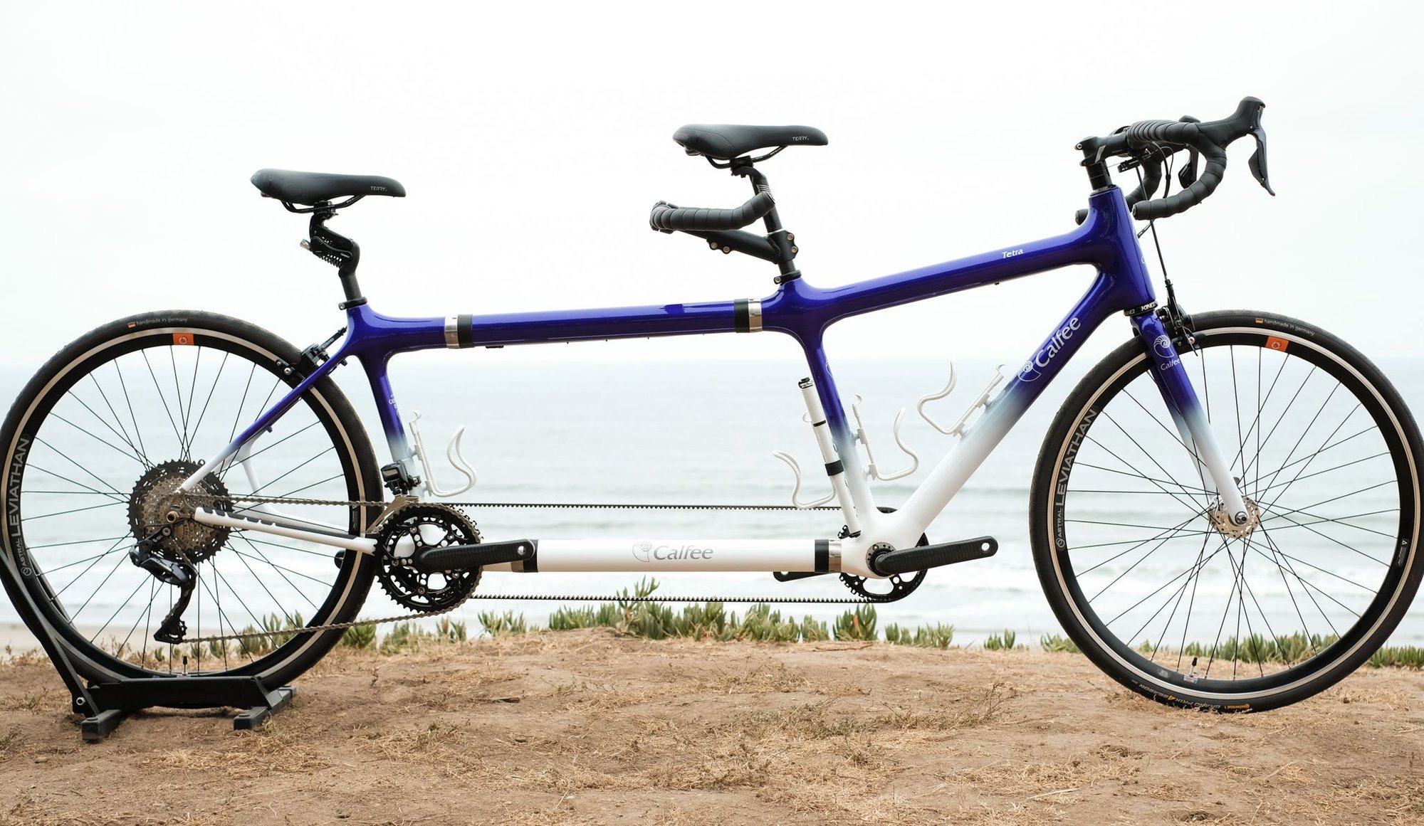

A few months ago I posted a lengthy description of the process of buying our new Calfee. The summary was that it was a wonderful experience. There were many requests for photos, so here they are. Some were taken in our backyard, and some were taken by Calfee before they shipped the bike to us. For the former photos, these are not the final saddles, which at the time we had not yet installed.

Looks like you went with a similar set-up as we did: Ultegra Di2 with rim brakes. Many have questioned why we didn't go with disc brakes. At the time I concluded that they were more expensive and heavier. We've had them for about 4 years now. We no longer do big, high speed descents so rim brakes work fine. I have no regrets about going with rim brakes.
However, we have struggled with using a 2 ring Di2 and trying to get the greatest range possible. After some experimentation, we have wound up with 52t x 34t up front and 40t x 11t in the rear. The downside is that the drop from the 52t to the 34t is huge and I try to avoid it. So we wind up riding the bike mostly in the big ring and use the 34t ring if I think we will be riding < 15mph for an extended period of time.
Most people who have adopted Di2 have gone with a smaller big ring so the drop isn't so big. The downside is losing the top end. We still enjoy doing a long descent in the 52 x 11 gear and watching singles trying to hang on.
Also, we have been riding the bike for quite some time in the full-synchro mode. It takes some getting used to and does have compromises but all things considered, we like it pretty well.

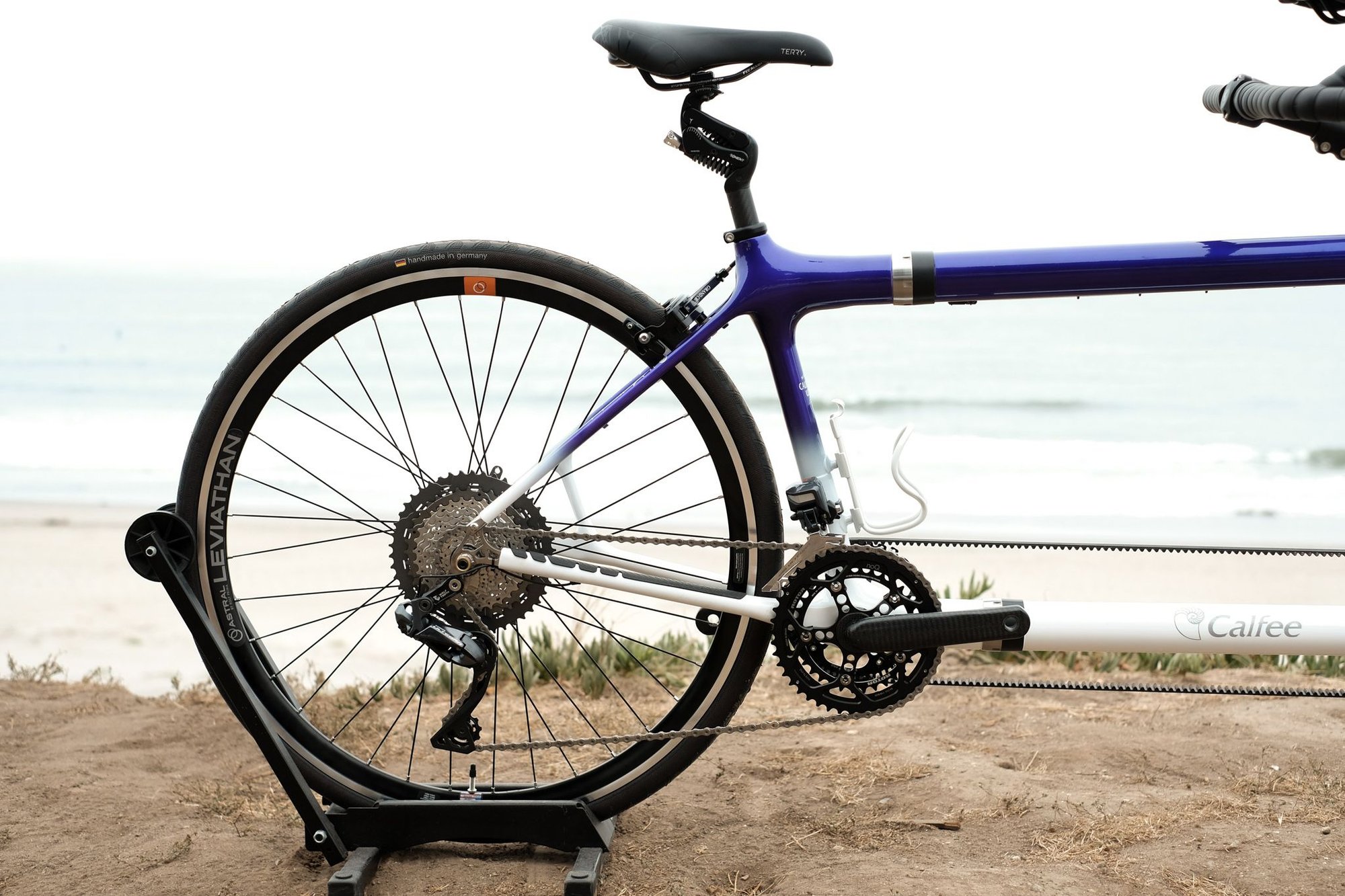

Gearing-wise, our bike is built with a 46/34 front and 11-46 rear. We wanted to prioritize a low climbing gear since we're not the strongest climbers who ever rode a bike, and are satisfied with sailing downhills at 45+mph. In retrospect, we're very happy with the gearing choice for us and our riding style. We tend to use the 34 front for the first third or so of the gear range and then shift onto the big ring and stay there. You're right though, that even though this setup gives us about the same range as our old 3x7 gearing on the Sterling, it definitely takes a little getting used to in having the two front rings. On the other hand, shifting the Sterling onto the small ring (barcon shifters) was always slightly problematic so we tended to avoid that unless we really needed 'tractor mode'.
So on balance, I'd say that I'm very happy with the DI-2 and like the gearing have. It just means that we have to work a little harder/spin a little faster on the downhills to watch the singles drop away. :-) (j/k!!)

Very nice. How is the Veer Belt working for you? Ours is skipping. Veer thinks it may be a defect in the rings and are sending us new rings.

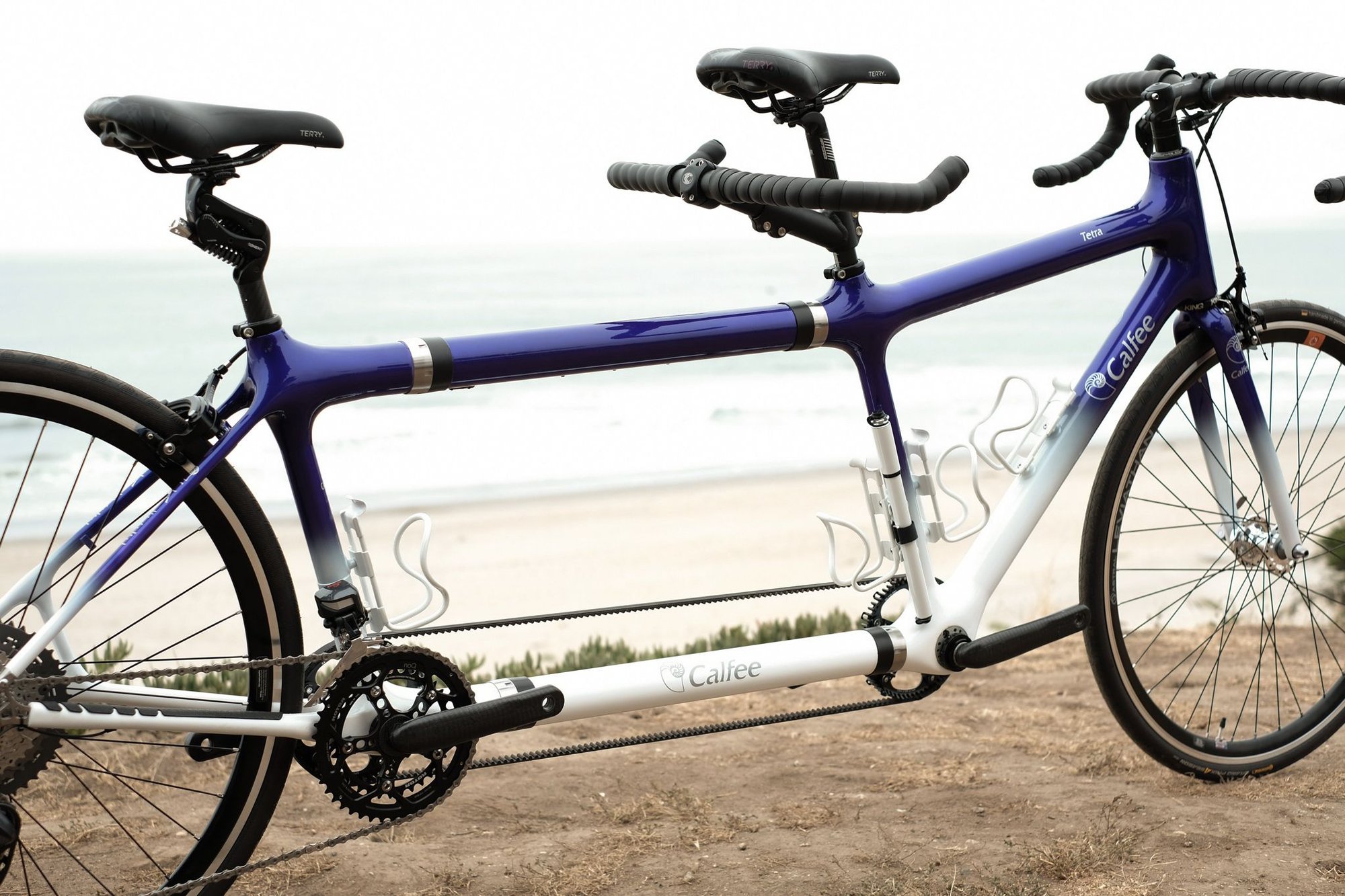

Very nice. I wish you many happy years with it. What is the fork made of, and is it disc-brake-ready?

So far we've had no problems with it, although when I first set it up I did get some skipping, but I attributed that to insufficient belt tension. Since tightening the belt, we've had no problems with the Veer belts whatsoever.

The forks are carbon fiber, and are not disk-brake ready. The rear triangle, however, is. If we ever felt the need to add a disk in front, I suppose we could replace the fork.
