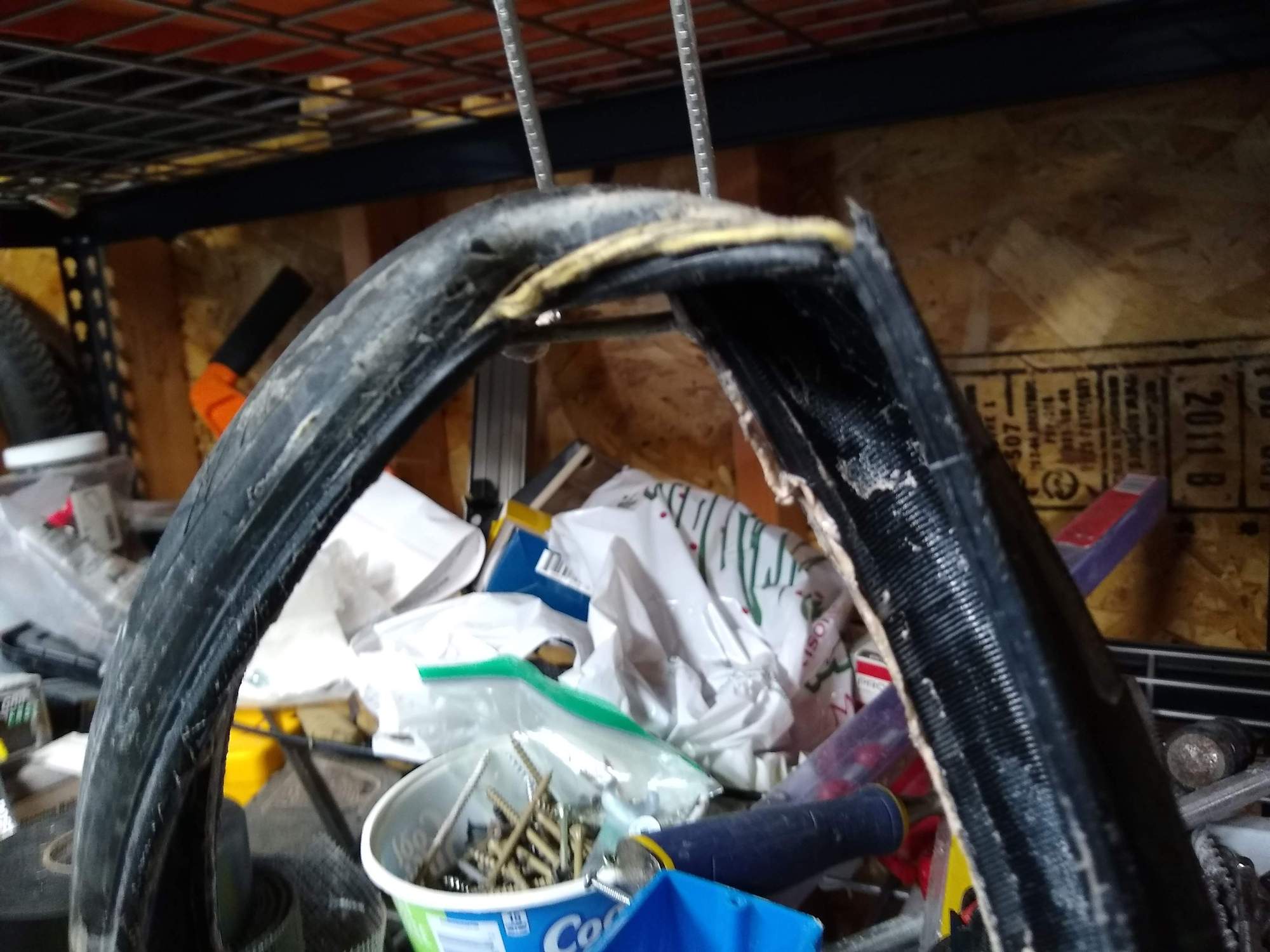

Descending, about 40 mph, near our house at the start of todays ride, our front tire blew. We did not go down, thus lucky. It is a 700x25c Continental Grand Prix. Looks like it is a tire defect. Horizontal split, just above the bead, almost invisible till you start pumping it up. Either slightly below the rim or close enough that I am pretty certain nothing cut it. The inside just looks like the cords separated. I still had plenty of tread left. We are riding a 2013 Calfee Tetra with 404 Firecrest Zipps. I run the tire at 90 psi and had not used the brakes, so there were certainly no heat problems. 90 psi is well below the max rating on the sidewalls of 120. I am thinking it is time to switch tire brands. Anyone have experience with the new Pirelli tires? Anyone measure their width mounted on 404 Zipps ( a few years old ). I can only fit a 700x23c on the back of the Calfee and some tires a 700x25c is too wide for the front (used to use Michelins till I decided to go wider than 23c. Michelin 25c do not fit in the front).

I've had Continental 4000's fail at that spot on both singles and tandems. However, I don't think the risk is unique to Continentals, and any lightweight racing tire can fail like that. How old were the tires? The casing threads can fail before the tread is worn out, particularly if the tires have some age on them.
Your failure might have been age related, road hazard, manufacturing defect, or a combination. I think all you can do is inspect the tires regularly, replace frequently, and/or go to a more robust, heavier tire.

The tire was about 5 months. I was thinking maybe age and replacing before the wear indicators show replacement. I switched from Michelin to Continentals maybe 5 or 6 years ago so I could get 700x25c on the front. This was the first failure.

I've had three sidewall cut/failures just above the bead as you describe. I found a statement on the Continental website warning that the internal hook (where the bead seats) on some carbon rims can be sharp and that these sharp-edged rim flanges can slit a tire sidewall. I checked the rim hook/flange on my carbon rims and sure enough they were quite sharp! I tried to post photos, but was blocked as apparently you must have at least 10 posts prior to posting photos and I do not have even 10 prior posts. If you happen to check your rim hooks I'd be curious to know if they are sharp.

I did go out and check the area of the failure. They do not seem very sharp. These are Zipp Firecrest 404 are yours also Zipps?

I did go out and check the area of the failure. They do do seem very sharp. These are Zipp Firecrest 404 are yours also Zipps?
No, they are not Zipp, but it is my understanding that the issue was not isolated to one manufacturer.

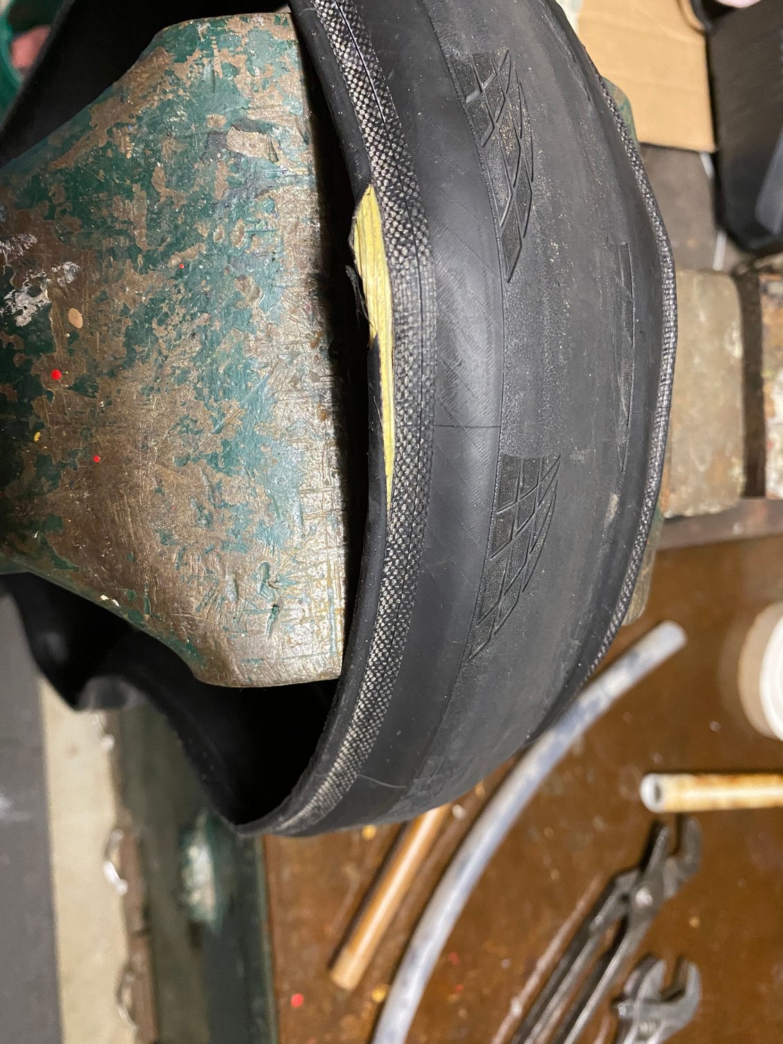

In July, I bought a pair of GP 5000 28mm tires for our Calfee. We run them with 100 PSI on a set of Rolf tandem rims.
With about 250 miles on them, we were climbing a big hill very slowly and the rear tire blew out. There was no pothole or rock or anything. We were going maybe 5-6 MPH and there was a loud pop as the tube blew out. The rubber on the tire bead came apart. Fortunately, we always carry a spare tire and we were able to complete the ride.
I tried writing to Continental, but I got no response from them. It's nearly impossible to figure out how to make a warranty claim on a bike tire on their site so I just wrote to their general email address. There was no phone number to be found. I bought the tires from BikeTiresDirect.com, so I wrote to them asking for a phone number or email to make a claim to Continental. They quickly replied that they would send me a new tire, and a few days later, I got it in the mail. I really like BTD! Never heard anything back from Continental.
Haven't had any issues since and we have about 2,000 miles on them now. With our business temporarily shut down (Adventures In Tandem) and nothing much else to do, we rode over 6,000 tandem miles this year, a new record for us.

That bottom photo is very interesting. Some years ago, there was a thread here about running reflective sidewalls for better night visibility. The photos were quite striking. They were Conti 4000 IIRC, not the later IIs. The reflective sidewalls looked very much like your bottom photo, exposed fabric with some sort of reflectivity in it. Though I assume that yours aren't reflective, they look similar. I blew two of those tires off the rim during short, steep descents, rim brakes of course. That had never happened before or has happened since. I did the same with Conti as you did, no response, but those reflective sidewalls disappeared off the website. I gather I wasn't the one one to have had a problem with them.
I checked my stock of 5000s. I have 23mm, 28mm, and 32mm and none of them have fabric visible there. All the fabric is covered with rubber in the normal fashion. Your tire didn't actually blow out, as I understand that term, rather it blew off the rim, just like mine did. The rubber on the tire bead was peeled off by the rim bead. My guess is that the fabric does not hold to the rim bead as well as rubber does, less friction, so it's more apt to blow off. Yours peeled the rubber off the bead, though mine did not.
So if anyone else here ever gets a Conti tire with fabric showing there, replace it.

That bottom photo is very interesting. Some years ago, there was a thread here about running reflective sidewalls for better night visibility. The photos were quite striking. They were Conti 4000 IIRC, not the later IIs. The reflective sidewalls looked very much like your bottom photo, exposed fabric with some sort of reflectivity in bead, though mine did not.
I am pretty sure our tire from the original post did not blow off. It was still well on the rim when we stopped. He is a picture of our failure, a very similar spot to the picture you are referencing, although not nearly as large.
Right, even more interesting. Your tire has that same fabric showing right above the bead as the blown-off tire has. I went out and deflated our 28mm 5000 which we've had on the front for several months, enough to wear the flashing off and start to develop a flat in the center. The area right above the bead looks just like that same area does on my in-the-box 5000 tires. If you have any others, you should take a look at them, see what that area looks like on them.
I wonder if it's the 90 psi? The official pressure range for a 25 is 95-123 psi. Back when I ran 25mm, I ran them at 115 Should have used 120, but that was just too harsh. I wonder if running them under-inflated and under much heavier than usual load, caused them to move a tiny bit at the bead and saw away at that area until the rim went through. That's what it looks like.
I'm running my 28mm 5000 on the front, which measures 29mm inflated on my rim, at 105psi. I run 32mm tires on our tandem at 95 lbs. 282 lb. team, 36 lb. bike. My rule of thumb for our tandem is tire pressure = 3000/(measured tire width). Because of tandem frame design and the usual proportion of captain-stoker weight, tire pressures on both ends are usually the same, unlike a single.

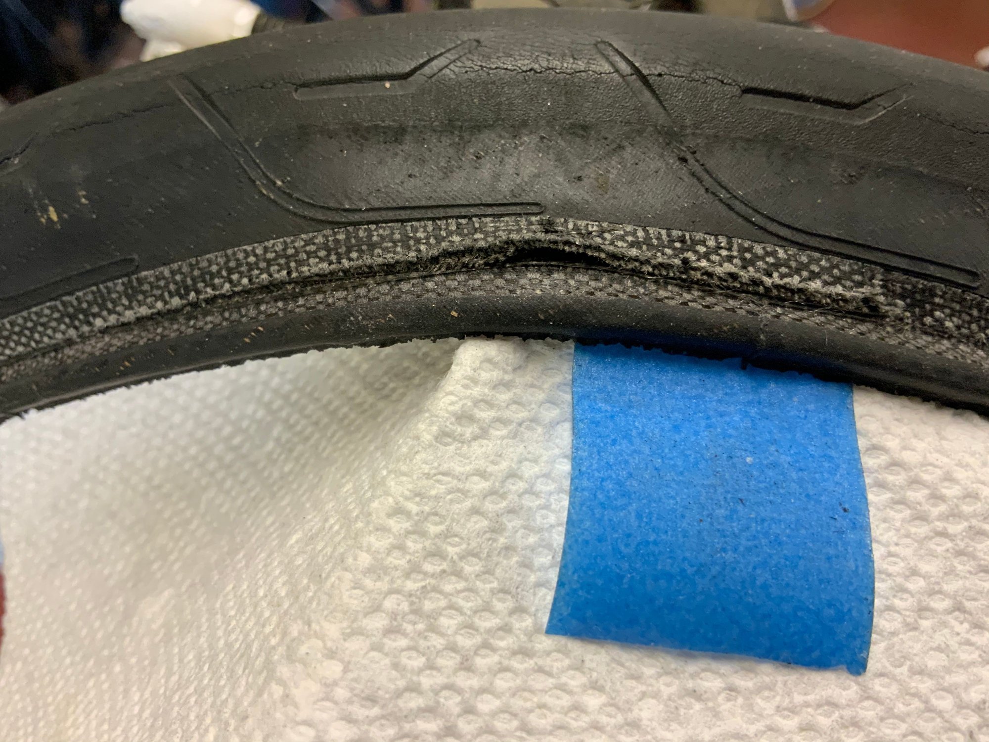

This is a GP5000 tubeless 25 mm tire. I had this tire failure on my solo bike. Rolf alloy wheels, so no blaming the carbon rims. This was the rear tire, and it had about 2000 miles on the clock. I believe this happened immediately after hitting a steel bridge to shore junction. Fairly low speed, rear wheel. Pressure was probably 90psi or so. I still have GP 5000 on my road bike and on our tandem. But I take a close look at the tires once a week just because this would have hurt if the speed had been greater.
