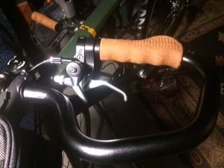

I ordered these and just received them. They are similar to the ERGON in shape & feel, waay less costly, and have the bar clamps on the inside. I can't wait to mount them on the trekking bars!
https://www.ebay.com/itm/Asti-MTB-BMX-Cork-L132mm-Ergon-I-D-22mm-Ergonomic-Mountain-Bicycle-Esi-Fits-Grip/163522350655?hash=item2612b10e3f:g:neQAAOSwOGlbYwBl:sc:USPSFirstClass!91709!US!-1:rk:1f:1&frcectupt=true
michaelm101 is online now

Nice grips but as the clamp is on inside you won't be able to cut then down, without losing the ability to stay at the angle you want (barring glue use)
It actually all fits in there w/o cutting anything and the end piece locks on the bar (in reverse of Ergon design, most likely a patent issue).

The cutting down of grips at the opposite end of the palm area can bring the levers the extra inch or whatever outwards, so that your "braking hand position" stance is a bit wider, helpful if braking slowly down steep loose surfaces.
different people are more or less comfortable with a narrow hand position, so there is no right answer.
Not using grips does allow the levers to be further out, and just using bar tape or foam stuff for hand cushioning.
Nice thing is that it's not hard to try out different setups to find what you prefer.
