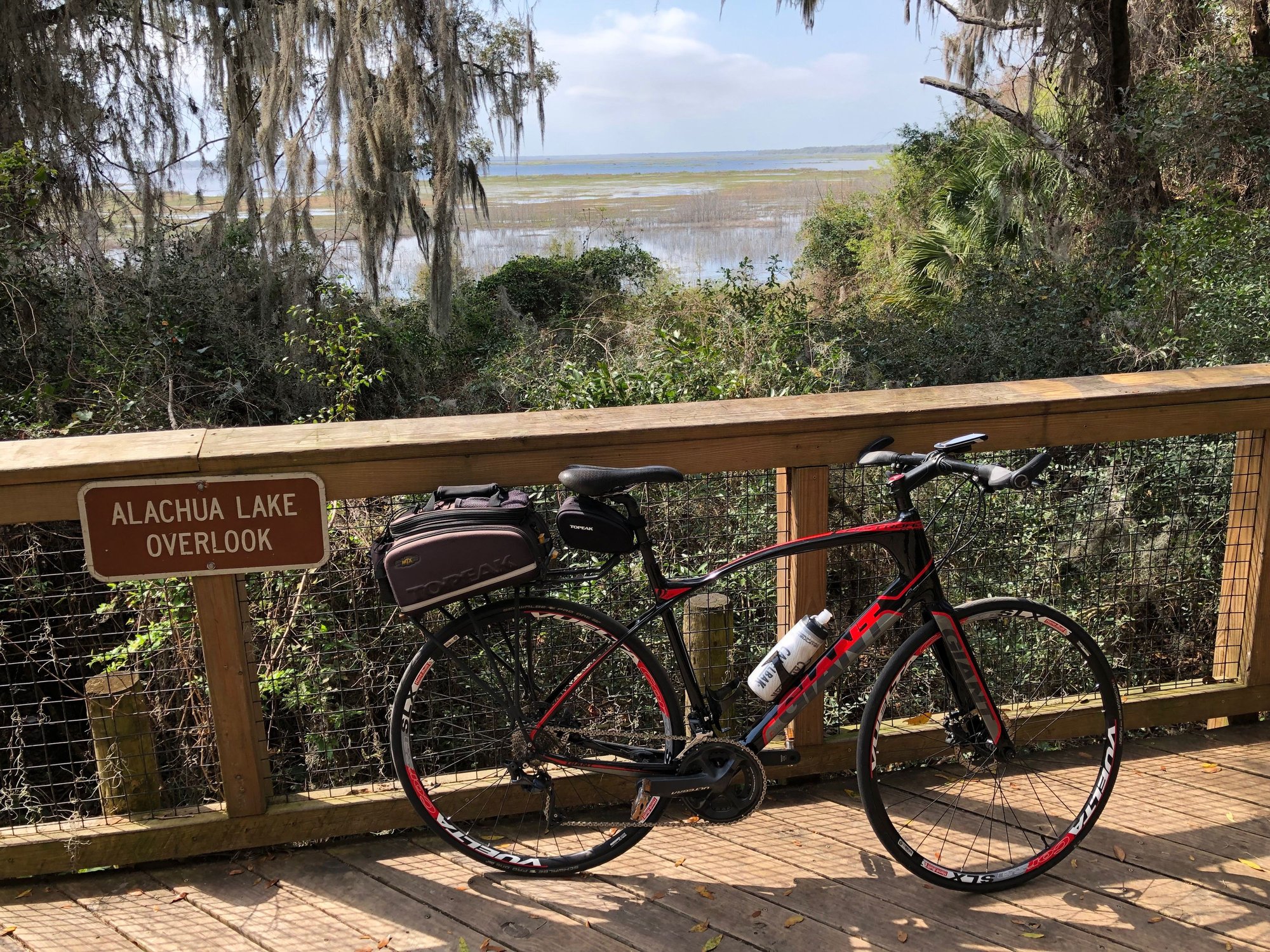

Well if you have followed any of my other threads you know we purchased a couple of new bikes last Dec. They have replaced the FastRoads as our daily rides and the FastRoads are going to be used as our travel (live of the motorhome) and bad weather bikes. In the past 2.5 months we have used them only twice. Once on the Withlacoochee Rail here at home after a bad rain and yesterday in Gainesville (had a Doc appointment at UF Shands) on the Gainesville Hawthorne Trail. Still great bikes and enjoyable.
