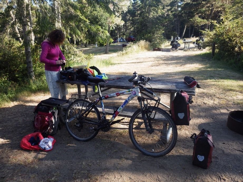

I think the main point with suspension fork for touring is that ideally you want the weight to be mounted where it rides above the suspension, not down where it goes up and down with the wheel. (Motorcyclists call that unsprung weight.)
And it can be some work to mount a rack on a suspension fork that was not designed for it. I however have seen a rack made by Minoura that could be mounted on a suspension fork.
In this photo the rider had an old Tubus rack that I think has been out of production for over five years that could mount the panniers up were they were suspended, not down below were they go up and down with the wheel. She had her rack repaired several times instead of replacing it because that model rack (I think called the Swing) was out of production. I was surprised she was on a long tour with an air suspension fork, but she said she really liked having the suspension. Her panniers were mounted up much higher than typical because of the design of that rack.
I have put a suspension fork on my Thorn Nomad when I used the bike as a mountain bike, I don't have a mountain bike and the suspension fork was an easy swap. My Nomad frame is designed for a 100mm suspension fork and I do not think I would use a mountain bike enough to make it worth owning.
But I do not see myself using the suspension fork for touring when the solid fork was designed to carry panniers.

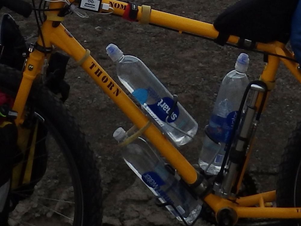

In the interest of keeping the thread going until mev posts an update
I was looking at my bike and thinking about some other additional water bottle mounting options. I have a Blackburn cargo cage on the seat tube that holds 1.5L and have in the past mounted cages on the bars. Yesterday I remembered a triathlon seat mount I bought one time (sorry forget what brand). It's one of those behind the seat deals which I found serviceable enough but awkward when swinging the leg to mount/dismount.
I started playing with possible alternative locations and discovered it fits my rear rack perfectly so I mounted it and bolted on some cages and took it for a test ride with the result of no rubbing of the legs. Kind of unusual but I can now mount two large bottles there if I want.

After several rides with the bottle on the top tube as described earlier I have found it tends to get knocked around a bit too much and I have to reposition it every so often. Not so much on roads where one maintains a sort of constant movement but on trails I tend to put my foot down twist, brace etc...
Next up will be trying it mounted further forward where the gas tank bag should go, above where it says Nomad in the photo above. That would still put it withing easy grasp but out of way of my knees. I could see getting a set of water bottle bosses added there eventually that could hold either a bottle cage or gas tank bag.
One thing I think about water bottles is they have to be convenient and easy to get to while riding or I tend to not want to stop and futz with them. This sometimes leads to dehydration. Gas tank bags tend to solve the same problem for eating by keeping snacks close at hand. My 1.5L nagalene bottle is strapped into the cargo cage and a bottle under the DT would not be handy so I want one or two up high. In this article Lael mounts hers on the bars (which I have also done) but, if I use areos it gets a little crowded there. https://rootsrated.com/stories/lael-...epacking-world
