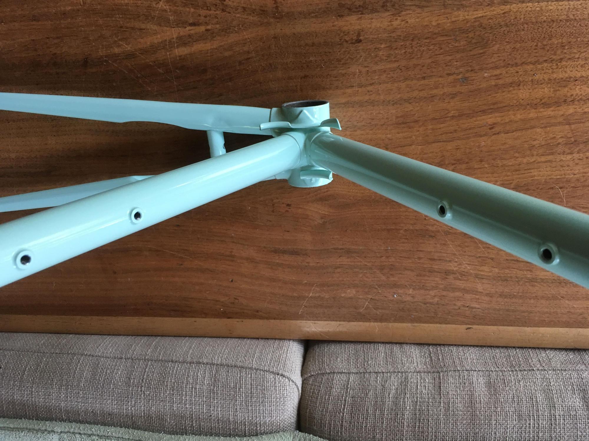

Tapping a frame
so i bought a full suspension mtn bike for my wife. while i was doing that initial prep work, peeling stickers and tossing reflectors, etc, i noticed that there are not bottle cage mounts inside the triangle. would it be imprudent of me to have the inner side of the downtube tapped for bottle mounts? the bike in question is a Ghost from REI and the bike in the photo has cage mounts, as you would expect. i bought her a small frame, i believe the size is the issue, but there is enough space inside the triangle for a smaller bottle. the shock mount movement is mainly vertical, so if positioned properly, the bottle should not interfere with the shock. i would have to install one of those side-loading cages, i happen to have one handy. the question is, should i worry about my wife if i get the frame tapped?

Can you get your tools in there to work?
I'd probably drill a small hole in one location. Then assess the tubing wall thickness. If it seems OK, drill and tap both locations.
If the tubing is too thin, then enlarge and try a pair of rivnuts.

Rivnuts would be a must. Tapping the frame tube would not be reliable.

Agreed that Rivnuts is really the only way to insure long term reliability. Take much care as to exactly where you place them. Plan to somehow remove the tubing chips from inside the tube after, like pulling the BB or fork and shaking them out a vent hole. For someone with the right tools and having the bits on hand this is a fairly quick and easy job. Andy

rivnuts! thanks for the tip, gents, i've never heard of such. i'll have to see if my mechanic is familiar....

Do know that solutions that have an electrolyte in them and are spilled, dribbled, from a water bottle and come into contact with in frame bosses can rapidly cause corrosion between the bolt and the boss. Rivenut material is chosen for it's moldability, not it's resistance to corrosion. If you ride with this stuff in your bottles I strongly suggest periodic removal of cage bolts and relubing them. Andy

I sold these bikes for quite a few years, and the problem with smaller frames is (as you mentioned) there is no room for a bottle cage. I wouldencourage you not to try to do anything to alter the frame. First, you’ll absolutely void the warranty on the bike. Second, whenever a frame is drilled or compromised, it increases the possibility of cracks and frame failure. Here’s a pic of a steel frame I bought that had been drilled for hidden cables (at the factory). When I sanded the paint away for a refinish, I found cracks at the hole. I’m not saying that would happen with aluminum, but it’s a possibility. You’d be drilling through the thinnest part of the tube. I recommend looking for an alternative. Plus . . . you’ve got a nice bike!

You beat me to it. I would absolutely never tap a frame (especially an alloy frame) myself for fear of causing stress risers. It may take years to have a problem or it may take a few days. If offroad, maybe faster. I was going to recommend a behind the seat post mount, but it appears to be a dropper post, so no room. The seat mount is workable and handlebars mounts are very handy, I used one for years. I recently saw a bike with one that attached to 2 of the four handlebar clamp screws, but the rider was not present to ask where he/she bought it, and I was not going to go real close to look for a manufacturer name.

Before I did any irreversible frame work, I'd try the twofish bottle cage mount. Just because the bottle will fit doesn't necessarily mean that it can be removed and replaced easily while riding. Some folks can take a bottle out drink, and replace it without a bobble or any noticeable change to their line. Others wobble and can't hold a line doing the same thing. With the twofish mount, you can experiment with downtube and toptube locations to see what works best, and you may ultimately decide to use a camelbak because it's just easier to manage on the trail. Has more capacity too, and some of the models have zippered pouches you can carry snacks and/or a jacket.

Aside from the other very good reasons not to do this, do you have a drill with a right-angle chuck? That's a pretty tight area.
I second the TwoFish recommendation.

no frame tapping, then! i've had those undersaddle tri-bike type mounts on a mtn bike before, the bottles were launched quite nicely. i'll get a pair of SKS straps with bottle mounts, they came up when searching twofish. replies appreciated, glad i asked.
