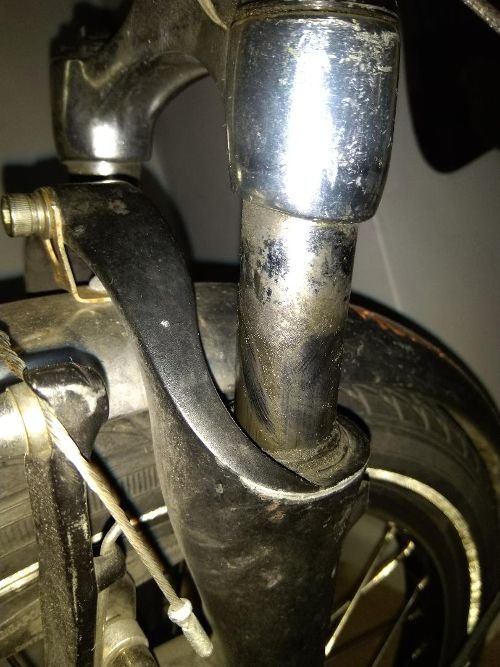

I bet what's going on is that you have a suspension fork on your folding ebike that's leaking a little bit of oil. When you press down on your handlebars, do they spring down under pressure a bit and come back up? Then you have a suspension fork, and it's still working fine. A little oil leakage happens. The seals age a bit, and a little oil gets by. For now, just wipe it off.
Replacing the seals on a fork can be a fairly complex job -- some shops even send it out to a fork specialist.

Yep its the fork alright. Ok where the fork/s go up and down. If that makes sense? OK
OK looks different to the diagram you sent me

Hi i have uploaded a couple of photos in another response
Oh that makes sense to me .Yeah suspension sounds the right word and how you described the movement. I am so used to folding ebikes i am just not around or look at what others have much. It was such a learning curve getting into them years ago. Oh yes it springs back up. Oh good i can just wipe off...i was so unsure. I am really good at cleaning other parts of the bike that u have to on a regular basis but i just didnt know if this was something i should clean or ignore. Thanks a lot

Originally Posted by Crankycrank View Post
That is called a suspension fork and has fluid inside. Looks like you have a leaky seal. Needs to be taken apart and new seal and suspension fluid installed. Best to find out the brand and model of your forks and look for instructional videos then decide if it's something you can do or get help from friends or a shop.
Oh thanks yes it looks like it is this one. Says zoom on the side of the fork https://www.velostreet.com/en/produc...26-1-1-8.2219/
