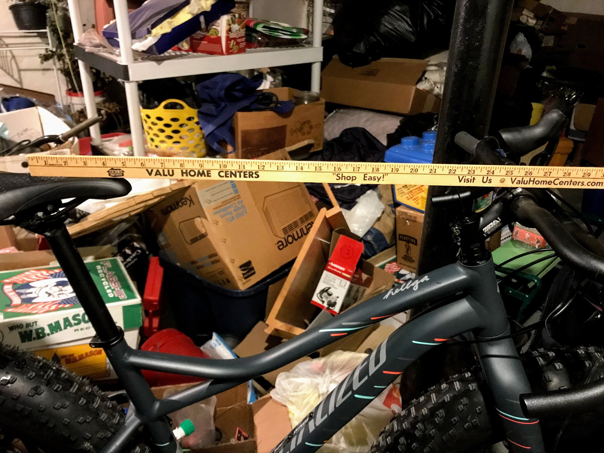

So I decided to play around with my potential bar/stem setup for the conversion.
The stock stem is a 70mm 6 degree rise stem. The Giant stem is an 80mm 20 degree stem with a bit more stack compared to the stock Specialized stem so I had to remove a 10mm spacer from under the stem to fit.
I like the rise of the stem paired with the rise is the Flared Hover bars which are 46cm wide. I didnít want to change stems but I think Iíd want a 75mm stem with 24 degree rise if Iíd want to do any technical stuff with the drops. If I didnít already mention it, this bike has a 594mm effective top tube which for a MTB is short enough to where the stock stem wouldnít be too stretched out.

You probably know this but those bars on that stem really change the fit of the bike. If you bought the flat bar version sized right that may be an issue. Toggle between the two pics to see how much longer the reach is riding the hoods or drops compared to the original flats. I would try riding around with the flat bars zip tied up so you can check that out before committing. I find a long reach ruins my balance in the saddle and I put too much pressure on my hands.
I think my plan will involve comparing the reach to my Toughroad GX with the drop bars installed. The overall reach on this bike is shorter than most other fat bikes of this size.

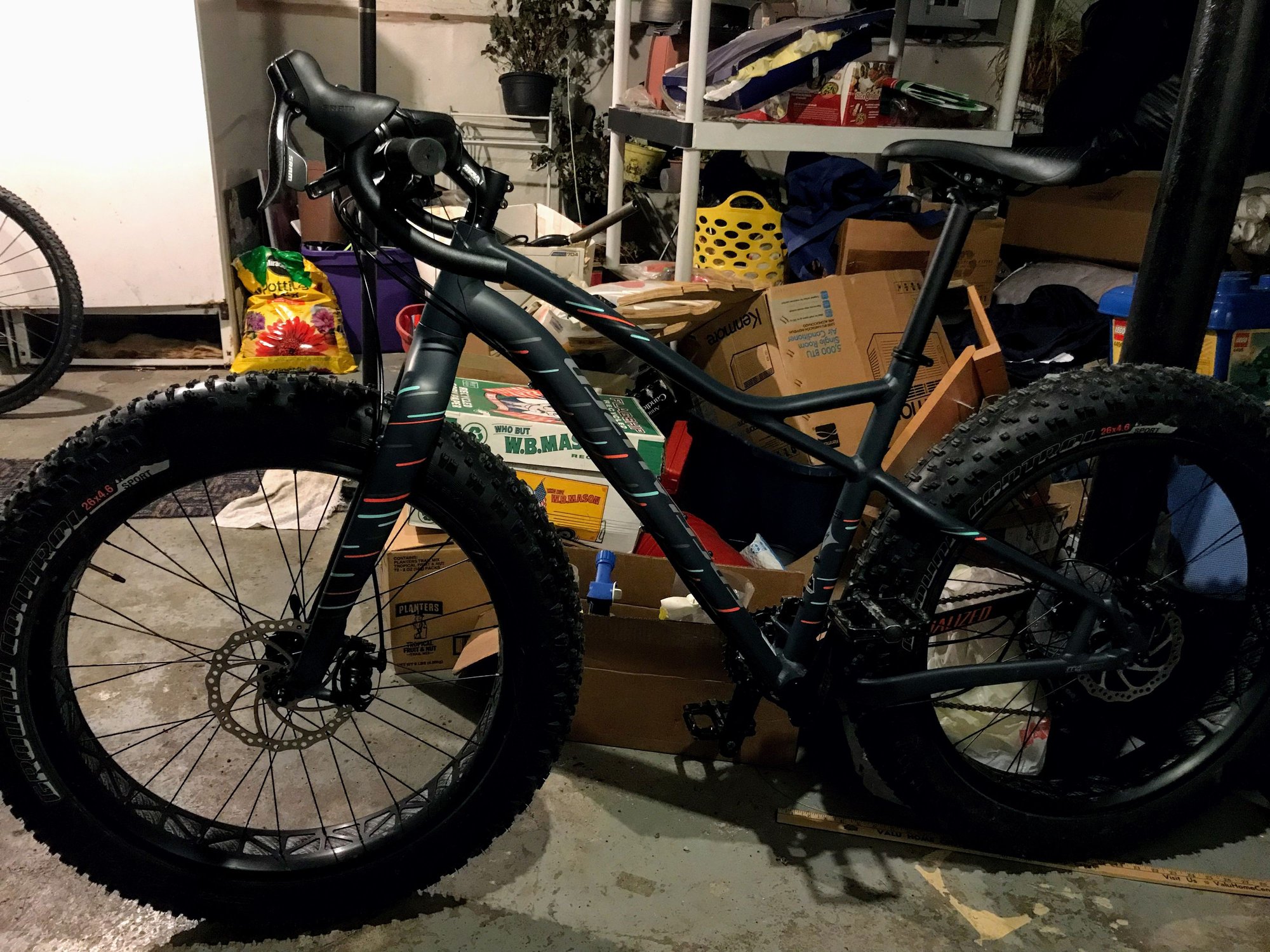

Update: Got a slightly different stem and some bar tape from the LBS. This stem has a 25mm rise and is 80mm as well however the Giant stem was, well, giant. I had to remove a spacer from my steerer tube to get it to fit. This stem works with the stock set of spacers.
The shop I believe has a Specialized stem thats 75mm and 24 degree rise, at least it said they had it in stock online and the same price as the stem I got, so if they have it I'm going to return this stem for that one. It's weird but I think it'll complete the look that I'm going for.
Also wanted to do some side by sides with my Toughroad to show how close they are.
Lastly one important note: I have both saddles pushed as far back on the rails as possible, however the Hellga's seatpost has a 12.5mm offset whereas the Toughroad's seatpost has no offset. I would tweak the saddle position once I had the bars fully installed.
Last part that I "need" arrives Monday so sometime next week should be the finalization of this pet project

Looks awesome! it may not break any landspeed records with those tires, but I bet itíll be a blast to ride.
Monstercross taken to a new level. Monsterboss? Monsterhoss?

Its my ďis there any amount of snow on the groundĒ bike whereas my Toughroad is definitely my ďgo fastĒ gravel bike in comparison.
