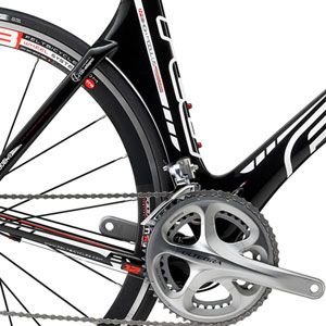

This is an image of a 2010 Felt B12 that I found online. I don't see the rear brake caliper. Is it mounted to the seattube and hidden here by the chainrings?

Sorry for the super late response.. I thought I had replied on my phone.. but it seems like it didnt post it... I've checked with my local Felt dealer, and they checked back with Felt.. my bike's fork is not recalled.
Dan
Yea, the brake calipers sits on top of the chain stays, behind the seat tube. I'm also thinking it might be the crank arm, seems kinda far fetched.. but hey, who knows.. the bike has a sram red 10spd groupset.. I dont know if that specific crank arm is thicker

Well, if you really like those brakes, the answer might be to get a BB with a slightly wider spindle on the non-drive side...so that when the crank is mounted it sits slightly farther out from the frame/BB and thereby makes room for the brake caliper.
