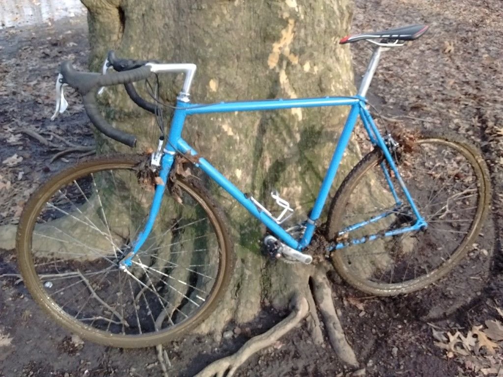

Budget cross/gravel bike build from old road bike
I built up this bike as a gravel/cross bike using mostly parts I had lying around but I think it came out OK. I first tried to do this using an old Fuji road bike that had 700 wheels but the brake clearance precluded any tires greater than 28mm wide (and even then it would rub on occasion). I was out walking one day I spied an abandoned Nishiki Sport that had 27" wheels (or at least it did before it was dumped sans wheels, bars, gears and most of its original paint...) so I hauled it home.
This frame makes a good candidate as 27" wheels are slightly larger than 700 so I can mount larger tires on it and not worry about frame clearance. There are a ton of old 27" bikes out there and some had halfway decent frames with forged dropouts, crmo tubing (double butted even) and these are the ones to get.
As the paint was shot and starting to rust, I slapped a coat of rust-oleum paint on it, just sanding enough to score the under paint but it'll no way win any awards. Cranks were from an old mtb bike with 22/32/42 gearing but I chopped off the 22 inner cog so it is now 32/42 and does not need a long spindle (which I didn't have anyway). Gears are what I had from an old road bike - 9spd Campy shifters, Tiagra rear derailleur, 12-26 cassette, (this is a Shimergo conversion which I won't detail here but the lever is modified to give correct cable pull). Brake calipers are mid-reach Tektro 539 I had on hand but cost only $28 on Ebay if you need to buy them. Normal short reach brakes would not reach the rims. Tires were the only expense and are 700x32 and they have plenty of clearance.
It rides well with brakes and gearing being good but if I was buying parts I would put on a cassette with more gears 12-32 perhaps and 10 spd would not go astray. It's also a tad small but that's another issue.

Nice! Looks almost brand new. That shade of Rustoleum looks great. Is that a brush job?
I used to think there were tons of old 27" bikes out there, until I actually started looking for them. Then I realized how scarce good 27" frames are becoming these days, Old Varsities and Continentals are 75% of what I see.
You gonna get some decals? Might break the bank, but I think they'd look awesome.

Like that color. What is it called? Is the paint durable?

Looks great! Plus you've got fender eyelets there.
Another key feature of the 27" wheels is that they were usually 1.25" width tires, or ~32mm in addition to the larger rim. Honestly, most were almost gravel bikes to begin with...

The paint is just Rustoleum - not sure of the color and I chose it as it most closely matched the factory paint so chips are less likely to be seen. I assume it will not be that durable and will soon acquire what is termed "patina of age". And yes - I noticed the eyelets too - will come in handy if I ever want to put on a rack for touring. The more I look at it, these 27" wheel bikes are ideal for this type of conversion with their more relaxed geometry, large tire clearance, rack mounts and what's more is they are unloved and usually cheap.

Thread title should be : "Stole a frame, built a gravel bike"
Jk, great build. The ocd in me wishes it had a matching groupset and a threadless carbon fork, but I'm sure that thing rides as great as it looks.

we'll be taking notes on how that fork holds up over use on rougher terrain. That's the only thing that might be worth mentioning?

Nice job. I did a similar conversion ten years ago of a 1980 Fuji S12-S going from 27" wheels to 700c with 35mm tires. To my surprise, the original brakes worked with the smaller wheels. I also did a rattle can paint job with Rust-O-Leum, which is still holding up pretty well. At first I built it as a fixed single speed...
SS 2 by Benny Watson, on Flickr
then added gears (Campy Racing Triple with 7 speed freewheel) for more of an all arounder style which I rode on dirt roads a good bit...
IMG_6263 by Benny Watson, on Flickr
Nowadays I have it set up as a town bike with upright bars and a basket...
bars1 by Benny Watson, on Flickr

That's a really nice subtle shade of brown, great finish too, seems to have some shine. Looks perfect in the pics. Is that spray-on or brush-on Rusto? Love the thumb shif-ters, I wish Shimano would start making those again, as it is they're practically worth their weight in gold.
I have lots more fun with projects like this than buying something brand new. My problem is, I never know when I'm "done", so at some point, the bike eventually winds up in pieces again.
It really takes some extreme discipline to restrain myself from making more changes, or putting the parts onto another frame I think will be "more better". But hey, it's my stuff, and I paid for it, so why not?

Thanks. "Rattle can", so yes, spray on. I took a lot of time prepping, sanding, primer, sanding, first coat, sanding, second coat, sanding, clear coat. It took about a week altogether, most of the time in drying between coats. It has held up pretty well for 10 years, but lately the shine has dulled and a few scratches are showing up. But I'll just live with the beausage. Maybe a spot of clear nail polish here and there to prevent rust.
I have the same "problem" with making changes and upgrades to these old project bikes. But that's really the fun of them. I'd have probably sold this one long ago if I hadn't moved the Campy drivetrain and custom made wheels (Torelli rims and Phil Wood hubs) over from a Bridgestone RB-1 that I was upgrading again.
Projects like this was how I learned to set up my new bikes, which are almost always builds from frames. Those projects are even more fun, but WAY more expensive!
re: thumb shifters, although Shimano doesn't make them anymore, Microshift makes very good ones with models compatible with their 9, 10 and 11 speed systems, both road and MTB.

Took it out for a bit of mud bashing yesterday and a couple of things I observed. First in really thick mud it will clog the brakes and you have to stop and clear it so it's definitely a gravel bike rather than cross but it's too old and heavy to race anyway. The second is my lowest (easiest) gear (32 fr and 26 rear) is not low enough for steep hills and a 30+ on the rear cassette would not go astray. If doing again I might also put on bigger tires (38mm?) as there is clearance for them. But as a bike for dirt/gravel trails it is ideal this is a great way to re-purpose those 2000 era race bikes with Al frames and 8, 9 or 10spd STI shifting that are languishing in every second basement.
