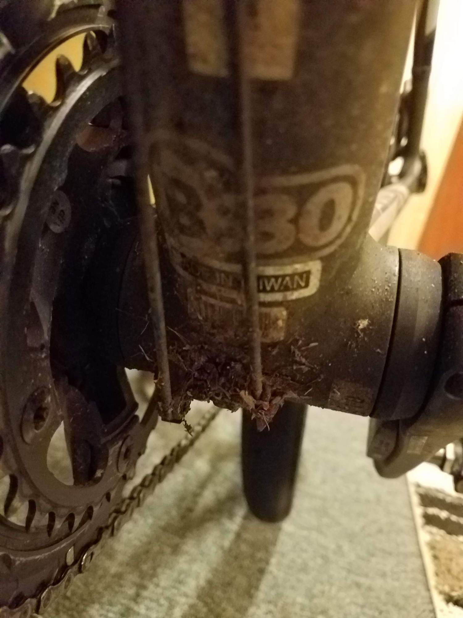

I'm wondering why, with a 1x system, etap is so desirable. How hard can the shifting be? Like the 1x though.
I think for once I agree with Bob.
I'll tell you why. My shifting quality never lasts. The under-bb cable guide just gets way too dusty and dirty and even if it is shifting well it is so flipping squeaky I can't stand it. I can't wait to get rid of wires. Can not wait.

Old 02-12-19, 02:30 PM
Happy Feet
Happy Feet's Avatar
Posts: 3,048
Quoted: 1137 Post(s)
Liked 26 Times in 22 Posts
Excessively dusty and squeaky cables? I'm afraid to ask how you feel about chains

Old 02-12-19, 02:32 PM
shoota
shoota's Avatar
Join Date: Jun 2012
Location: not sure
Posts: 6,210
Quoted: 933 Post(s)
Liked 3 Times in 3 Posts
I think people should buy what they like etc... and I'd buy the "I just wanna have it" argument all day no problem but that much money to try to improve the linear shifting of a 1x system just seems excessive.
My chain is fine. I think I'm missing your point.

Old 02-13-19, 08:02 AM
shoota
shoota's Avatar
Join Date: Jun 2012
Location: not sure
Posts: 6,210
Quoted: 933 Post(s)
Then just coat the cable with what ever you lube the chain with
Tried. It works better than nothing but it still doesn’t last.
shoota is offline

Old 02-15-19, 06:23 PM
redlude97
Join Date: Sep 2011
Posts: 4,028
Quoted: 1593 Post(s)
Liked 12 Times in 9 Posts
https://www.jensonusa.com/Jagwire-Bl...ts-18mm-Cables
solves all the issues on my superx, use with the new shimano nosed ferrules. No problems in dusty or muddy conditions

Old 02-15-19, 11:15 PM
shoota
shoota's Avatar
Join Date: Jun 2012
Location: not sure
Posts: 6,210
Quoted: 933 Post(s)
Well son of a gun. $10 for 30m isn't too bad of a price either. Can you link "the new shimano nosed ferrules" for me please? I'm not familiar with those. Thanks!

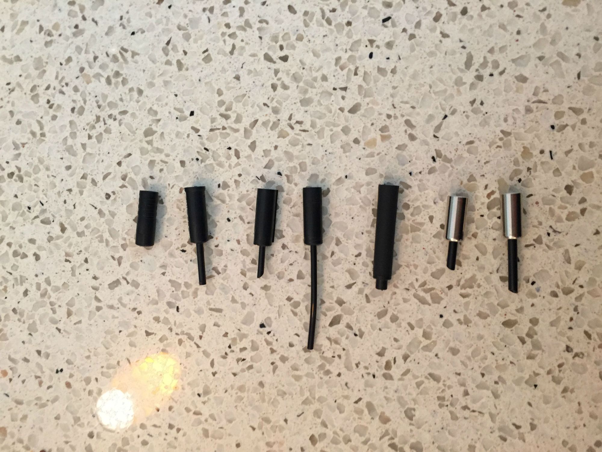

Old 02-19-19, 01:23 PM
redlude97
Join Date: Sep 2011
Posts: 4,028
I use the ones 3rd from the left
They fit into the slots and you can slide the housing liner over(sorry for the out of focus image)
They fit into the BB cable guide and keep things tidy

Old 02-19-19, 01:57 PM
shoota
shoota's Avatar
Join Date: Jun 2012
Location: not sure
Posts: 6,210
Quoted: 933 Post(s)
Wow thanks for the pics! That really helps. Question: what keeps the liners from slipping out of the ferrules and bunching up or slipping down the cable?
Edit: Wait, the liner goes OVER the end of the ferrule?

Old 02-19-19, 02:10 PM
redlude97
Join Date: Sep 2011
Posts: 4,028
The BB guide holds them pretty tight(install them before inserting the cables) and the liner fits tightly over the ferrules so they don't slip around. On my superx, its set up 1X so not sure how well it would work for the FD cable but on the CAADX I just run the liner up to the FD(6800) connection point with ~1/2" of bare cable sticking out so its technically not a sealed system so water and contamination could come in through the top. I just put a little great on the top and it seems to keep water and dirt out mostly and the FD is less sensitive to contamination. I can take a pic of that at some point if you want to see that setup. For the superx I would guess you'd just cut the liner long enough so that it butts up against the frame where the whole for the FD cable runs into. For the rear you just have the cable stops and ferrules on both ends keeping the entire cable length closed.

Old 02-19-19, 02:12 PM
redlude97
Join Date: Sep 2011
Posts: 4,028
Yea over the hosed section of the ferrule, I edited my post to indicate the 3rd ferrule from the left, I think I had to stretch the end of the liner just a hair with a straight pick tool

Old 02-19-19, 03:18 PM
shoota
shoota's Avatar
Join Date: Jun 2012
Location: not sure
Posts: 6,210
Quoted: 933 Post(s)
Ok awesome thanks man. The 3rd ferrule from the left makes more sense to me and I get the installation process now. Off to order...
