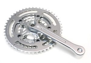

And peter white sells TA tripleizer middle chainrings, to alter your square taper BB road crankset

Shimano made triples up to Ultegra 6703, and the parts are available on E-Bay.
There is an Octalink V2 "road" triple crankset readily available. I assume Claris (or other) shifters to go with it.

The problem with the otherwise nicely made Octalink cranks is the 39T limit on the 130 bolt pattern. If you ride on flat land or are stronger then many of us small old people then my problem with this 39T middle ring (on their triples) is of no mater. But I know more then a few who use a 34 or 36T middle ring so to even out the ratio steps. (And with the unavoidable 11T high gear cog out back I run a 46T big ring on most of my bikes too). I really wish a quality made 110/74 bolt pattern Octalink arm was available.
But for me the ratios are more important then an ounce or two of weight and the non issue of "stiffer" anything. Andy (46/36/26 on the Sunday club bikes)
