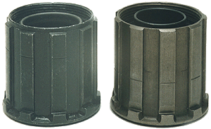

IF your FH is like picture #5 in your link, that's NOT a Hyper glide cassette. It's Uni Glide.
The last cog is threaded on to hold the other cogs in place.
Later versions were Hyper Glide compatible. See pic- (Or is that Uni Glide compatible)
Best to get a more modern hub if you want lots O' Cogs.

My freehub body is like the middle one. It has the wide spline, but splines end flush against the edge of the body rather than having a 1mm space around the edge like the third one.
Will I run into any issues swapping the freehub body out? I have an ultegra 6500 rear hub with a freehub like the third one in the picture. Not using that hub because it's a 28h
I think you can swap them, but I'm not positive since I don't have an exploded view for the 6400.
A 10mm hex wrench should remove either one, so it's pretty simple to give it a try.
You want to keep the DS cone/seals etc. with that specific FH body.

Yes, you can swap them. Use the DS seals, nuts and cone from the Ultegra hub, and the NDS seals, nuts and cone from the tricolor hub.
That FH is NOT 11T compatible. I got the image from Sheldon and the one on the right isn't the "Compact" version that's required for 11T.
