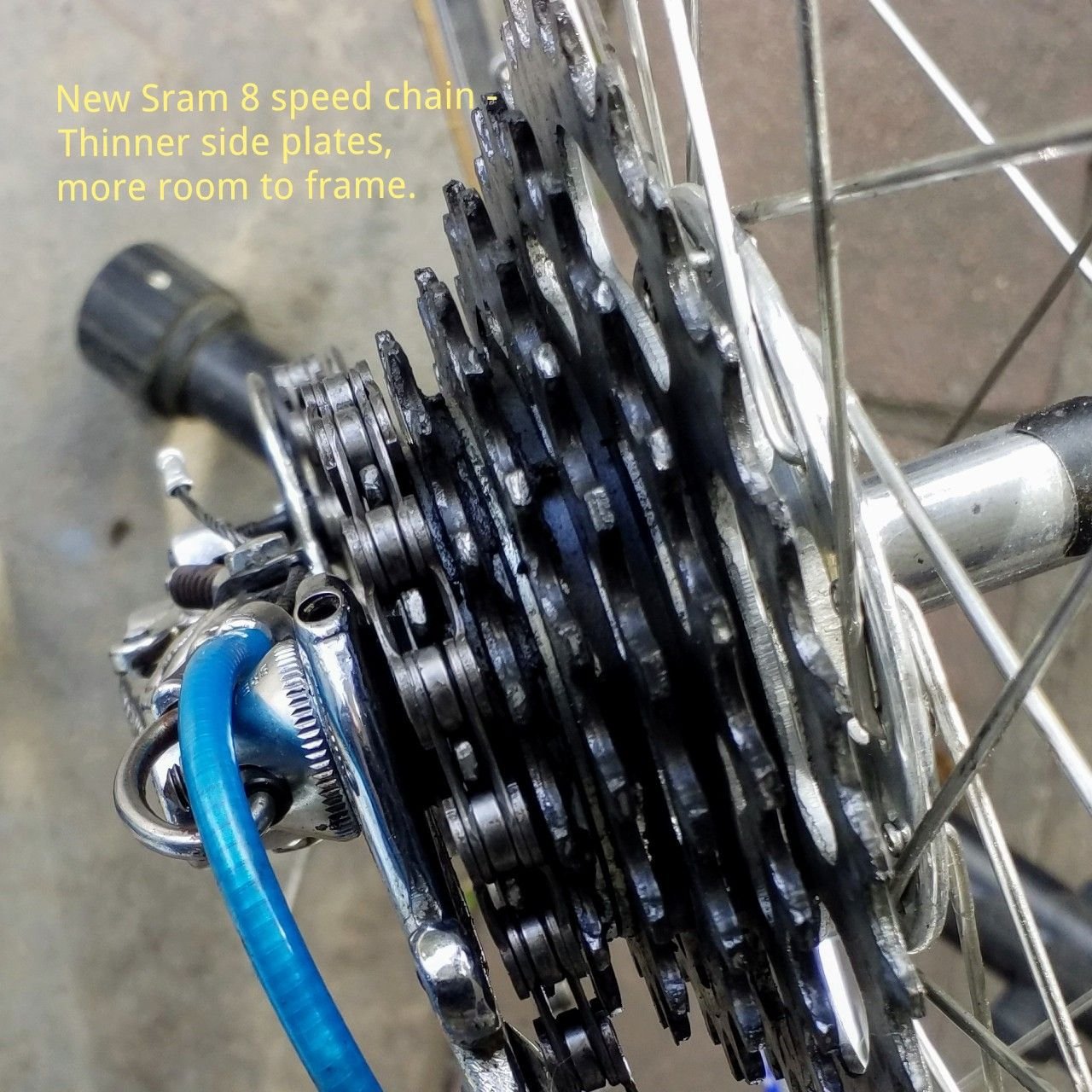

Sad to say, but this is the original chain that came with my 1964 Legnano. I raced on it, commuted to college, and it hung in my garage for 20 odd years before being put back on the road in 2000. I've had it checked a couple of times, always in spec, and it runs smooth, doesn't skip, and the gear teeth seem in good shape. I just upgraded from 5 to 6 speed, and the crank was changed in 2016 from the original 53/45 to a 52/42, more friendly to old legs. I've had a new KMC 8 speed chain since 2016, but haven't gotten around to changing it. The 6 speed freewheel is a little close to the frame, so I think I'll finally get out the KMC and change it. I don't baby this bike, but it doesn't get that many miles, couple of hundred a year, lately.
Time for a good cleaning.

You guys got me thinking. 55 years is a long time to use a chain. I certainly got my money's worth out of it. I'm talking about the blue Legnano posted above. 2 years ago, I bought a new chain with the idea of changing my (then) 53 year old chain. Ok, today, I finally did it. You know, the new chain (Sram 8 speed ) is considerably lighter than the old motorcycle chain that came with the bike. It seems to shift better, is quieter, and provides a little more clearance between the small rear gear and frame. I recently went from 5 to standard 6 speed (not ultra 6) freewheel, and the old frame was pretty close to the chain. Better now, but I'll bet the new Sram doesn't last 55 years. 😁
