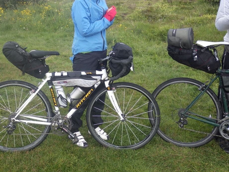

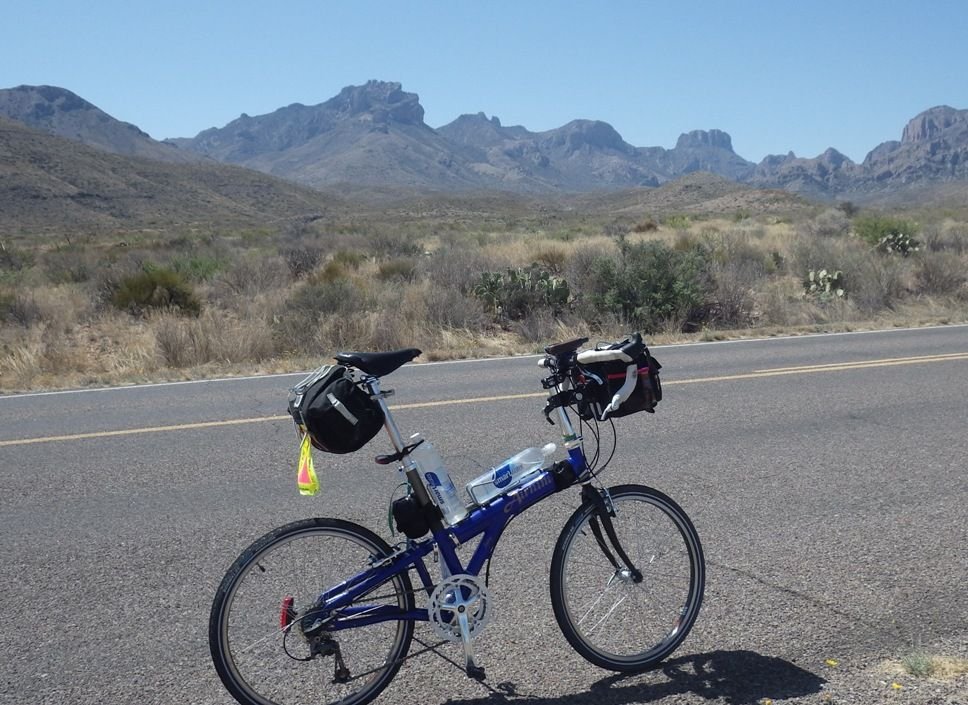

A few idea in the photos below,
1st photo, I took this photo of a bike I saw in 2016 where the owner had a bracket to keep his bag off of the rear tire. It was clearly a DIY bracket. A friend of mine had the same issue, so I took that photo for him.
2nd and 3rd photos, a couple people I met in Iceland and their bikes, they were camping so on the bikes you see their tent and sleeping bags. In other words they packed really light, yet they had the camping gear on the bikes for a two week trip in cold weather. (I did not ask permission to post their photos on line, thus I cropped out their faces.) On the first of these two photos, I think the bottle in the downtube cage was not water but was used for more camping gear or clothing.
4th photo, could you fit a frame bag in the front part of the triangle and use one water bottle on your seat tube instead of two water bottles? Although I was only day tripping when I took this photo, it does show what I mean on the frame bag shape.

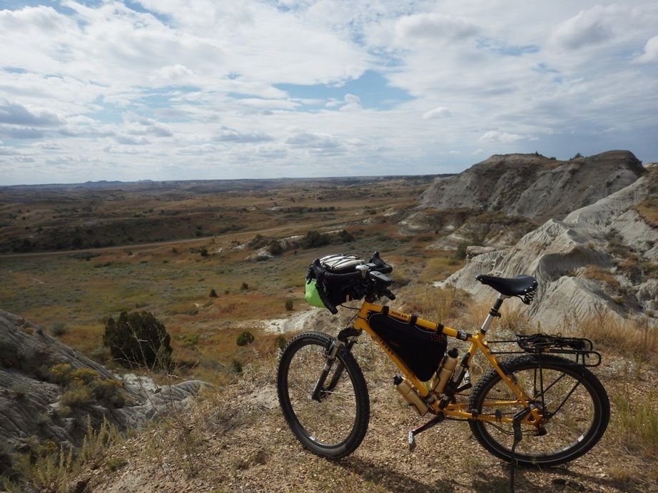

In a similar vein.
Here's a shot of one of my bikes, like Tourist, the frame bag allows one water bottle. I have an oversized cage so I use a Naglene 1.5L. Also, a back rack allows you to bungee a simple drybag to the top but keeps things off the tire. Up front, use a gas tank bag and either a HB bag or double ended drybag and roll it to the size that fits between your bars. That should be enough room for gear to stay indoors.

I know you said you don't like panniers, but small panniers (like Front Rollers or Ortlieb Gravel-packs would give you more capacity than a seat bag. There's even the new category of "micro panniers".
Plus a strap on water bottle holder under the down tube.
You could load up like this bike, but with a smaller handlebar roll:
