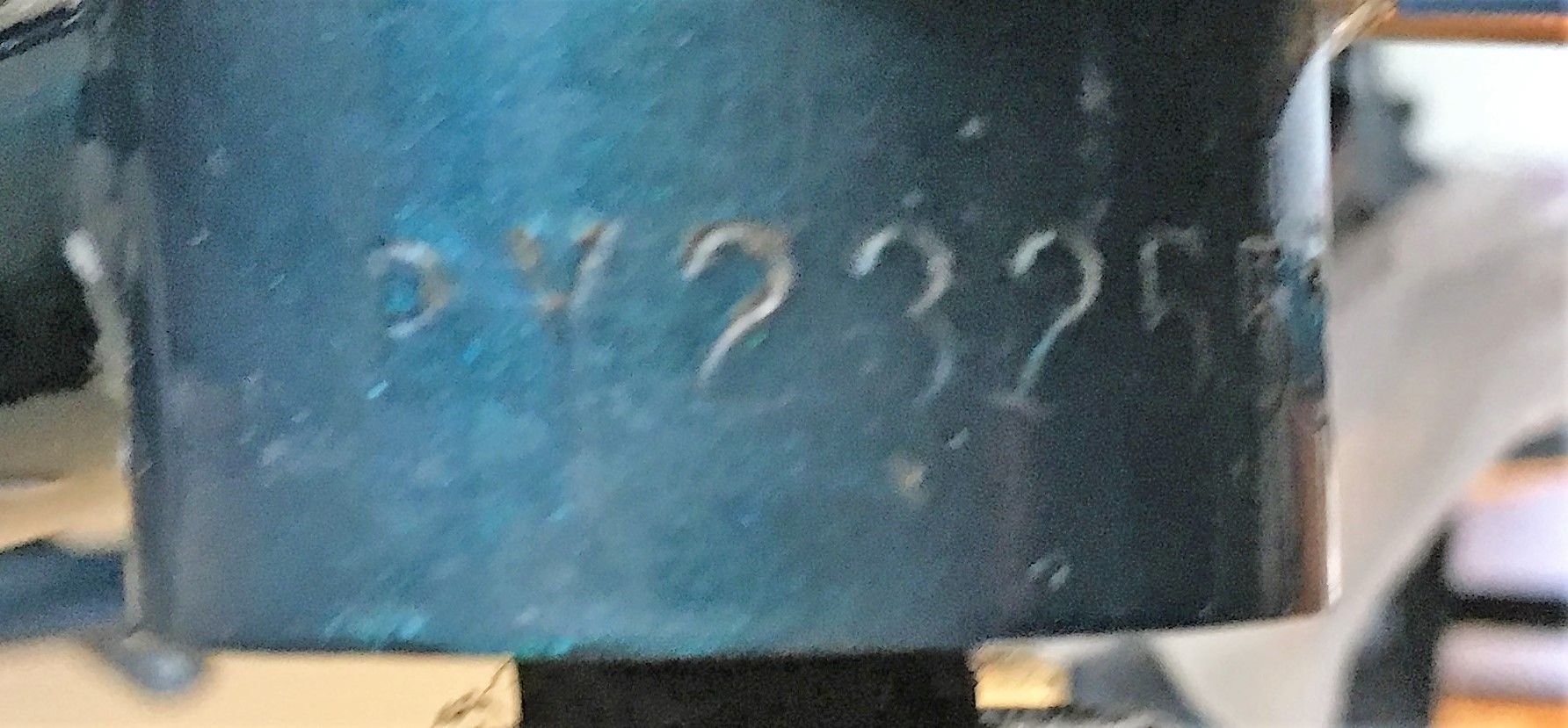

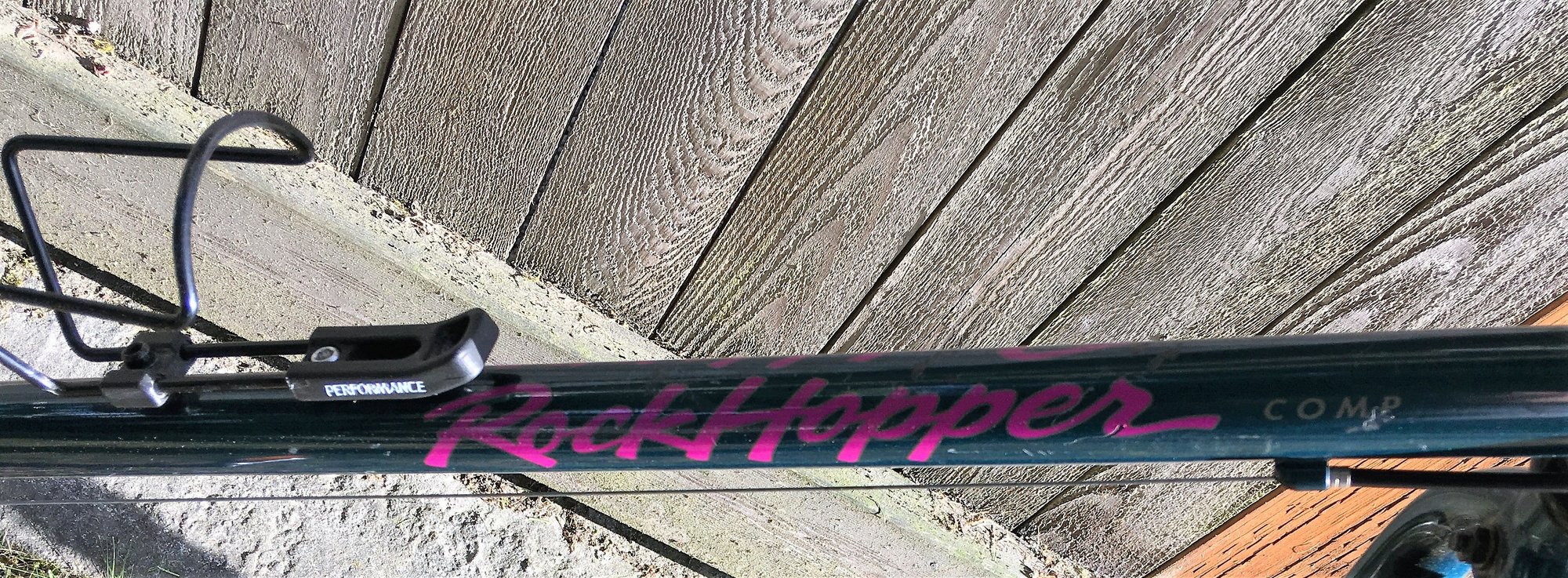

I picked up what I believe to be an early 90s Specialized Rock Hopper, based on the color and decals and the Crank is a Deore LX FC-M560 that velo Base dates in the early 90s. It seems to have all Deore LX components, is a Rock Hopper Comp, and the Serial number on the BB is PY232553 as near as I can tell. @T-Mar excellent serial number guide for Specialized seems to only go to about 1989 (Via Giant and Miayata) and the Specialized website doesn't go back before 2008. Would like to see if I can narrow it down to more than "early 90s"
Not sure if this is a clue but the FD is bottom pull like a road bike not top pull and the shift cables run under the down tube not along the top tube like the rear brake cable.
Thanks
Serial #
Rock Hopper Comp
Thanks
Serial #
Rock Hopper Comp

From the catalogs on retrobike, looks like the '91 was offered in turqouise (single color, no fade). It would not have had that stem; looks like someone tried to make a semi-cruiser out of it.
All the years from that era seemed to have downtube shift cables. Just from the bikes I've seen, top-tube shift cabling seems to be the minority. Or at best, it's an even split.

'93 colors (rose/olive fade, green/emerald fade) don't appear to match. Ryan - is your bike a single turqouise color, or a fade? Hard to tell with the angle of the sun in pic 3. If it's one color, it's a turqouise '91. If it's a fade, it's a green/emerald '93.

The subject bicycle wears 2nd generation Deore LX which was 1993-1994. 1st generation LX, 1990-1992 used silver crankrams and and silver pivot castings on the rear derailleur, However, since it doesn't have the threadless stem/headset of the 1994 model, it should be a 1993 model. The component date codes should corroborate this. Also, the serial number could be reverse engineered to December 1992, making it a 1993 model.

Yeah sorry about the poor picture quality it seems to be one color vs a fade to my eye

SN # PR313590
It has a small black/white sticker that says Taiwan, just below the tubing sticker (same location as on OP’s frame, although his doesn’t seem to have the Taiwan sticker).

Thank-you fellow SBI enthusiasts. The initial analysis, based on a very restricted sample size, suggests that the format may be:
?fyxxxxx, where
f is an alpha character designating the fortnight (i.e. A = weeks 1-2, B = weeks 3-4,... Z = weeks 51-52)
y is a numeral indicating the year (i.e. 1= 1991, 2 = 1993 etc.)
xxxxx is the sequential frame number built within the fortnight.
? is unknown at his time. Given the G & P characters, they could represent different manufacturers or an unknown stratifier for a common manufacturer.
ryansu's frame would be be from weeks 49-50 of 1992, making it late enough to be a 1993, which is consistent with the 2nd generation Deore LX.
droppedandlost's 1st frame would be from week's 51-52 of 1991, making it a 1992 model, as he claims based on catalogue matching.
droppedandlost's 2nd frame would be from week's 51-52 of 1992, making it a 1993 model, as he claims based on catalogue matching.
dueroute's frame would be from weeks 35-36 of 1993, which is in the grey area where it could be either a 1993 or 1994 model, though it colour matches 1993.
The 1993 colour differences from the catlogue may be due to the fact that it's German market catalogue.

Serial number of my olive/rose Comp begins with PY2, like Ryan's. Black 175mm cranks. I have to find my magnifier in order to discern the component date codes. No country of origin stickers. I had the fork out last summer for a headset repack, but don't recall whether the steerer tube bore any CofO info.
Ryan, looking again at the photo in your first post, that does look more like a fade, not just a trick of the light.
