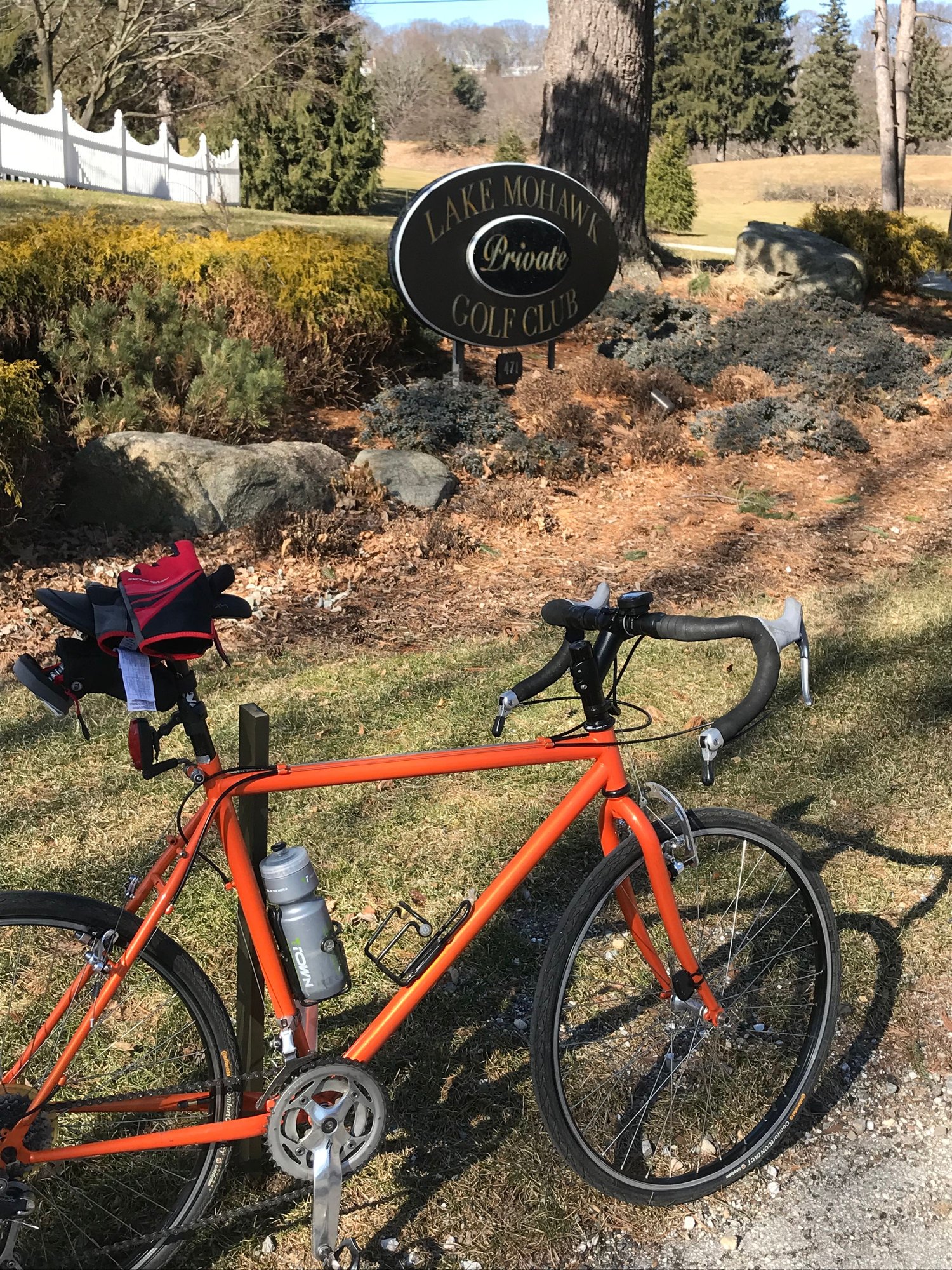

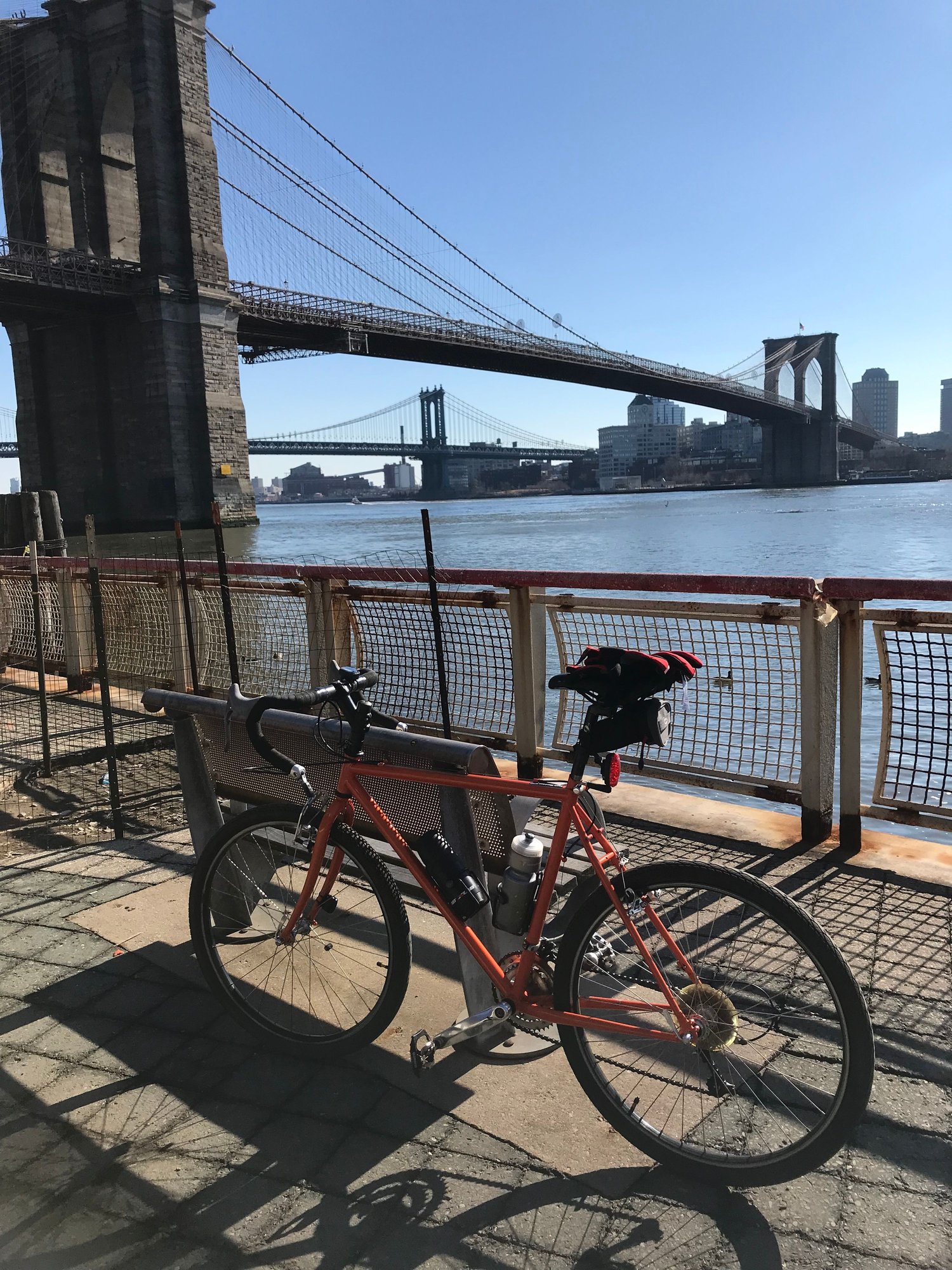

26 inches of fun
Graveler goes to nyc
Lake mohawk NJ
Lmcc golf
