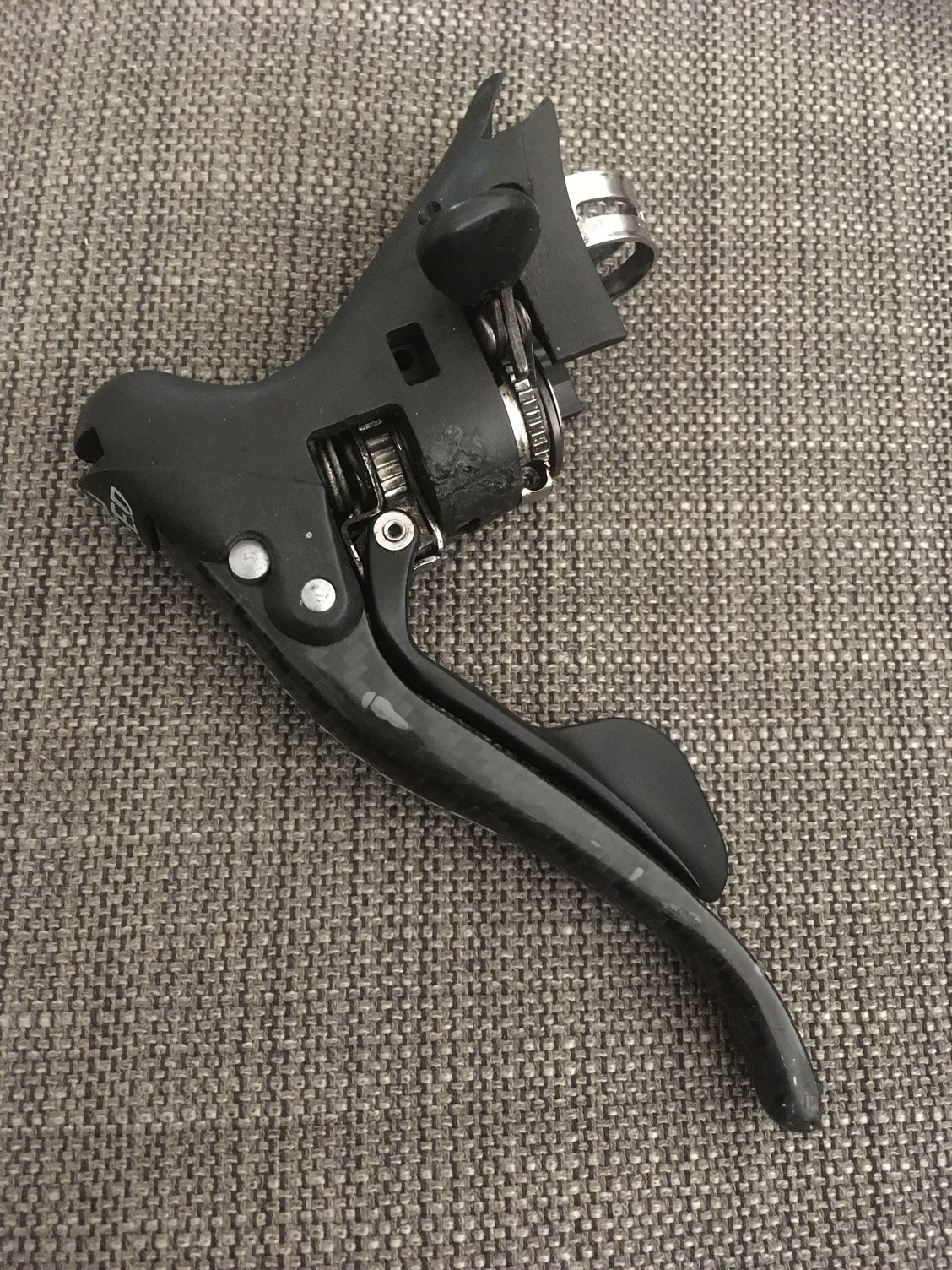

So I've read about the differences between the various versions of ergo levers and I'm still a little confused, mostly about the Ultra shift naming as Campy seem to use Ultra for many different things regarding chains, levers, etc. I realize my lever is pre Ultra but not sure what that means exactly. Am I missing out on Ultra goodness or was it just a slight upgrade/marketing move?
I know mine isn't Escape but I'm not sure between my lever and Ultra. I believe the levers that say Micron, BB, Carbon, and QS are the same as mine, correct?
Here is the lever I have:
Oh, and can the clear coating be repaired? I know it's very common for them to flake but is there a fix or way to prevent this short of a new expensive brake lever?
tNuvolari is offline

Ah, I was just reading an adjacent thread about rebuilding ergo levers and Mr Drew_Eckart shows a complete and thorough description of the internal differences between my lever and Ultrashift. I had no idea it was a complete redesign of the internals. It would seem that the Ultrashift version is much more durable without the G springs and spring carrier that always breaks. But what about the feel and shifting? Is Ultra better, stronger, faster....?

Here is my take on Record/Chorus levers. I have no experience with the other models:
QS refers to the left hand (front) shift lever. Supposedly it makes for a faster front shift with less lever throw. I never used one. BB is for ball bearing pivots in the shift levers as oppose to bushings. All Records have BBs. Ultra has a drilled out index gear and a plastic (carbon?) spring carrier. Also the shifts on the Ultra take a lighter touch. I prefer the ones that aren't Ultra. Also, when they came out, the Pros didn't really care for them either. So, Campy made a run of "Red" levers with a stiffer feel. Those are rare and expensive if you can find them. I have no idea what the Micron is, Carbon/BB was what was tagged on the 8, 9 and early 10 speed.

Sorry for the lousy photos. Buts here are a Right 10 speed ultra and a left 9 speed Carbon/BB.
