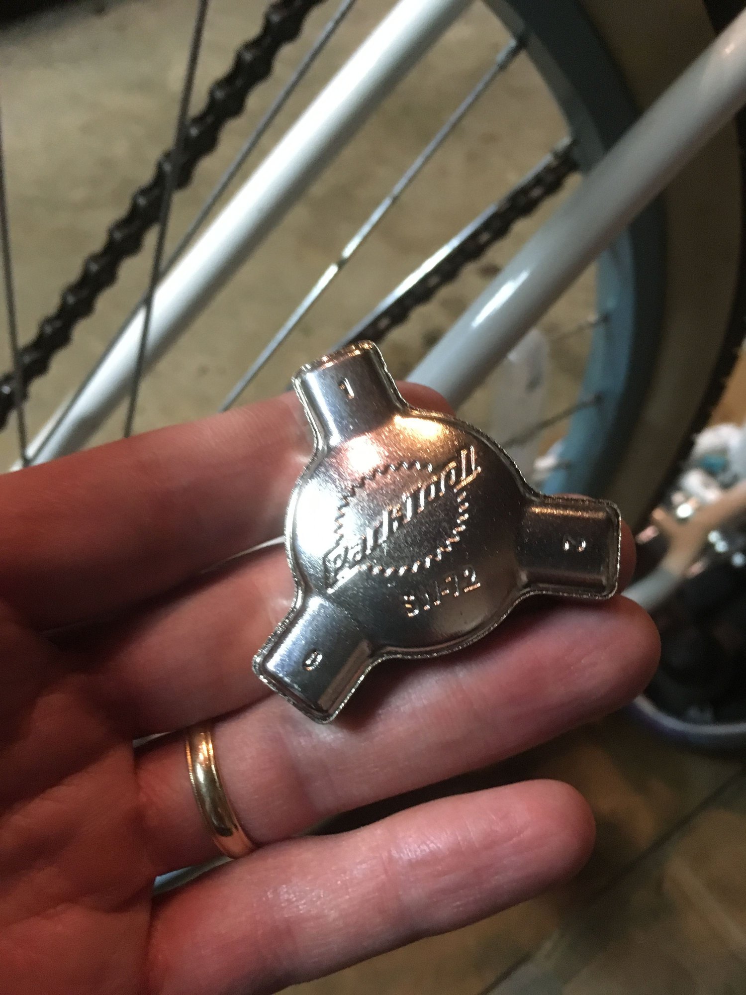

Do at least spend a few bucks for a decent spoke wrench. Nothing ruins spoke nipples faster than using pliers.

Any bike shop should have spoke wrenches or can get them. Jenson USA is a decent online source that I often buy from. I have the Park Tool red, black, and green wrenches, and they seem to so far cover almost every wheel I encounter. Offhand, I believe red and black are the two that I use most often.

I started riding again this year but it's mainly just leisurely jaunts with the family. But all my bikes could stand to be trued. But the first bike I started riding this year had a bit of side to side wobble but it got a lot worse after a few months of riding. Is that typical? It's not a high dollar bike. Just a Schwinn Del Mar about 9-10 years old. But when I looked at it last night I was surprised to see how much it degraded. I tried to true it when I first started riding it early in the year but I'm not sure I did any help. Plus I was using a needle nose pliers and I will buy a proper tool for it when attempting to true it this time.
You can buy them just about anywhere. This one is far better than a pair of pliers. You can find them for as little as a dollar...but as K says, "Spend more than a dollar". The Park SW-7.2 is about $10 and it works very well. I carry one in my pocket at my local co-op for those "on the bike" spoke tweaks.

I have the Park spoke wrenches. If I buy a new one it will be this:https://www.wheelfanatyk.com/store/pk-lie-spoke-wrench/.

I was kind of meaning online. I do not have a bike shop close. They're all over a half hour away and not in places I normally go. I might go down there this weekend though. I was more meaning if someone bought them online, where was the best place. I'll see if amazon has the park tool ones and how much they go for if I don't make it down to the bike store this weekend. Life gets kind of busy and not always able to go to out of the way places. I wish I had a bike place on my normal routes. I'd be in there more often. LOL.

It's good to have one each of the open-ended spoke wrench and one with four corners. The first you use most of the time because it's quicker, and the second one comes out for tight spokes where there's a risk of rounding the nipple.

Well I was really excited. I went to my LBS which happened to be a Trek store and they had some of the Park tool stuff. Being on a tight budget I opted for the tool that has all 3 sizes in one. And that night I worked on my rim and I was so happy to see I made progress!!!! It is a LOT straighter now. I'm so excited.
We were kind of drooling over all the bikes in there but that's sort of another story. I'm trying to decide if I really feel like they are a necessity for us. Ours are working fine thus far. I may feel differently with more miles on them though..... But the del mar that we've been riding since may ever day seems just fine. Besides the wobbly rims. LOL. Even with the wobbly rim that is mostly fixed is still rode alright....

Thank you. I will watch that. I started working on the Schwinn Hurricane last night and I made it a little better but still not perfect. It still rides pretty darn smooth though. Do alloy rims seem to give a smoother ride than say steel ones? I noticed it when test driving cars when I we bought our 2009 Ford Focus. I drove a few models with steel wheels and the ones with the better rims seemed to feel like they rode nicer. Maybe that's the case with bikes too. Because that hurricane feels particularly smooth and it has Weinman alloy rims on it. I did put new tires on it though too. I probably said all that earlier.....
Schwinn tires from Kmart nevertheless. But I like the tread on them.

Notes:
1. Put a drop of light oil on each nipple where the spoke enters it, and spin the wheel to get the oil to work into the threads.
2. The 'heavy duty' steel wheels on the Murray are only there because they are cheaper than alloy rims. They are weaker and heavier and more difficult to fix than basic alloy wheels. They also provide almost zero braking when you try to stop in wet conditions because of the chrome finish..
3. The saddle on the Murray is too low for the person sitting on it.
4. An out-of-true rim is normally very difficult to feel when riding. If you feel a 'wiggle' as you ride it is more likely caused by a damaged tire casing or tire not fully seated on the rim.
5. All other advice given here is correct. I use a zip tie around my seatstay to true my wheels. I remove the wheel and install it backwards and see if the zip tie is at the same place relative to the opposite side of the rim - this is how I check 'dish' (how centred the rim is between the outer lock nuts on the hub) without a single purpose 'dishing tool'.
