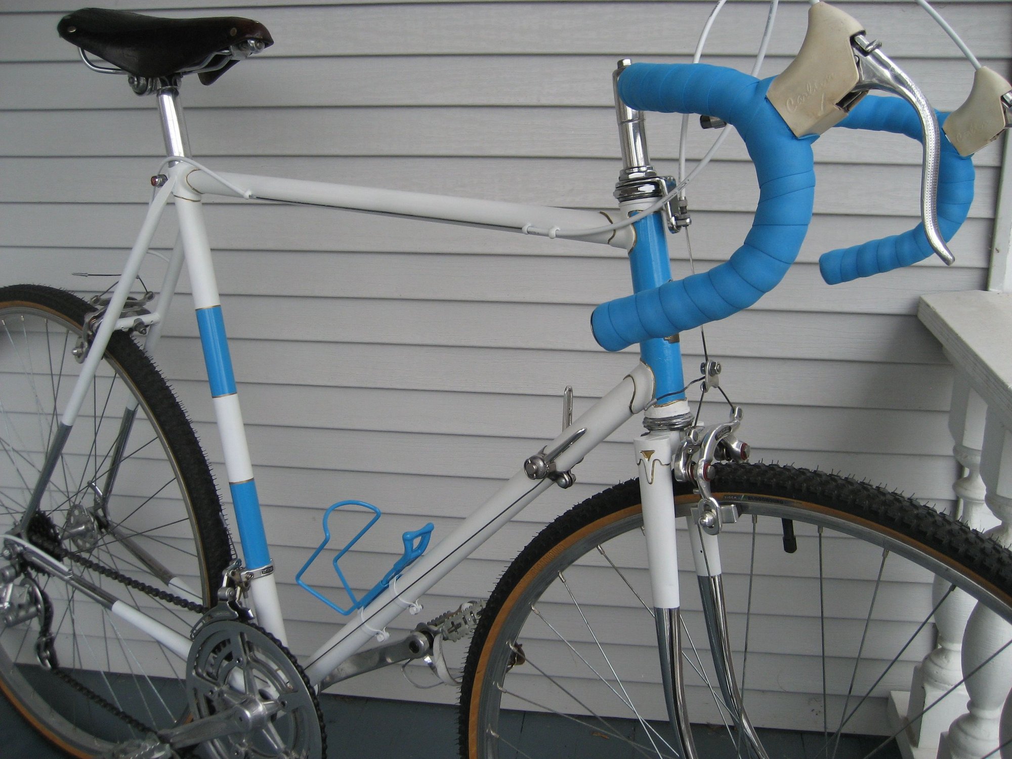

Here is my pathetic try with a pin stripe brush . I kept telling myself "just get a Sharpie". I'm not good with decals either .
DSCF2579 by mark westi, on Flickr
DSCF2589 by mark westi, on Flickr
DSCF2578 by mark westi, on Flickr

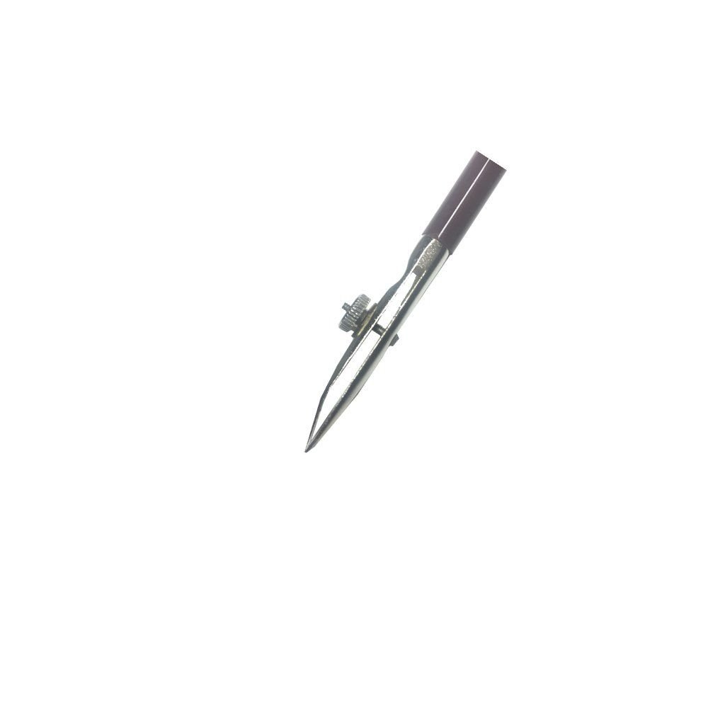

This is what I use for lug-lining work. Makes for nice, thin lines. Very accurate, little to no slop.
https://www.amazon.com/gp/product/B0...?ie=UTF8&psc=1
Which paint or ink do you use with the ruling pen for bicycle work?

I am not clear how this is used. How do you get paint into the pen? what kind of paint do you use? I would think lacquer would dry too fast. I would love to do some lug lining on my paint jobs. Tried to use a paint pen once but the line was much too wide.
Brent
I use thinned enamel. Getting the consistency right takes a little work - too thick and it won't flow, too thin and it runs. I came across the idea here on the forums awhile back (https://www.bikeforums.net/classic-v...triping-2.html) and had used ruling pens before so it worked well for me. For lug and lining work I really like that I can adjust the line thickness and lay down a dense coat. Haven't done it in awhile and those bikes are gone, but I have a Raleigh DL-1 build I want to get to soon so it'll be time to break out the set again.
@capnjonny, I just dip the quill in the paint and wipe the excess, the paint pools in the space behind the nib. Pic of it here:
https://www.velo-heaven.co.uk/produc...s-restorations

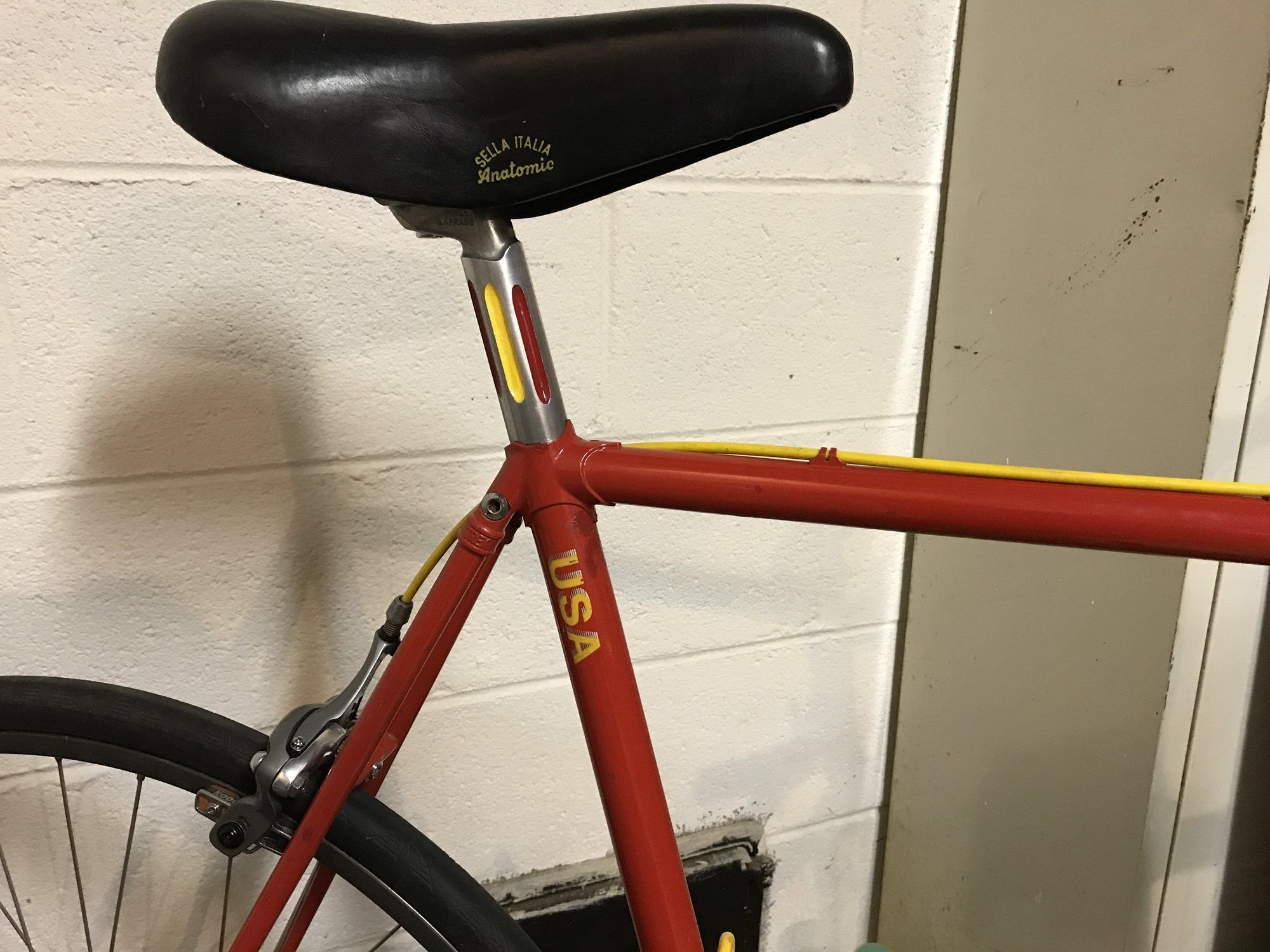

I did this to my Norther yesterday! It turned out surprisingly great and, assuming it doesn't hold up, I'll do it with real paint over the winter when I take the bike apart and clean it properly. I'd post photos but I'm too new, though you can see a teaser shot as my avatar!

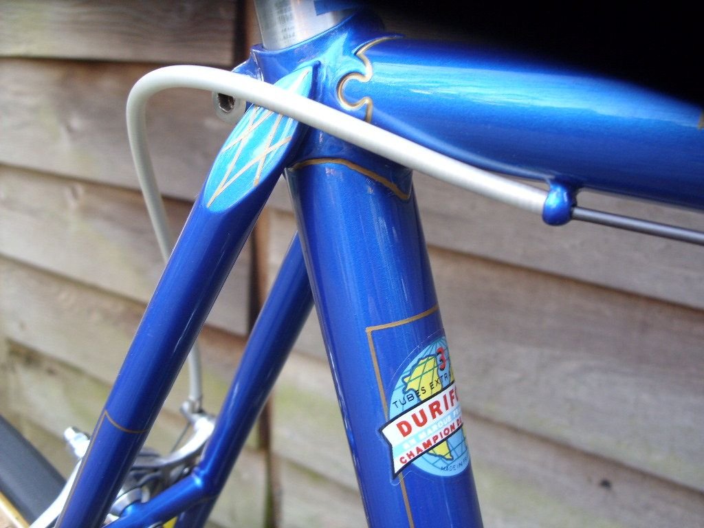

Old 05-21-19, 12:45 AM
Duke7777
Location: Vancouver, BC
Posts: 236
Bikes: 48 Alleluia, 52 Blondin, 57 Cattaneo, 68 CNC, 55 Dujay, 46 Herse, 76 Singer, 48 LeGreves, 55 Metropole, 62 Holdsworth Cyclone, 49 Carpenter, 55 Condor, 65 Masi Special, 81 Sequoia, 76 Eisentraut, 72 Proteus, 60 Paramount, 77 Trek TX700, 82 Ross
Quoted: 79 Post(s)
Liked 137 Times in 55 Posts
Originally Posted by Senior Ryder 00
Has anyone successfully used Sharpie extra fine point oil based paint pens for doing lug lining & fill-ins on cutouts/pantos? Also, how about the use of the wider points for touch-ups?
For lug lining and box lining these work great. Here is my early 50s Metropole:
That is nice work.
