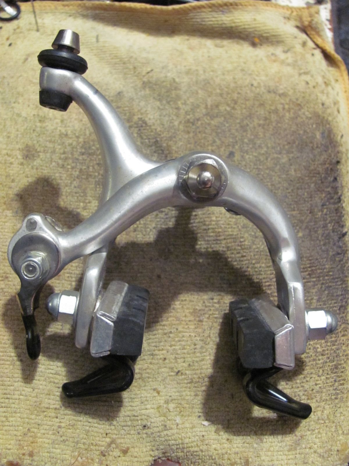

Can anyone tell me who made this brake caliper and perhaps about when it was made?

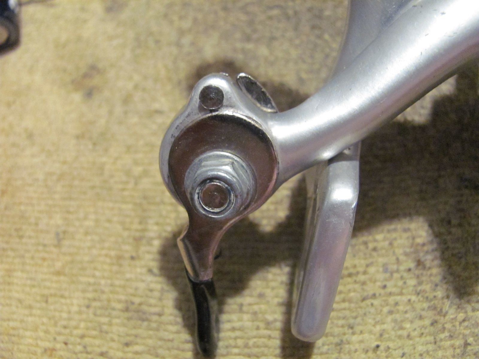

I need to rig up something to hold the brake cable. I have a couple of adjusting barrels that'll fit at the top but I have no idea where the cable retaining bolt and nut went.
I also have the other brake caliper.
Thanks and cheers

It looks like a Suntour aka Dia Compe brake. Maybe a Sprint?

Yeah looks like a duller finished version of some Gran Compe 400ís (I think) I have.

I don't recall Sprint having the small pin above the quick release mechanism. Offhand, the only brakesets I recall with this feature were the Dia-Compe GC500 and NGC 500.

I thought they were Shimano generics at first, like the 600s (6208). Are there any markings on the back?

Unfortunately there are no markings at all on these brake calipers.

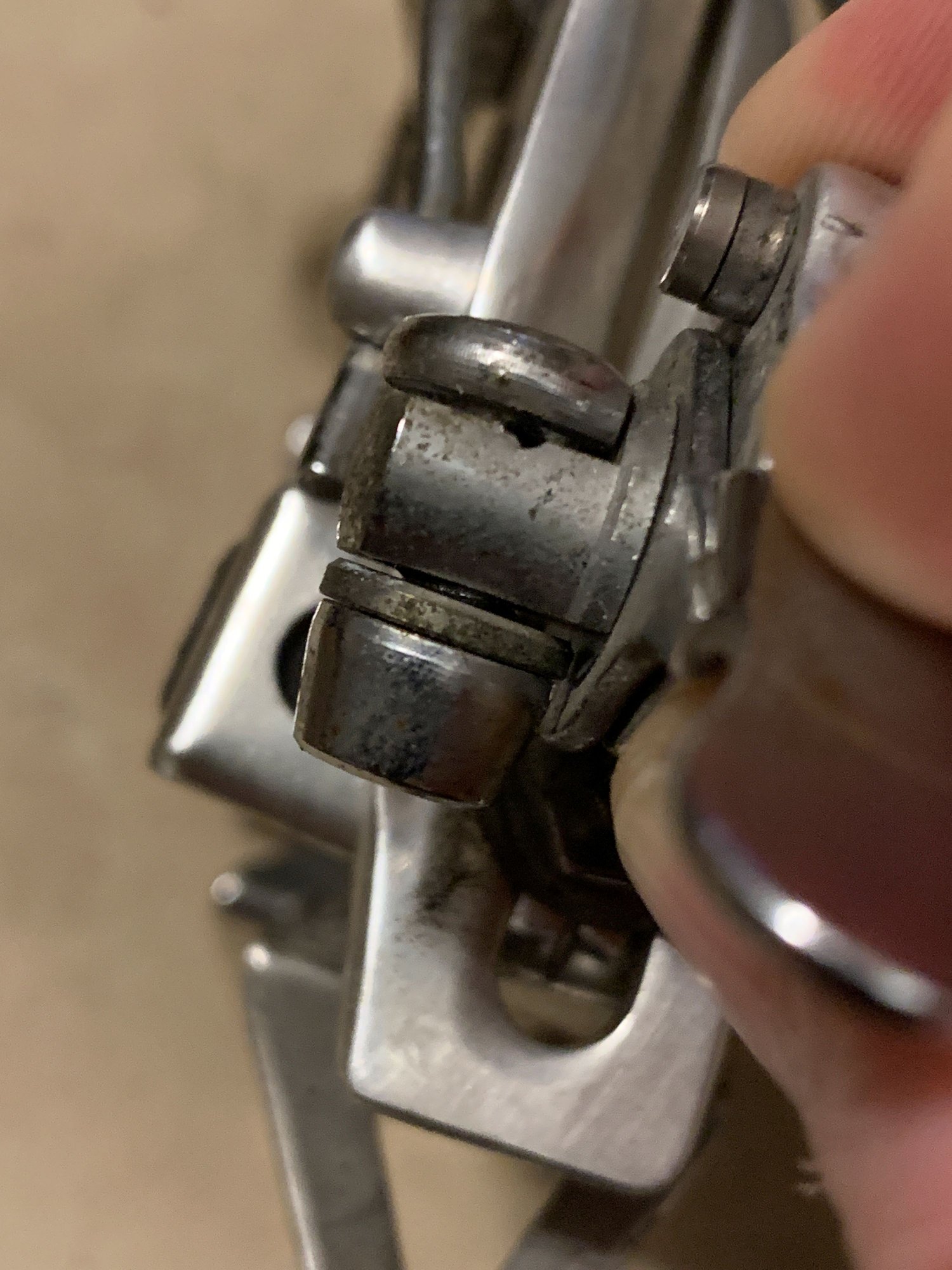

The only markings besides the Gran Compe on the quick release is a 5 on one caliper, a 6 on the other.

Thank you VERY much for those images of the cable anchor. Now I know what to look for or how to make something that'll work.

I bought a set of brakes like these a few years ago and asked over on Classic Rendezvous. I think the conclusion was that they were Chinese Gran Star - a Dia-Compe knock-off.

@natterberry has NGC 400 or 500 brakes. OP's are something different possibly a clone but I've never seen that quality out of China from the 80's.

I can see it. It seems out of Dia Compeís wheelhouse to not throw their name on at least once.

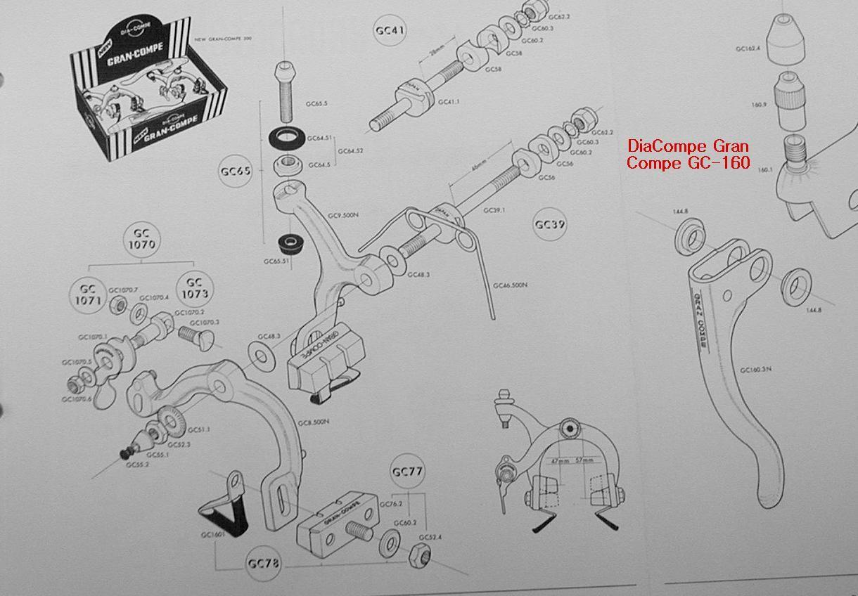

For anyone interested in this. I just found an exploded view of the Suntour RGC80 brake caliper that looks just like the ones I have.
Thanks for all the help.

Do you happen to have that full document? I bought the 160ís on the right along with my calipers.

IF they have no markings on there not Shimano or Suntour, So considering the nice quality likely late 80's Sram or Mavic.

I saw a couple of other posts after I posted the exploded parts diagram but now don't see those posts. Weird.
In one of them someone asked if I had the complete document. Here's the link to the page where I got the diagram. That page has many diagrams of various Suntour brake calipers and brake levers. I hope it helps.
DiaCompe Gran Compe / Superbe Superbe Pro Brake Small Parts at Yellow Jersey

Just to be pedantic, your brakes don't match the exploded diagrams. NGC's always had black rubber pugs in the brake nut. Lesser models, no.
Still congrats on the score, they look like fine brakes.

Seeing as there are no markings at all on the brake caliper arms I think it's safe to assume that these are knockoffs not the actual Dia Compe product.
They do have very strong springs though. They'll work fine for what I want and at an excellent price.
