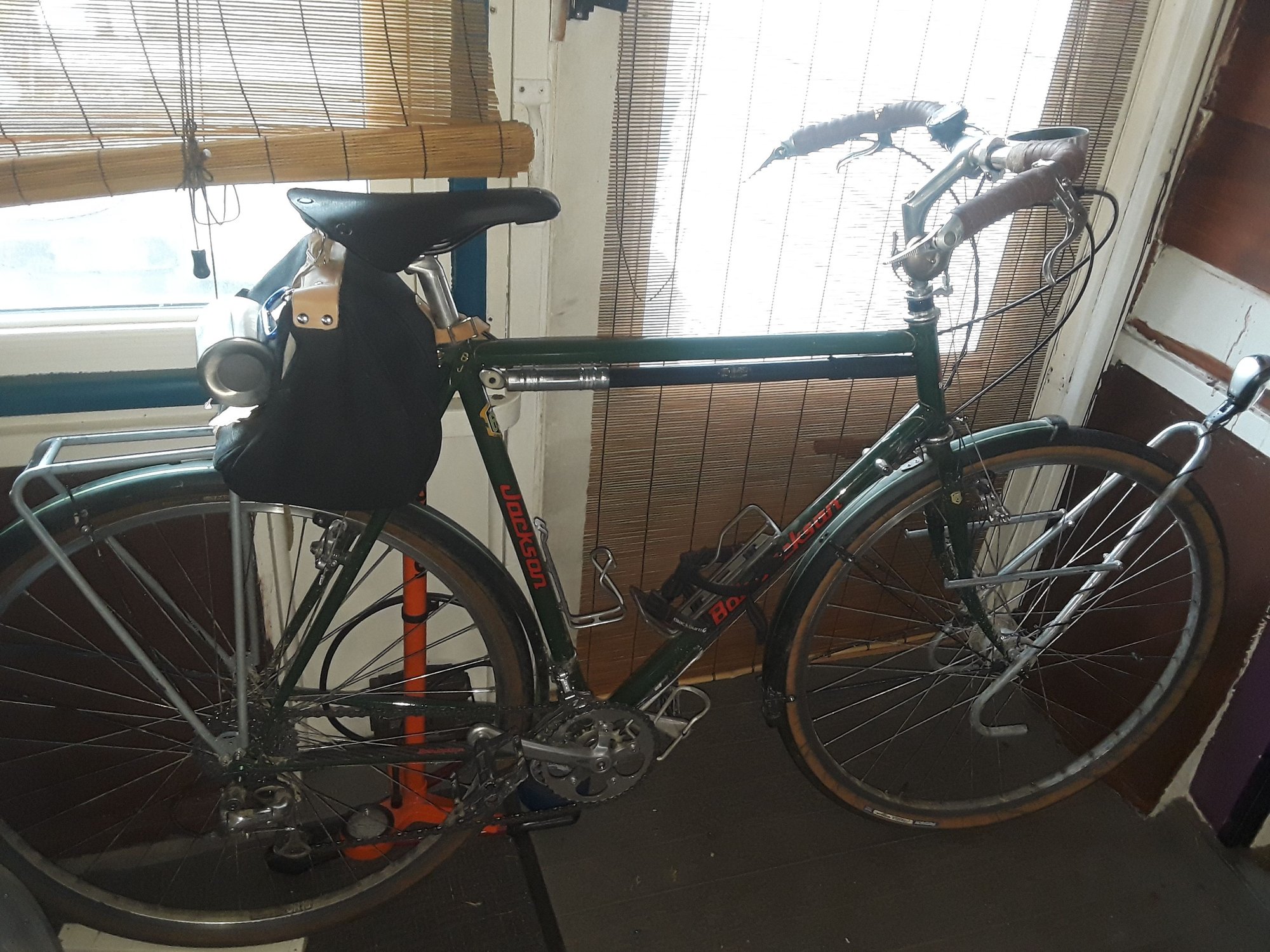

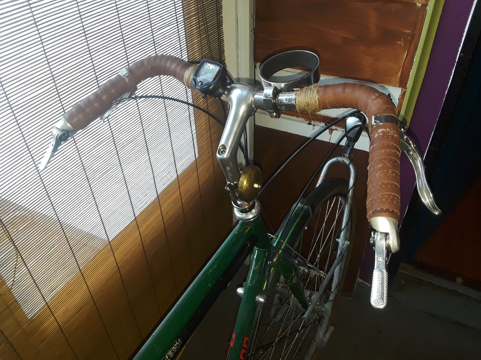

Portuer bars and dirt drop stem. Lousy pic.
Love your bike! I know you've gotten over the mustache bars but i will just say i need them close and inverted for rise. Curreny i enjoy portuer bars a lot. Being an old man i want them with plenty of rise which is why i use dirt drop or technomic tall stems. Your bike takes a smaller diameter stem i think but there are many ways to get there.
Ride on. Welcome to the fold!

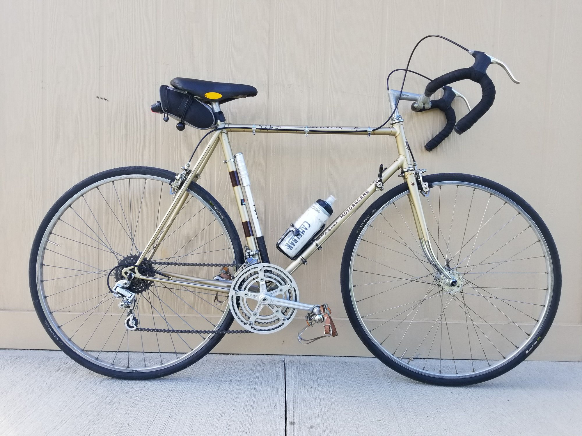

@Demet like those latest bars and I am a fan of Motobecane's, their 23 inch frames fit me very well as I too have a long torso for my frame. As for wheels I will throw out that Swift (Panaracer) makes a very nice 27 X1 3/8 tire that I use on my Nisihiki cresta GT, it's roughly 35 mm width and gives a nice plush ride, that would allow you to keep your wheels and brakes as is. Its called the Sand Canyon and someone on BF recommended it to me. Panaracer also makes a 27 x 1 1/4 pasela (roughtly 32 mm) that is nice and supple. Good luck with the build and enjoy the ride.
My 78 Moto_GT with Panaracer Pasela's in 27 X1 1/4
Thank you, I like your tires, and could see going that route, but what I'm hoping and need to confirm, is that 700c wheels will buy me a little more space for a little bit bigger tire, and fenders. The limiting dimension seems to be at the chain stays, close to bottom bracket (not sure about nomenclature). There's a sort of indentation on both chain stays there, and it looks like slightly smaller wheels would help maximize the possible tire size there. Any advice on how to confirm this? I guess I need to figure out how much smaller a 700c wheel is, and the actual width of a tire I might want is.... Yikes, it seems iffy haha.

Originally Posted by Demet View Post
Thanks for this info. I'm definitely thinking about a different stem, and these look like they could work for me. There are just so many variables I'm having trouble deciding what to try first. I'd love to see a nicer picture of your bike it looks nice. But no worries if it's a hassle.
DG
The stem im using here is an uno. Its a cheap knockoff of a nitto dirtdrop. The bars are portuer from v.o., the brake levers are cross bike interrupt levers.
52telecaster is offline
Thank you, looks great, I'm definitely going to get a stem like that!

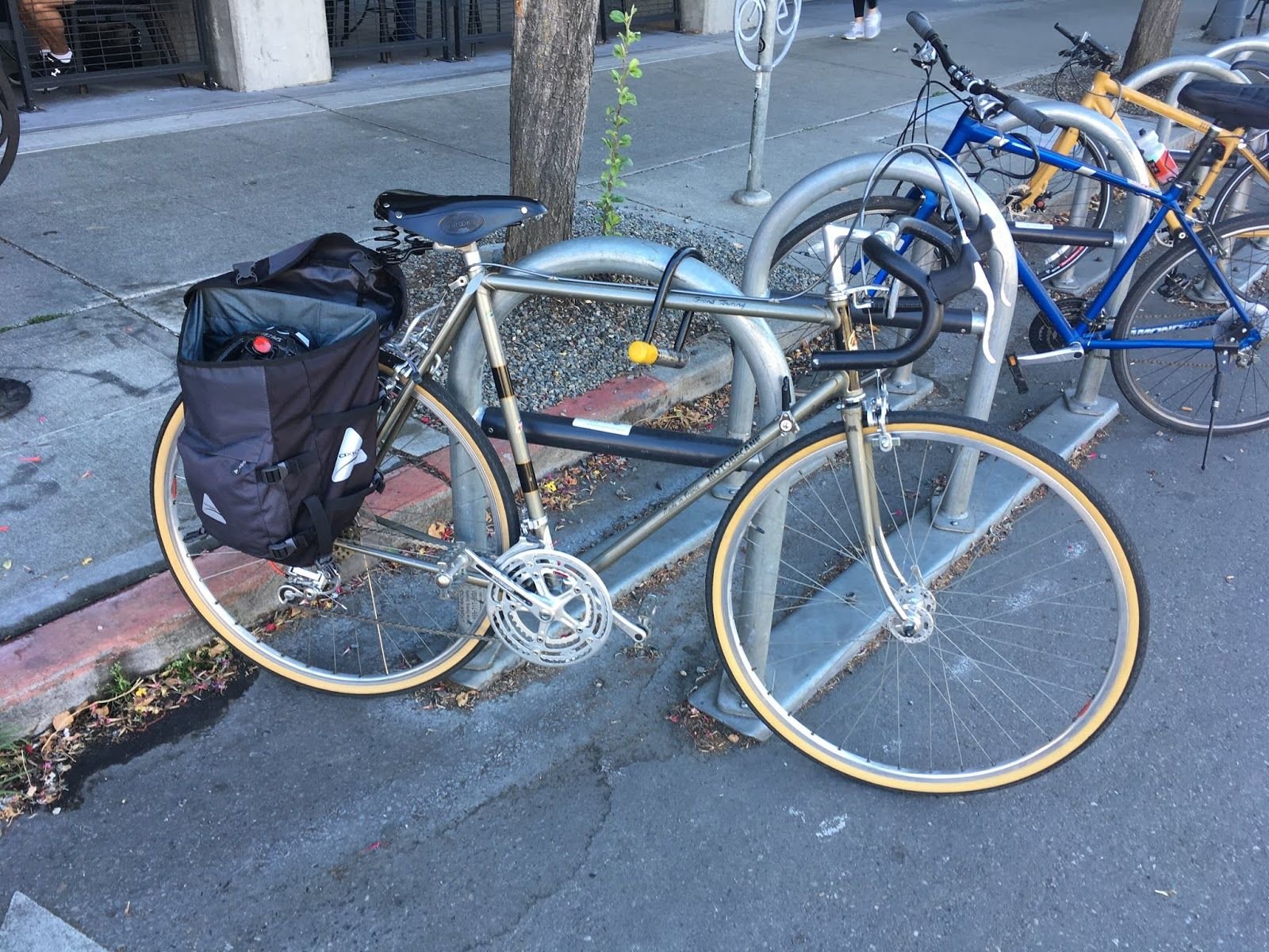

Here's the current state of my bike. I have new brake levers waiting to install. Also have a wheelset recommended and ordered by a LBS, I was going to have them install them, but the guy wouldn't use the parts I had already ordered, brake levers and cables. So I need to do it myself, will be starting today, and feeling challenged by not knowing how all of it works, but here goes nothing ;-)

Take it slow @Demet, be prepared to walk away if it gets to be too much and you feel like reaching for a hammer (ask me how I know) lots good info on the web - Check out RJ the Bike Guy on You Tube, Sheldon Brown's site is great and some above already pointed you to Randy Jawa's Mytenspeeds site. Park tool also has some great videos. I also have found vintage 70s and 80s bike manuals for dirt cheap an Amazon if you want a more analog reference. I really like Zinn and the art of road bike maintenance and Richard's Bicycle book gets good reviews. And of course ask here or search the forum. The nice thing about doing your own maintenance is that not only does it save you $$ in the long run you get to amortize that lovely new Park work stand you bought ....
