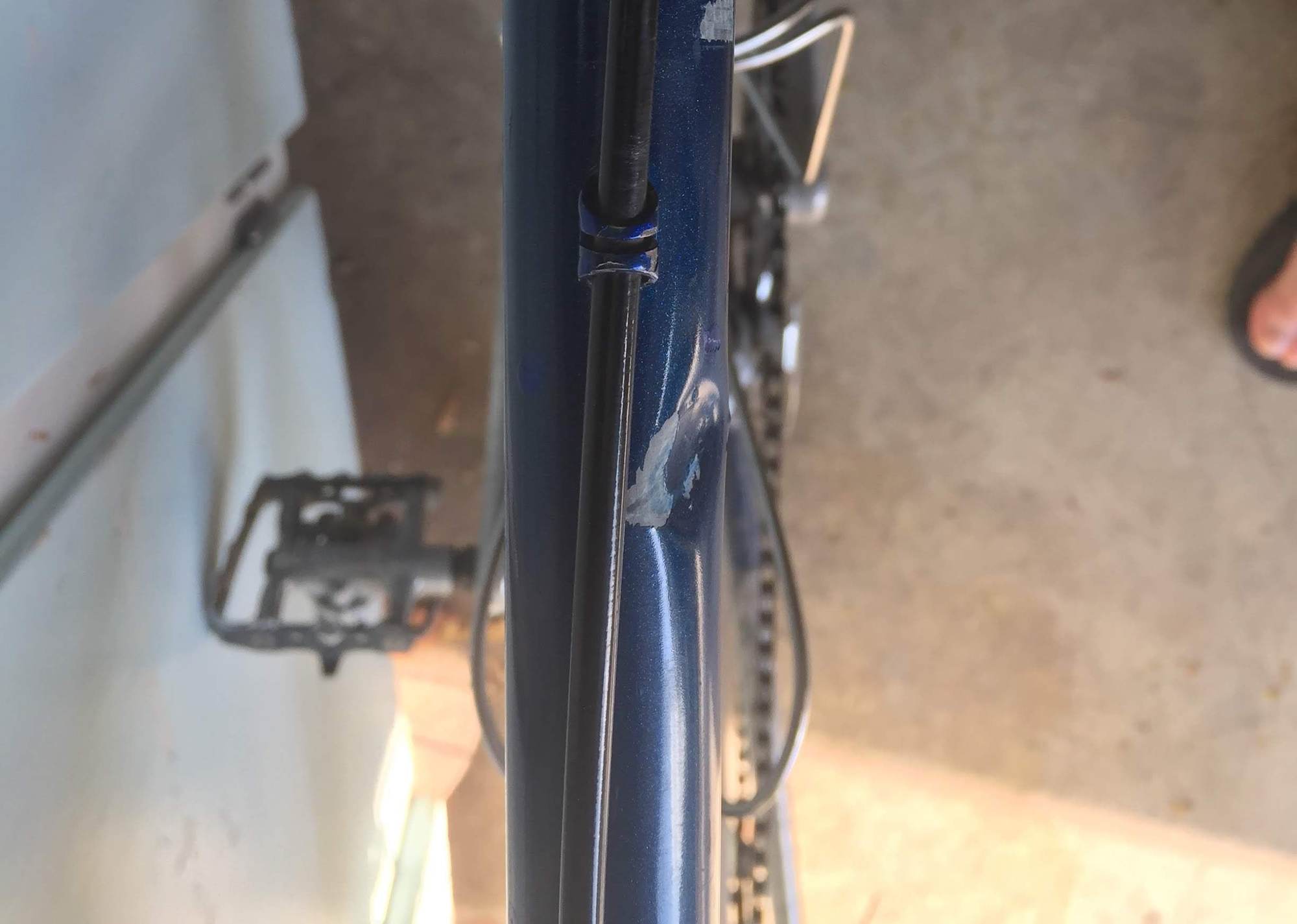

Sadly, this isn't a happy post. I don't think this one will buff out...
I've tried to teach my family how to park a bike safely without it falling over, but apparently poop happens. My wife leaned her bike against the opening of our chain link fence gate and ran inside for a moment; the front wheel must have turned allowing it to fall over on the drive side, smashing the top tube into the lower gate hinge. Thus ends the life of a USA-built 1981 Trek 710.
Serendipitously, I just picked up a 610 frame for her to try out low trail so I can just swap everything over. I guess if she doesn't like low trail, at least she has a mid trail fork as backup now.
I remember seeing a thread somewhere about using two blocks of steel radiused to the same diameter of a dented tube and working them around the tube to remove/reduce dents, but I'm worried this is beyond that.

Huge bummer.
Is it steel?
If so, coming from a car background, I wonder if a stud welder gun could improve that ding. It didn't take much to put that ding in it, so it wouldn't take much to take it out...
Maybe stop by an independent shop and see if they can take a few pulls on it? Maybe worth throwing $100 at if the bike is a keeper? It will need some finish filler and paint, but it already does....
or try it yourself? Might be a fun project.

Originally Posted by Ottomotion View Post
...I wonder if a stud welder gun could improve that ding. It didn't take much to put that ding in it, so it wouldn't take much to take it out...
It is steel. That's an interesting option, I've got a few friends that weld. I'll ask. I would love to keep the frame - my wife has loved it and they're not making this model anymore
I'm sure some will disagree, ugly is not necessarily scary. Looks to not be torn or cracked, very likely this can still be ridden off into the sunset as is. Bondo it, braze it, fill it, whatever. The stud welder will make a mess if the ding doesn't want to pull out as I suspect would be the case.
Devastating, yes, life threatening, not likely.
My wife rode it to work without even noticing. I discovered it while putting it on the car's rack in preparation for our first ride in GNP. It felt like a gut punch seeing it and I can't deny getting upset... but no divorce was threatened . She rode it without incident. The frame still seems straight and she can't detect any differences..
This is what I think the best option would be:
But that dent is pretty large...
Huge bummer.
Is it steel?
I wouldn't use a Fitz-A-Dent to pull that ding. I've thought about trying that myself, but the spot welding process heats the metal more than I would be comfortable with for these special lightweight tubing formulas. You would also need to use considerable finesse to pull that contour out, without making things worse.
The aluminum straightening blocks are pretty cheap, and worth a shot for this in my opinion.
They can be found by scrolling down on the frame building parts page here.
They can be found by scrolling down on the frame building partss page here.
Agreed. I was just on that page!
https://www.youtube.com/watch?v=JTDeXG0kweA
Probably won't hurt to try, but that ding is deep and concentrated, I'd be surprised if the blocks worked very much at all. I would Bondo or steel filler it, touch up and call it a day.
Yes, I agree. Roll it out as best you can, to remove any high spots around the area to be filled. Then JB weld and sand/feather.
Yes, This might require refinishing for an invisible repair, but IMHO this frame would be worth the effort.
This is just the kind of work frame guys like Andy Muzi @ Yellow Jersey do very proficiently. And they can often tell a lot from enough photos, sharp and clear enough, from enough angles. I'm not familiar with the builders out your way, except possibly for Mark Nobilette in eastern Colorado.
Indeed, a dent like that will not affect the ride, and may not affect the longevity.
