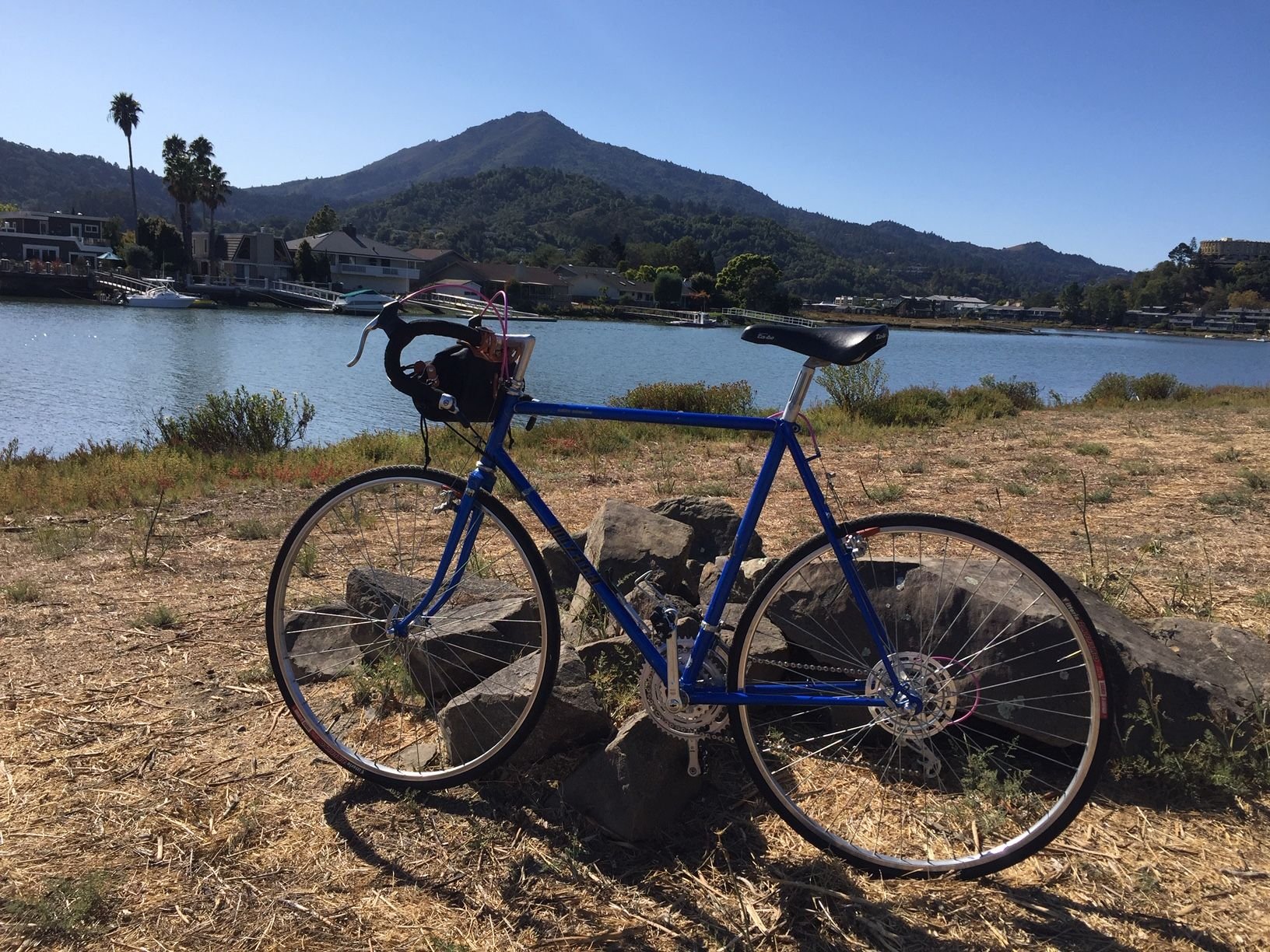

I thought this might be a fun thread idea. Maiden voyages (aka shake down rides) are usually exciting. The new bicycle that you have been slowly putting together, sometimes for months, is finally ready for a ride. Those rides can go perfectly, boringly well. Sometimes small things happen... Handlebars rotate forward, the fork shudders, the chain skates. I bet sometimes, they are disasters! Tell me about yours!
This is also a nice opportunity for me to show off my newly finished Melton. Perfectly boring maiden voyage. The shifts were crisp, bearings proved to be well adjusted, the cables stayed tight. Very nice!

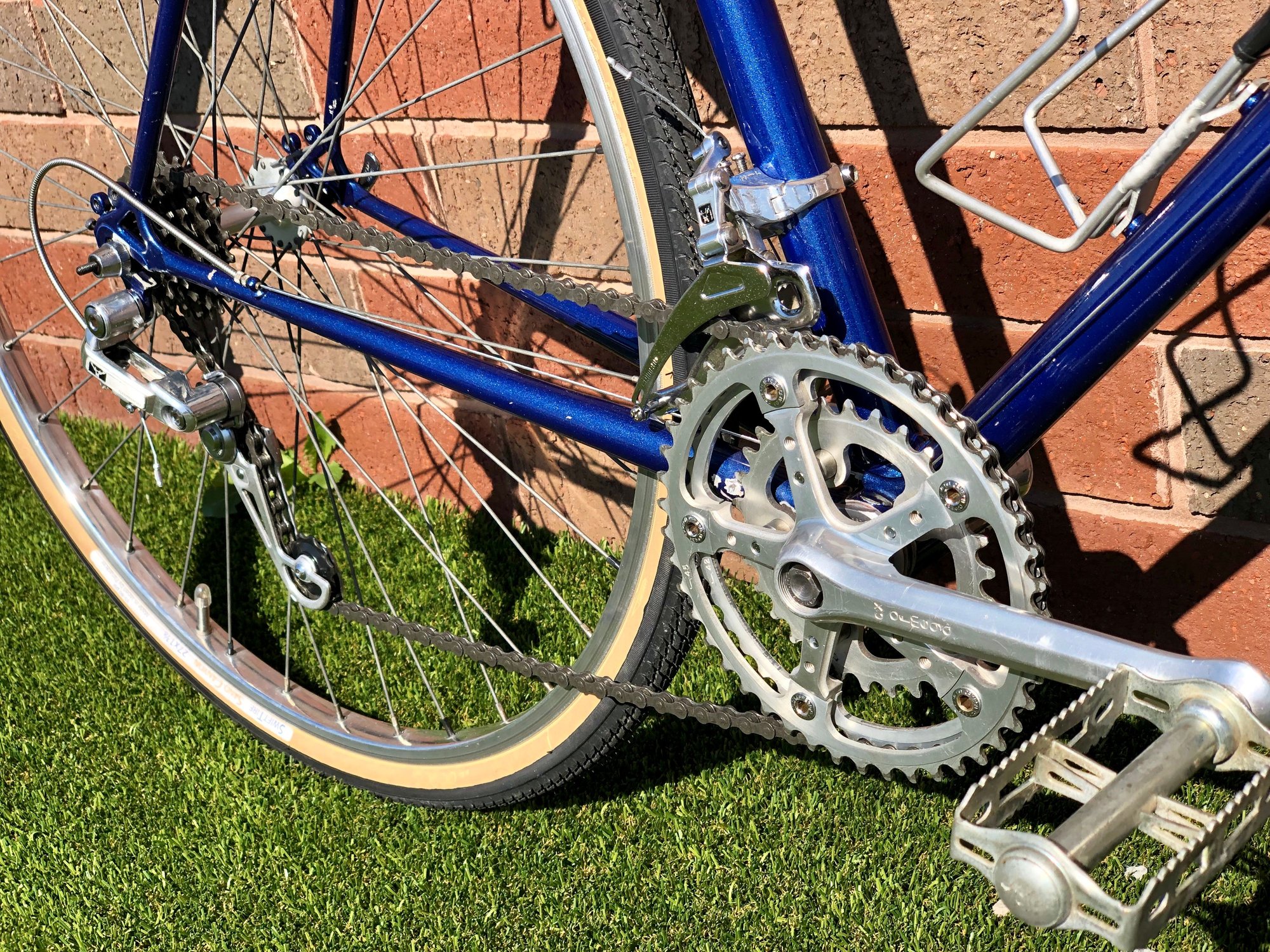

Nice, what size are the chain rings? I rebuilt a bike for the first time last spring. Fortunately, everything was smooth, no problems on the first post build ride.
Rustbelt Rider
I'm not sure what size the chainrings are, but they are super small. The bike is actually a very weird build and will slowly change over time. The main point for me now is that it is rideable in its current state. I put a small ATOM freewheel on the back because if the small chainrings.... which looks really weird with the long cage deer head RD.

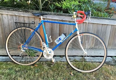

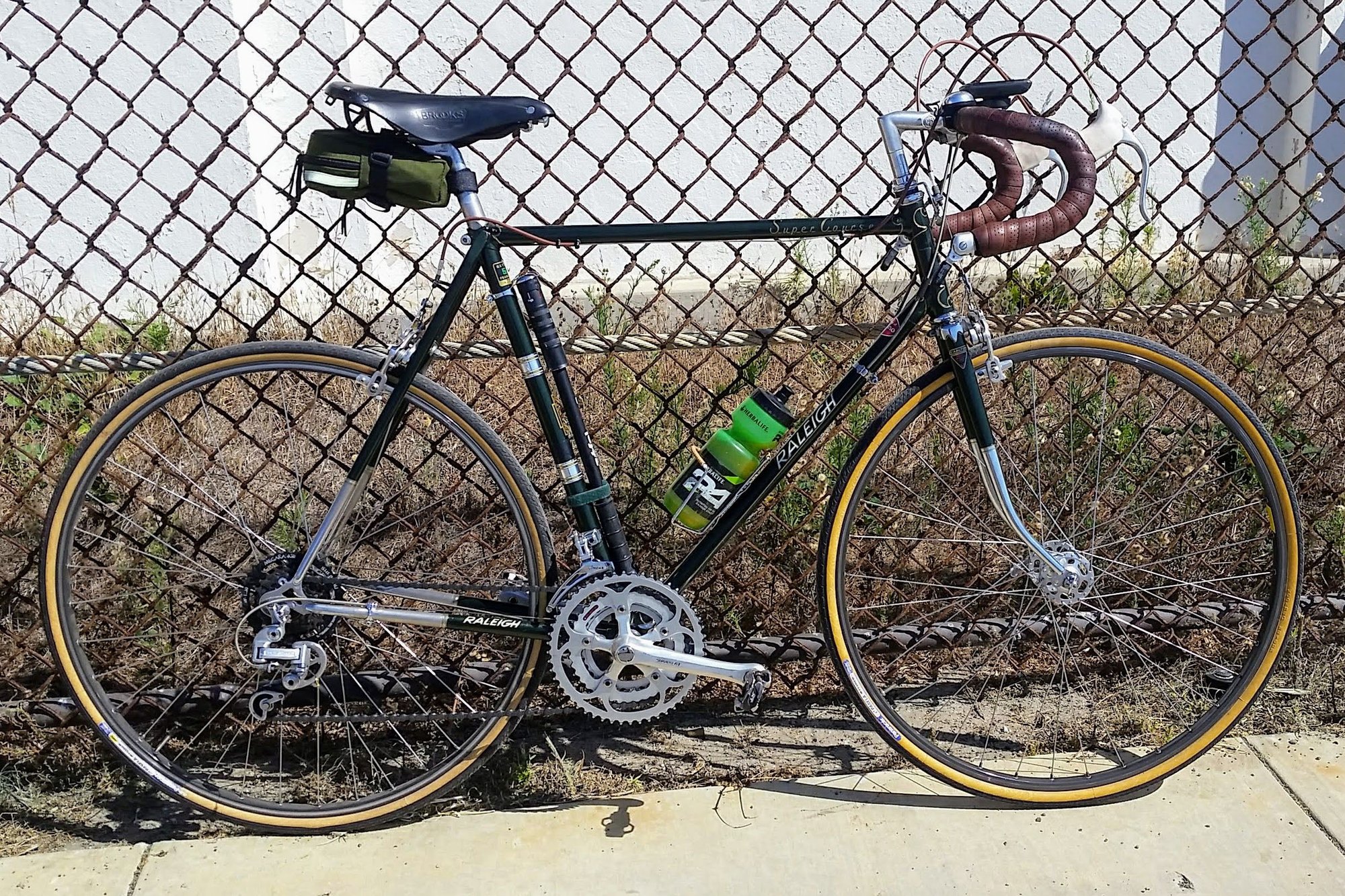

On my first ever bike build, a '73 Raleigh Super Course, it all went amazingly well. I stripped the ugly green spray paint, and built it up on the stripped and unpainted frame to check fit, and ride quality before committing to paint and decal $$$. In my haste to make it to the Pasadena Vintage Ride, I re-used an old 10 speed chain that was laying around, including re-using the old link pin. About 4 miles into the ride, the drivetrain locked up solid. It took me a while to realize that the old link pin had come loose, followed the chain around and jammed in the jockey wheel on the Suntour VGT Luxe. I started walking back to the car, but saw a medium sized rock by the side of the road. I used it with the flat side of an open end wrench to push the pin back in place. I rode the 4 miles back to the car very gingerly. The rear hub also had a growley wobble which proved to be needing a cone adjustment. When I got home, the new chain arrived from Amazon.
I enjoyed the ride so much, that I decided to spring for paint, decals ... and a new chain.
This old Raleigh is one of my favorite rides.

Those Ofmega/Avocet cranks are 144/74- I think the other holes are 102.
