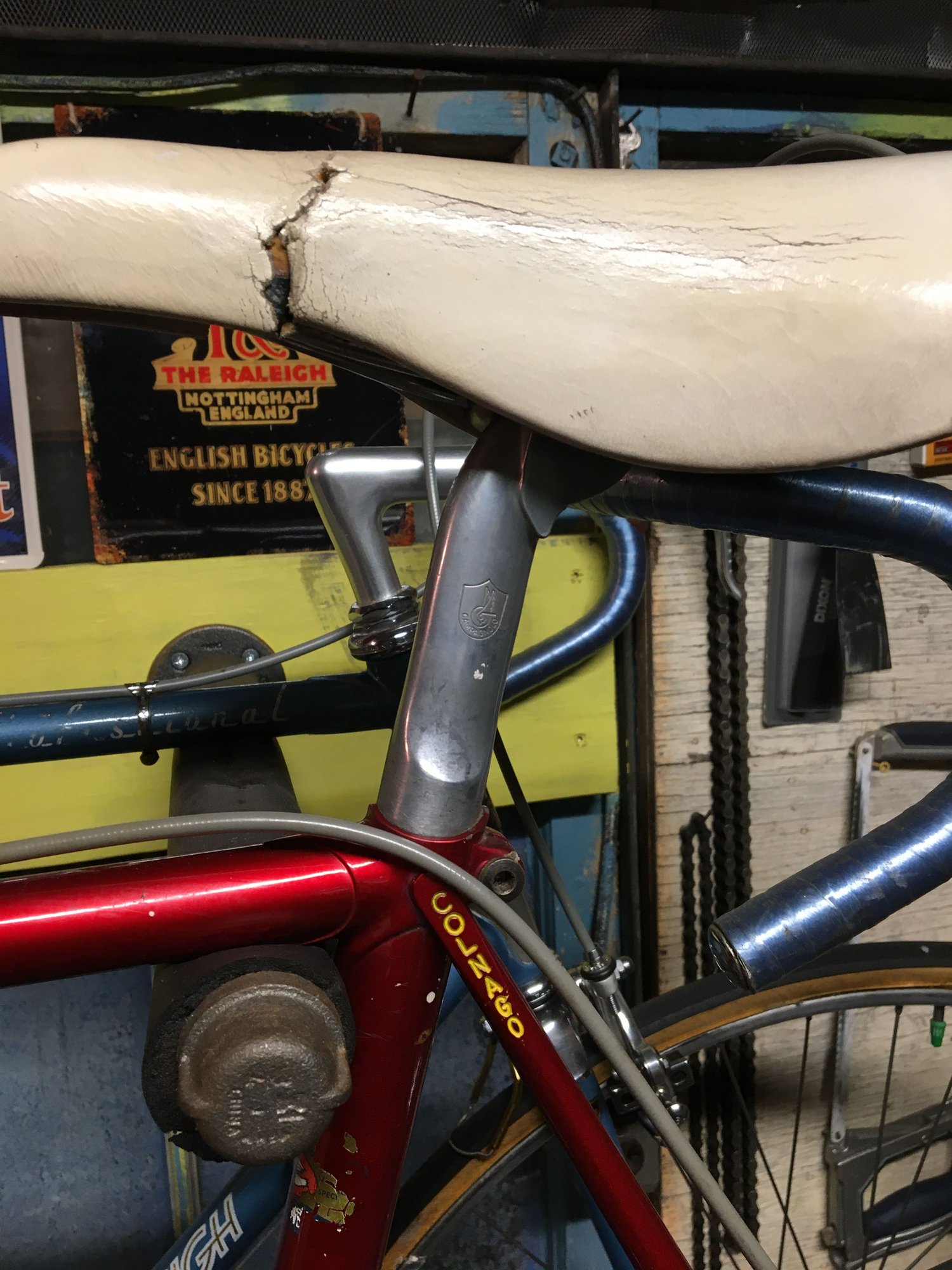

Hello all. I picked up this Colnago yesterday evening. I wasnít in the market for another project, but it was my size and local...so of course I felt compelled to at least check it out.
I know Victories arenít super collectible Colnagos, but like all my bikes, I was interested in a rider. Itís in pretty good shape (one owner), needs a new saddle (cracked), new cables/housing, a good cleaning/lube.
The couple I bought it from were super nice, the husband had bought it new. Lots of discussion about bikes, cycling history, and rides he had done...which to me makes the price of admission all the more worth it.
It included the original Ambrosio extra elite wheels and Maillard freewheel, along with a new set of unmounted Michelin Lithion tires, and a couple of jerseys.
Any thoughts on bar tape? I was thinking white or black and a new Turbo saddle to replace the Vetta.

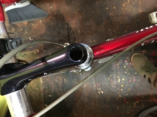

One more thing. Iíve never seen a super recessed bolt on a stem before, was this factory with an additional cap? You canít tell from the pic, but the Allen bolt is way down there.

Shimano 600AX and Dura Ace AX also had deeply recessed stem and handlebar binder bolts. They had a screw on stem cap that screwed onto the top of the stem.

Lots of stems from the second half of the 80's and later, had recessed bolts like that on them and usually had a plastic garnish cap (usually with the stem's brand on it) friction fitted over the hole or into the Allen bolt socket below it, to finish it off.
The caps usually end up getting lost by it's owner, and you end up with a recessed.bolt look like you have on yours. A quick fix would be to buy a few washers of the right size that you could stack under the bolt head to bring it flush or close to flush to the top surface if the stem. Most mounting bolts should be long enough to accommodate the washers, but it will be good if you check that you have enough thread engagement with the stem's wedge below. The washers would be a bit unusual size-wise, but most stems do have a washer under their mounting bolts. So maybe a good bike shop can provide you a few.

The stem is likely a 3TTT AR84N, which was a common spec on mid-1980s Colnago. While the bolt is recessed more than a traditional stem, I have seen them recessed much deeper. It's a simple trick to save a few grams of weight with no other penalty. The deeper you recess the bolt into the quill, the more weight you save, as the bolt becomes shorter and being steel, it is relatively heavy. A typical, full length, recessed head, expander bolt weights 40-45g. You can easily eliminate up to around half of that by shortening the bolt.

As for the 3ttt stem, it should have a plastic cap with tiny setscrew. This to help prevent water or sweat sitting in the cavity.
