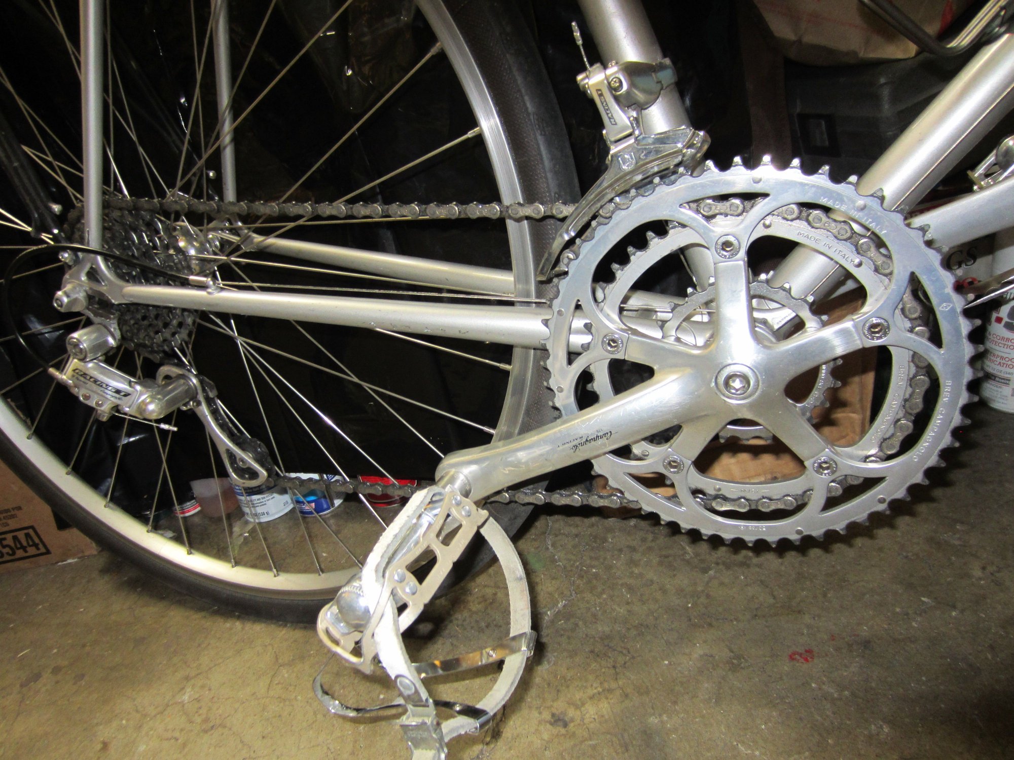

Here is the crankset I plan to use.

That is a nice looking crankset by the way. We are going to need pictures and this comes together.

Those cranks will most likely be fine with whatever you choose. However, they are set up for half step now, which is a dumb idea with 8+ speeds. Probably half your gears will cancel out with the 4t spread. Use Sheldon's gear calculator.. I'd look for some chainrings with a more even spread for the middle and small, and set them up 28/40/50 or similar.

So I can just switch out the chainwheels at will? I thought that the only replacing of chainwheels was same for same when they wore out.???
Yeah, you can usually just switch out chainrings, as long as they are the same BCD (bolt circle diameter). https://www.sheldonbrown.com/cribsheet-bcd.html
Unfortunately, it looks like the Takagi have a slightly oddball inner BCD of 75, same as old old deore. You could still put in a more normal size middle like a 40T, as it looks like the common 110 size. Measure first.
That still gets you to 32/32, or one to one gearing. That would be plenty for me except for maybe mountain fire trails offroad. Depends. If you've got sketchy knees it may be worth looking around for a 110/74 crank that can take a 26 or something.

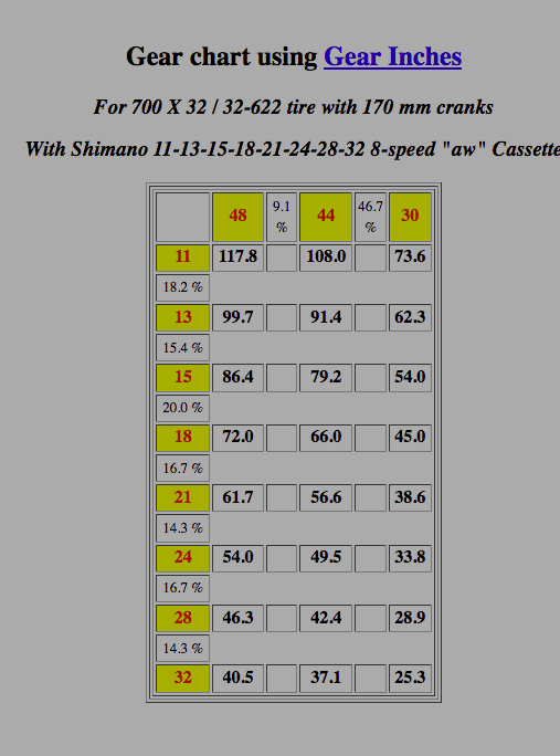

Here's what I needed.

@merziac - the mother of bailout gears!

As the other poster who thinks that it's dumb , here's why. In the 5 speed days, it was a way to get reasonably close spaced gears where you did most of your riding, and still have maybe 3 bail out climbing gears that were more widely spaced. To me, they were a hassle because of needing to shift twice for every gear change. With 8+ cogs in the back, it just isn't necessary to get closely spaced gears in your main riding range. Add to that a surprising number of the later half speed set ups did in fact have poorly worked out gearing. I remember one factory touring bike (i'm not going to name names) circa about 1989 that managed to get like 6 different gears out of a 3x7 triple setup. The rest were duplicates.
That said, a well thought out half step can be effective. The main problem when you get into higher number rear cassettes, is that you don't have a lot of choices in the main riding range, which I consider to be 65-70 gear inches or so. With a standard set up, you can have a bit over overlap here and get maybe 4 gears near 70 in. That way you're not riding in one gear all the time.
Obviously, these are just my opinions, and we all know what opinions are like. A few people I used to ride and whose opinions I respect with preferred half step. Works for some people. Maybe I just don't like shifting.
Anyway, FWIW, I ran the OP's numbers in Sheldon's handy dandy calc, using both cranks and a std shimano 11-32 8 spd. They are both in fact pretty good half step set ups as is. I'd be inclined to bolt one on and go.
Takagi:
SR:
Salamandrine is offline
