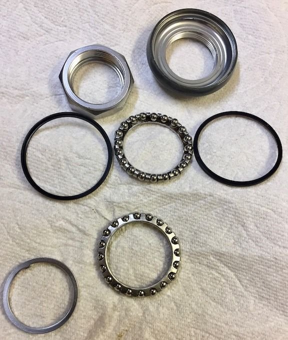

OK - an update. I picked up a gallon of Simple Green Pro Heavy Duty (purple color) and dropped the headset of my 1987 Centurion Ironman (Miami Vice) into a Ziploc bag as suggested. Because the headset was caked with hardened grease, I did a bit of scraping and cleaning before hand. I used a 3/1 solution (water/SG), set the unit to 150 degrees for 30 minutes, and let it ride. Worked really well - totally cleaned the headset, and the machine stayed clean and grime-free. The parts are cleaner than I could have gotten them by hand. Thanks for the suggestions everyone!
