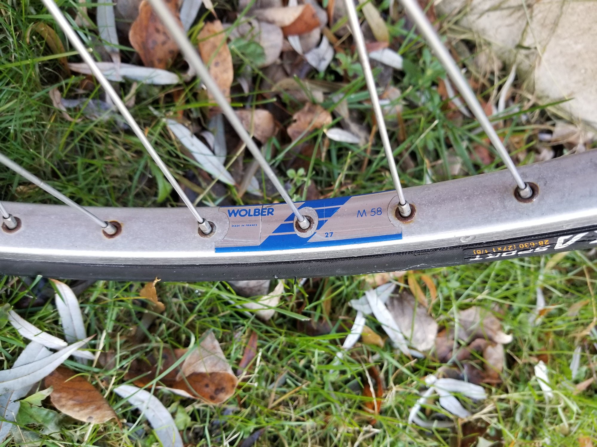

After a few near misses we picked up our 1st road tandem through the local craigslist. It was a pretty beat up 1991 model, but the bones looked solid. Already have two older Cannondales and love the light oversized aluminum.
Wish I had the before pics, but for short change on Amazon I upgraded the pedals, seats, added drops to the rear and new tape to the bars. Ton of scrapes and paint missing but the beauty of gloss black is you can do easy repairs with primer and spray paint.
This thing is a tank, 48 spoke bombproof rims with Phil Woods hubs. 6 speed freewheel and bar shifters that I am still getting used to. I'm a folder rider and this gearing makes climbing hills a breeze.
Enjoying some adjustment rides with the wife and excited to have another tool for the road.

That's a nice frame. Actually, before I "met" the frame for our titane lady I was sometimes thinking about this Canondale frame as a good and solid base to build up a tandem bike for us. Optically, it always looked like a 'standard' for a reliable bike waiting for many more miles. Plus, I always liked the diagonal extra tube that's often omitted in modern tandem frames. Okay, I should probably say "replaced by other technical measures" like even bigger tube diameters, what's surely working well in most cases. Just liked it personally...
I would even think about stripping/repainting.
Looking at the rims, I have two thoughts. They might be bullet proof, but the rusty eyelets would get a little on my nerves. On the other hand, I do not see an economically acceptable way to improve that. And what makes me thinking even more is the wear of the flanges of the rims. When I interpret the pictures right, the flanges show remarkable traces of grinding by hard/abrasive brake pads. Are there any wear indicators to check whether there is still enough "meat" for another good period of usage? If not, I would think about new rims. Since I've seen the 'exploded' rims of a friend of mine, this impressive picture stays with me... Don't want to experience that on a tandem...
I gave the rims a good examination. The surface has some markings but nothing compromising. I also noticed that the eyelet rust is concentrated in one segment of the rim, so I am thinking that they were outside for a bit. We will be using this in coastal New England so hills are minor (rarely more than 500 feet), there is a thread for a drum brake but based on the few descents so far it would be overkill.

I would replace those rims
Really liking the pacing. She is usually 14mph solo, I'm 18, we have a solid 16mph baseline on the tandem, and that's in winter gear and temperatures. I just have to get her to stop jumping off the bike when I stop at an intersection. She says I'm leaning when I unclip.
We rode low profile rims like those for many years. All tandem riders did until deeper rims became available. Once we switched to deeper rims we stopped breaking spokes.
